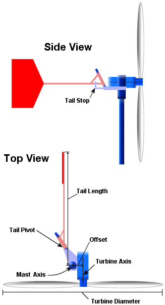

Automatic mechanical furling uses a clever combination of gravity and wind force. Below is a simplified diagram of a windmill. The Tail Pivot is just a simple hinge that is angled back and to one side, usually with an angle of about 20 degrees. Because the pivot is angled back from the vertical, the weight of the tail will want to turn the tail down. Its a bit like a fridge door, if you tilt you fridge towards you, the door will open because the fridge door hinge it angled off from the vertical. There is a tail stop to stop the tail once it is pointing straight out the back of the windmill, at 90 degrees to the turbine. The windmill turbine is offset to one side from the tower/mast axis, so if you push against the turbine, it will want to swing around the mast axis.
In operation, the force of the wind against the turbine will want to turn it around the mast axis, however the tail, which is sitting against the tail stop and at 90 degrees to the turbine face, will want to stay down wind, so it keeps the turbine facing the wind. But as the wind picks up, the force against the turbine face increases until it is high enough to lift the tail off the tail stop.

We can use some maths to calculate how a tail will furl, but first we need some measurements, and all measurements are in metric ( Conversion to imperial tables here ).
  • Turbine Diameter in meters
  • Turbine offset from the mast axis in meters
  • Tail tip weight in kg
  • Tail length in meters
  • Wind Speed in meters per second

First we need to work out how much torque is trying to turn the windmill around the mast axis.
The turbine thrust or force can be worked out with -
Turbine Thrust = Diameter2 * WindSpeed2 / 24
Turbine Thrust = 2m2 * 20m2 / 24 = 66.6kg
The turbine moment ( torque ) is -
Turbine Moment ( kgM ) = Turbine Thrust x Turbine Offset
Say our turbine has a diameter of 2 meters, and we want it to start fuling in winds above 20 meters per second ( 72kmh ). Our mast offset is 0.1 meters ( 100mm ).
Turbine Moment = 66.6kg * 0.1m = 6.66kgM
So we need a tail moment of 6.66kgM to balance the turbine moment.
Tail Moment = Tail Length * Furl resistance
and
Furl resistance = Tail Weight * Sin ( Pivot angle in degrees) * Sin 45o
Furl resistance = 20Kg * Sin20o * Sin 45o = 4.83 Kg
then
Tail Length = Tail Moment / Furl resistance
Tail Length = 6.66KgM/ 4.83Kg = 1.378M
So for our windmill to start furling at 72kmh, it needs a tail pivot angle of 200, a tail lenght of 1.378m and weight of 20kg.
Calculations:
Turbine Moment = Turbine thrust x Turbine offset
Tail pivot angle = Sin-1 ( Turbine Moment / Tail Length / Sin 45o / Tail weight )
Tail Length = Turbine Moment / Tail Weight / Sin ( Pivot angle in degrees ) / Sin 45o
Tail Weight = Turbine Moment / Length of tail / Sin ( Pivot angle in degrees ) / Sin 45o
