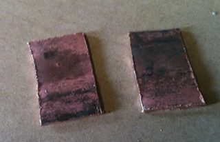

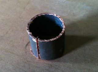

I used a short length of 1inch copper pipe, but any copper sheet will do, providing its thick enough, about 1mm in this case.
Flattened out and cut into two.

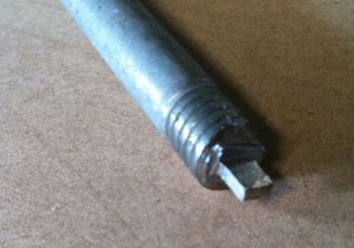

Next I made a punch from an old bolt. The punch is shaped to suit the Alegro legs. Using a hammer and piece of hardwood ( into the end grain ) made the job easy. Thanks to Pete for that tip.

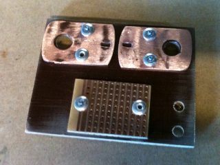

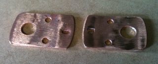

Next I drilled and shaped the copper plates like this, and sanded the copper so it was clean. To the right you can see the plates and a piece of veroboard riveted to some fibreboard. The fibreboard is perfect for this sort of job, but any tough heat resistant material would do

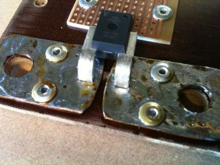

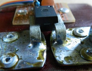

Then I tinned the copper plates, fitted the Alegro and soldered in place. For this sort of soldering, you need a big soldering iron, 100 watts or more, with a big tip.
The copper plate will tend to pull the heat away from a smaller iron tip, so the bigger the tip the better. It means you can make a nice solder joint in a few seconds, reducing the heat stress on the Alegro chip. I wouldn't attempt this with a smaller soldering iron.

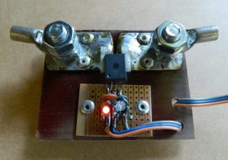

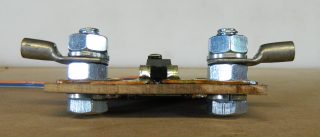

Here is a side view so you can see how the bolts are mounted. The spring washers under the fibreboard are a must.
After it cooled down, I mounted the other components. The LED is there for show, not needed.

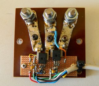

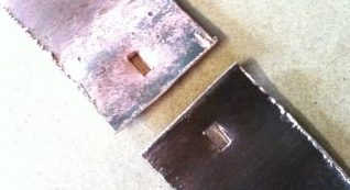

Here is another one I built using two unidirectional Alegro chips. This time I used copper bar, 10mm wide and 5mm thick approximately. I used a mill to machine the slots for the Alegro pins.
This one will be used to separately monitor amps into and out of a 50 volt battery bank. The blue heat shrink and orange wire is a battery voltage sense wire.
