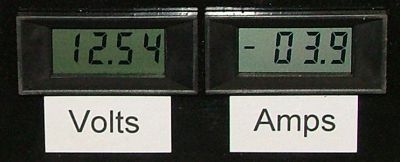

The meters above display the volts and amps of my battery bank.
First up I bought a couple of those cheap LCD panel meters from Dick Smith for about $12 each, though most electronic component outlets will carry then. The meters include a datasheet with details on changing the voltage range, and moving the decimal place. My meters were factory set to read 200mV full scale, but some come ready to measure 20V

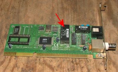

The old network cards, the ones with the BNC coax connector, have a 5 to 9 volt isolated inverter on the circuit board.
If you have one of these old network cards in the junk box, have a look for the model number on the inverter and do a google search.
This one is a PM7202, and I found a PDF datasheet to match.
As you can see, these inverters are tough little buggers, and built to last. So remember next time you throw away those old computer cards, check for any networkcards with the inverters on board. In fact there are lot of goodies on old computer cards and main boards, always have a close look before dumping.

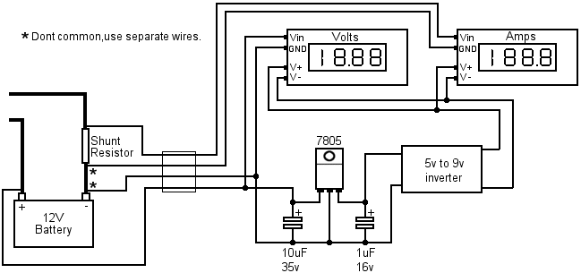

Now the inverter has a input voltage of 5 volts, so we need to add a 5 volt regulator, such as a LM7805, and a couple of filter caps. This, with out little inverter, will give us a isolated 9volt power supply for the meters.
Measuring our battery voltage is easy, we just connect the meter across the battery terminals. We need to set up our panel meter to read 20 volts full scale ( or 200 volts full scale if we are using a 24, 48 or higher voltage battery bank ), and this is done by changing a couple of resistors on the back of the panel meter. The instruction booklet that came with the meter should explain how this is done.

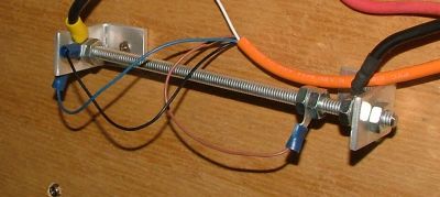

To measure current we need to use a Shunt Resistor. A shunt resistor is a low value resistor placed in series with the battery bank. And I mean LOW resistance, like 0.01 ohms. You could use a length of wire as a shunt resistor, but I used a length of 6mm ( 1/4 inch ) threaded rod. Using threaded rod means I can adjust the amp meter reading by moving the connections along the rod.
The two large black wires are the main battery cable, and they are bolted to each end of the threaded rod. The smaller black and brown wires lead off to the panel meter ( ignore the blue wire ). I can adjust the brown wire along the length of rod to calibrate my amp meter.
The rod shown is about 170mm long, and I found 120mm was the magic point to give a accurate reading on the panel meter. As my panel meter reads 0.2 volts full scale, and this shunt gives 0.001 volt per amp, then my meter can read up to 200 amps.
Ok, here's the complete circuit, you can click on the image to see full size. As my meters were mounted on the battery cabinet door, I used a length of 4 core cable between the meters and battery bank to make the installation easier and neater. Make sure you use a two separate wires for the shunt -ve and battery -ve terminals, as noted on the circuit diagram, or the amp meter will not display correctly ( there will be a phantom amp measurement of several amps if you try to use one wire as a common -ve ).
