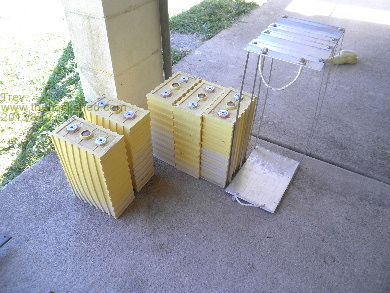

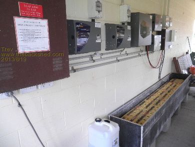

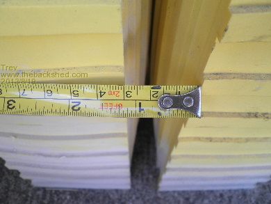

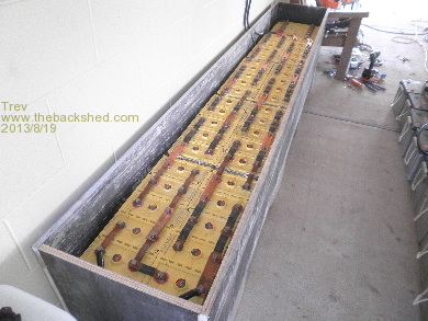

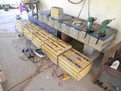

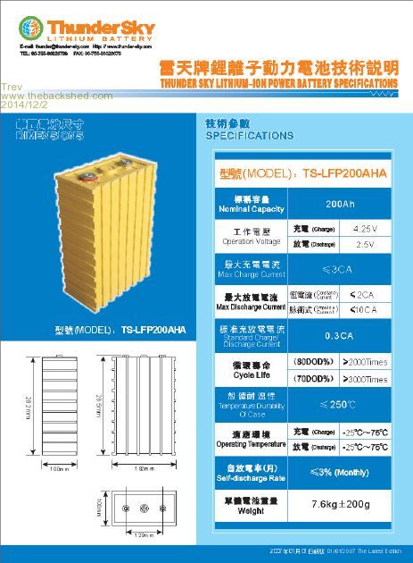

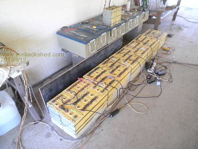

The lithium bateries that have run my EV Hilux
http://www.thebackshed.com/forum/forum_posts.asp?TID=5991&PN =1
are now running my house, sheds, health clinic, and feeding the excess power to the grid. I think it is great having a good set of batteries that don't really owe me anything, but still giving good service.
The old lead acid batteries are the ones I first started with in the EV Hilux. Originally started with 13 of them, but have sold a few over the years. Of these 8 left, one of them is no good now and another possibly no good, but the other 6 seem to be OK. They will all be taken to the scrap though.
Edited by Trev 2013-08-20
Trev @ drivebynature.com

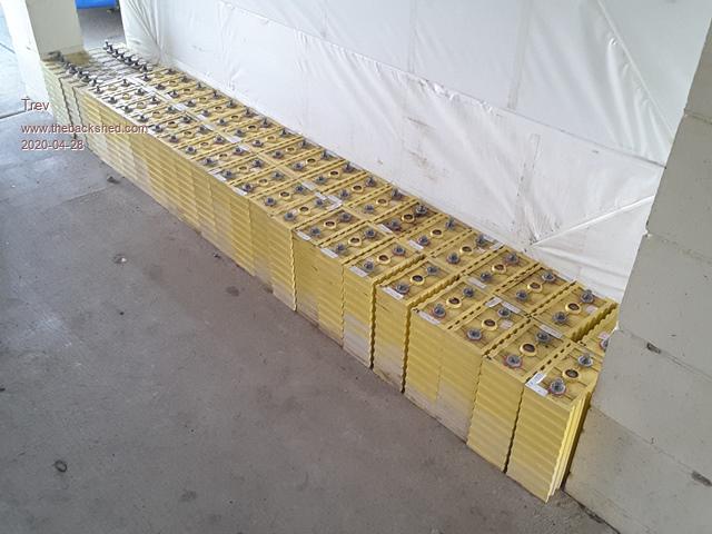

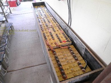

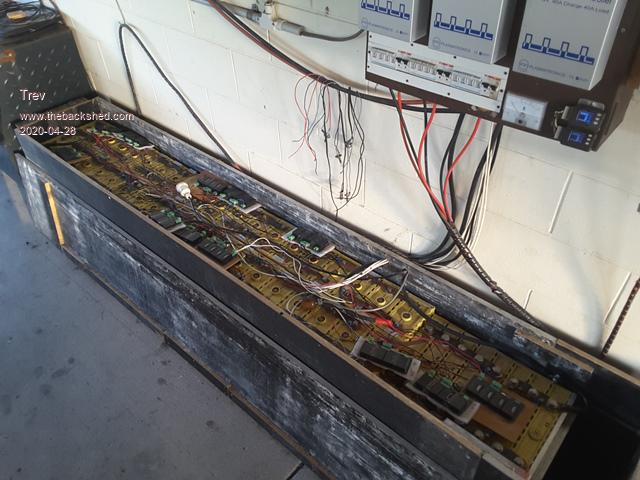

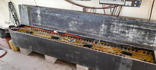

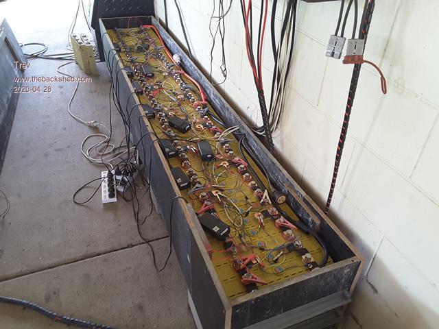

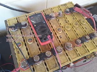

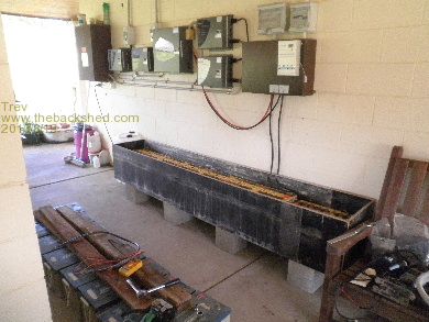

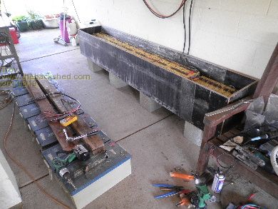

We have now removed the LFP Thundersky Winston lithium from our solar system.
Here is the pack as still functioning before stripping. We had a triple stack of Deligreen balancers to help control the voltage balance between cells.
And after removed...
So that leads to a history check. This forum is a great diary to record all the important stuff.
Don't get confused with this posting.....06 Apr 2008
The first pack bought for EV Hilux was sold but he wanted them tested before I sent them out. http://www.thebackshed.com/forum/ViewTopic.php?FID=15&TID=902 (hyper link not working, copy and past to check the reference)
The pack we are talking about (second pack) was fitted to EV Hilux 21 Aug 2008.
http://www.thebackshed.com/forum/ViewTopic.php?FID=15&TID=1127
And removed 25 June 2013 after doing 'Distance of original lithium pack is 437956 – 350153 = 87803 km. http://www.thebackshed.com/forum/ViewTopic.php?TID=5991
Then fitted to solar system (this thread, http://www.thebackshed.com/forum/ViewTopic.php?TID=6010 ) soon after but recorded 19 Aug 2013 and removed from service last week on 23 April 2020.
That makes 11 years and 8 months old.

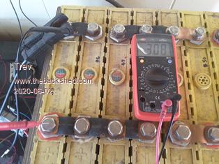

Cycle life of LFP is said to be 2000-3000 cycles. These were cycled almost everyday, some days twice in the day in EV Hilux and everyday on the solar. As a guestimate... 11.67 years x 365 days = 4259 cycles.
EV's are naturally hard on batteries, but I also pushed them in some ways. Got them hot (70C), put ice on them. Discharged very low very often. Sometimes over charged. On the solar we have the stand-alone inverter and 2 grid tie inverters. The grid inverters keep pumping power from the batteries down to around 80-90% out everyday. Pulling power through the stand-alone inverter never stops. The batteries are extremely low when the sun comes up. Most mornings cooked brekky still on the batteries, though some mornings we swapped back to grid to cook brekky, but then swapped back to batteries again. 12kW of solar has the potential of max charging rate of 240A. In EV Hilux discharge at full throttle is up to 1000A.
Never had to use a generator. When the grid goes down the grid inverters don't work so have plenty of power stored in the batteries. Once I did use EV Hilux to power the house. There was a cyclone coming and looking at the tracking, thought to have another day before it hit, so let the battery power out to the grid. The cyclone hit that night, so then I switched to EV Hilux batteries for power.
These LFP batteries as a pack at 48v still have around 80-90Ah, but we decided to retire them. They had around 300Ah as a 48v pack when fitted to the solar system. In EV Hilux they were all in series. If we did not have the grid inverters taking power from these batteries they would be good for a few more years yet. Ergon have been paying us over $2000 per year for exported power so it is worth updating the batteries to keep this export happening.

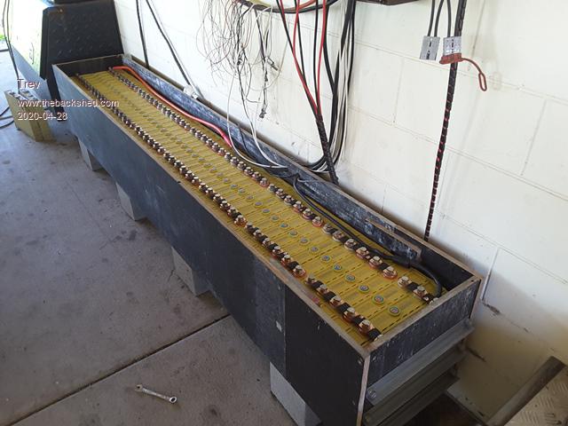

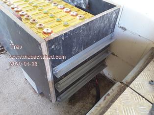

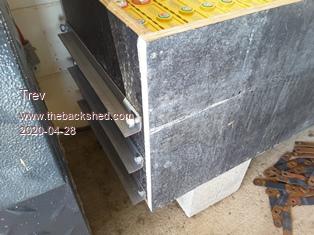

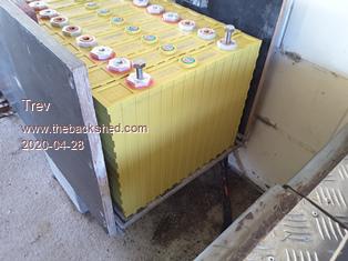

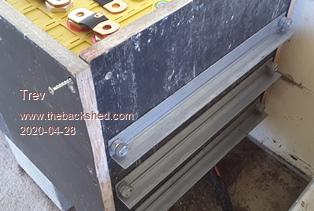

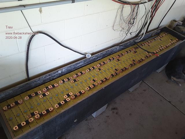

The new pack is 900Ah 48v Thundersky Winston LYP. 3 parallel of 300Ah cells x 16 cells in series.
The battery box is just big enough to house all 48 cells.
Used 3 rows of 10mm thread on each side and the ply box end with steel angle as strapping. The cells must be strapped to stop them cells swelling in normal use.
The second end of the box has no screws so can be moved as a clamp plate on the cells. Once the cells were clamp up, 1 screw was put in the top corners of the box sides to hold the box together.
Cells all connected up as normal and charge from solar until the first cells reach 3.6-3.7v. Then all series connections are removed. All cells are connected in parallel and charged with 11 x 3.7v chargers until all cells are the same voltage.
Then the parallel connections are removed and reconnected as normal (3P16S).
It is great to see the battery power still going out to the grid after midnight. This morning checked at 2.30am and power was still going out to the grid. And still plenty of stored power to cook breakfast. In fact I could go to the shed and use the welder or metal lathe, milling machine or compressor before sun up if I wanted (the old batteries run all these things). Plenty of power. We have also seen the batteries full up again by lunch time every day so far. One day was even cloudy but still full by 1pm.

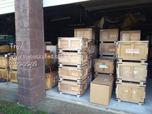

Yes I still sell them.
Quite a few thousand kg per year, I sell. The biggest year so far sold around 10,000kg. About 6000kg currently in stock.

going on from previous posts. I am also wondering if some other issue is stopping the posts as well. and i get tired from typing it all over agian.
I generally order between 3000kg to 4000kg at a time. the biggest order so far was a few years ago, around 6000kg in one hit. Thats a lot of money. I have to order a lot at a time to keep the price down. The current US AU exchange rate is very bad which make the cost in Australia much higher.
Cureent price for Thundersky Winston LYP is $1.86 per Ah.
Our new solar system battery.
48 cells x 300Ah x $1.86 = $26784
79 copper connectors x $5 = $395

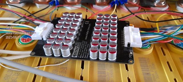

Plus strapping thread bar etc

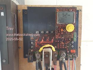

And initially, it will get 4 Deligreen balancers x $140 = $560. See how this goes. I had 12 balancers on the old pack. Thats a triple stack for 3 times the transfer rate.

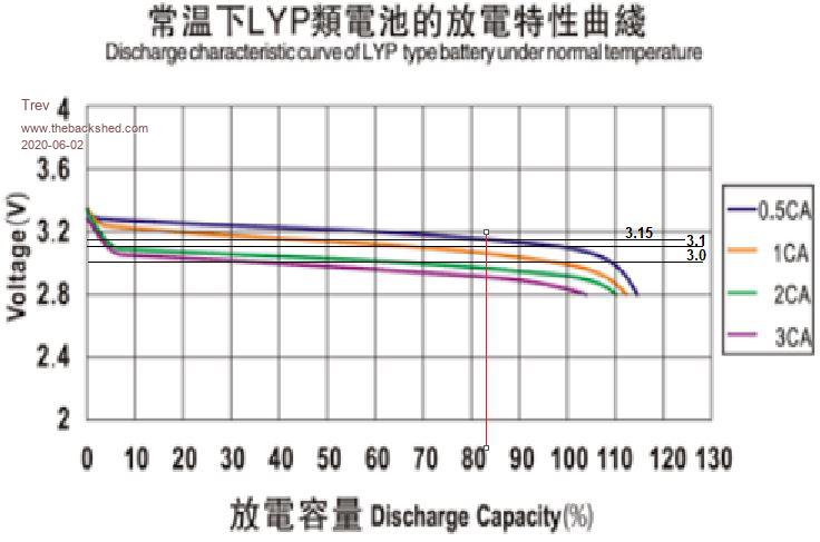

The LYP chemistry is the same as the LFP except it has the Yttrium added which increases the voltage stability and increases cycle life. The LYP is said to be 5000 to 7000 cycles compared to the LFP at 2000 to 3000 cycles. The battery pack in EV Hilux is LYP and are now 6 years and 8 months. The LFP were taken out of EV Hilux at 5 years but probably should have been 3 years. These LYP in EV Hilux were fitted when the old LFP were taken out. I am not expecting the full cycle life from the LYP in EV Hilux, EVs are hard on batteries compared to solar. Already at 6 years and 8 months is shown to be better. Plus I travel long distances, many times a year, with multiple cycles per day with this pack. A number of customers have reported after many years on solar, their LYP batteries are still performing like they were new.
The old batteries, LFP, are a giveaway if anyone interested. The LYP are still worth a small dollar, any offers. The LYP are not as old. http://www.thebackshed.com/forum/ViewTopic.php?TID=2790&P=3
I did inquire about recycling. One place, Envirostream Australia, said they recycle lithium batteries, but i had to pay them, and pay the freight to Victoria. Freight is not cheap either.

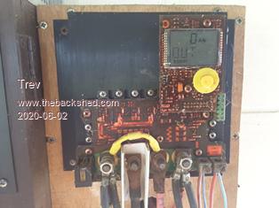

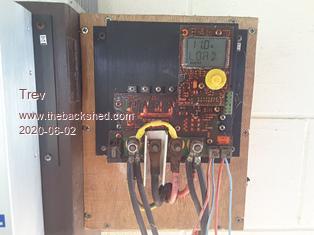

Old Seagull Man

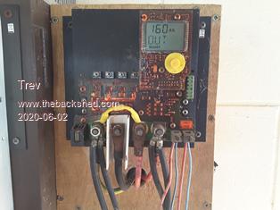

The PVE 1200 grid inverters require a 240vac on the output side to get them to switch on. You also need to swap some dip switches inside to make them run from a battery instead of running from a solar array. The PVE 1200 manual explains how to do this.
