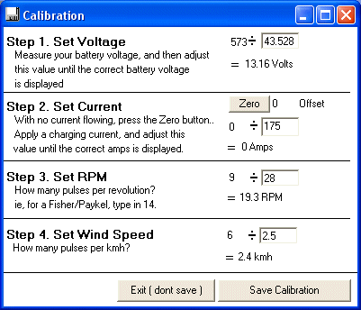

The calibration screen has been changed. I left the VoltOffset variable there so we could still use the software to record + and - amps. There are some hall sensor current sensors available that give us a voltage depending on amps. 0 amps = 2.5 volts, so a change in current up or down ( + or - ) gives us a voltage from the hall sensor that goes up or down from 2.5 volts. So the PC software will work with either a shunt resistor or a hall sensor. If you want to use a hall sensor, just omit the shunt resistor and connect the PicLog -ve to the battery -ve

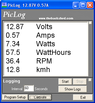

I've also added a Watt Hours reading to the main screen. This is set to zero on program start or at midnight, so it shows the total watt hours for the day.

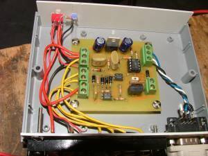

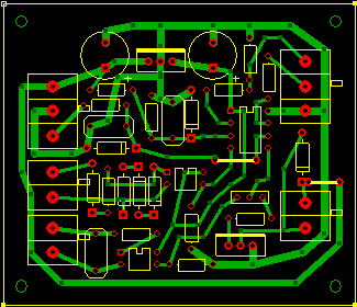

If you built the Ver 1.1 PicLog circuit board its a simple task to modify the circuit to suit the latest version, you only need to remove the pots and add a couple of jumpers and 1k resistor. For the latest version I designed a circuit board in Express PCB. Express PCB is a free PCB design program available from http://www.expresspcb.com/
