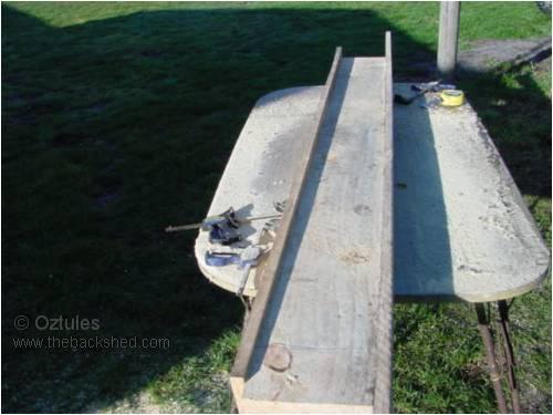

Here is the 20 minute jig I came up with. It uses the Dans 3 degree at the tip, 6 degree at the center and extrapolate to the sensible end of your timber size, and blade thickness= 1/8 blade width, and best line of fit from the tip to somewhere near the root.

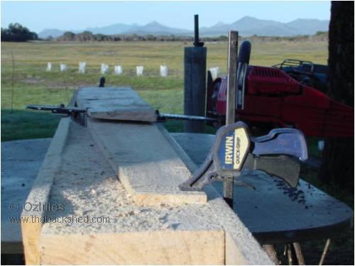

It consists of two pieces of 3x1 down either side of my 4th piece of 8x2 timber I had. It is 2M long.

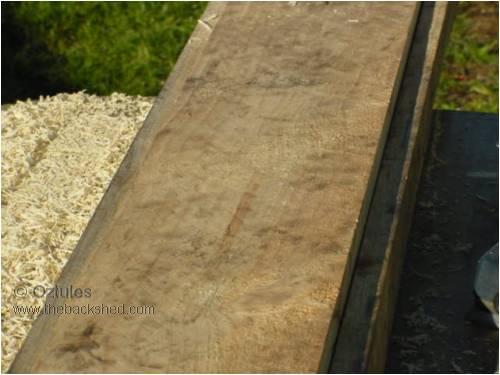

Here is a timber blank sitting in the jig ready for "processing" It needs to be held down while slitting obviously, and I used the clamps for this.

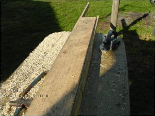

Here is a full view of it..... yes lots of pictures just in case anyone else is silly enough to try it.

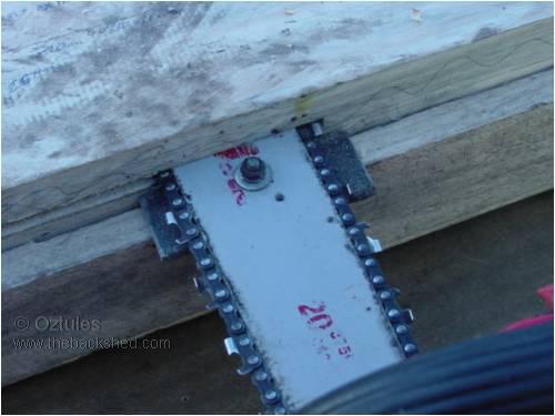

Well now I guess I must show how we get the chain saw to follow the jig we have set up.
It was solved simply (like all things I do) by just welding a few bits of steel 6mm strapping together to give me 12mm thick bits, boring holes through 2 parts of the blade bar, and installing the guides with some 6mm bolts. It looks like this:
and one for the other extremity like this:
It turned out that they allowed exactly 10mm clearance from the jig to the cut wood. The side pieces of timber were offset 10mm too low on either side from our actual line. This meant that when I cut along the jig, sliding along on the skids, I will be cutting 10mm above the jig line
Here are a few pics of how that looks:
Here we are part way through
