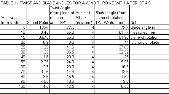

Tip Speed Ratio
- this is the ratio between the wind speed and the turbine blade tip speed, and is the starting point for designing the turbine itself. The optimum TSR band changes with the "solidity" of the turbine disc (i.e. how many blades it has).
When operating at its design TSR, maximum power can be extracted from the wind. As the actual TSR shifts above or below its design point, the available power decreases substantially. A turbine with a single blade (and a counter weight on the other side) might be designed for a TSR of 10 to 15. As you add blades, the optimum TSR decreases, and a 3 blade turbine will work most effectively with a TSR in a band between 4 to 7. The typical multi-blade farm "windmill" pump operates at a TSR of less than one. For a 3 blade turbine with a 2 metre diameter and a TSR of 4.5 in a 5 metre per second wind, the optimum tip speed would therefore be 5 X 4.5, or 22.5 metres per second. This translates to a turbine shaft speed of 215 rpm. For a 20 metre diameter turbine, the rotational speed would be only 21.5 RPM to maintain the same TSR. These low speeds do not suit most alternators or generators and, in the case of the 20 meter turbine, would certainly require stepping up by a gearbox.
Note also that, if the wind speed doubles, then the turbine speed must double to permit maximum power to be extracted.
Power in the wind and power extraction - As a rough rule of thumb, you would require an 8 metre diameter turbine to extract 1 kilowatt of power from a 5 metre per second wind (18 kph). This assumes that the turbine is 30% efficient. According to a Mr. Betz, you can actually only extract 60% of the wind energy anyway.
The power available in the wind varies as the cube of the wind speed (sorry Glenn, a point of disagreement here), and as the square of the turbine diameter. This means that, for even minor wind speed increases, there is an enormous increase in extractable energy. In most locations, though, wind speeds tend to be low, and the art with turbines focuses on extracting useful energy at the prevailing (usually low) wind speeds. Any small increase in wind speed can provide substantial power dividends so, within reason, the higher you can mount your wind turbine the better. Your local council and the neighbours may, however, not share your enthusiasm.
Blade Twist or Helix- There is a lot of science in efficient blade design, and I don't pretend great expertise. The principle of blade twist is, however, relatively simple. Air arriving at the leading edge of a turbine blade hits the blade with the speed of the wind in an axial direction, while the blade simultaneously hits the air at its circumferential speed. The circumferential speed depends on the radius of the point in question from the turbine axis, and is obviously fastest at the tip.
Considering the tip for the moment, if it is operating at its design TSR, then the air hitting the tip will do so at an angle to its rotational plane which is the angle who's cotangent is the TSR (see Figure 1). If the TSR is 4.5, then this angle is 12.5 degrees to the plane of rotation. At half the diameter, where the speed ratio is half, the angle is the cotangent of half the TSR (or, in this case, 23.9 degrees). The attached table gives the twist angles for various percentages of the radius of a three bladed turbine with a TSR of 4.5, but can be readily recalculated for other TSRs.
Note that the twist angle is not directly proportional to the radius, but follows the cotangent function. The rate of twist increases closer to the turbine axis.

Angle of Attack. The angle between the incident air and the aerofoil chord (line between the leading and trailing edges) is called the Angle of Attack. As a rule of thumb, the highest lift is developed at an angle of attack of about 10 to 12 degrees to the incident air. The point of stall, where the air flow detatches from the lifting side and the lift collapses, occurs at an angle of about 16 degrees. The AA that provides the highest Lift to Drag ratio is the angle of most interest to aeroplane designers, and occurs somewhere between 0 to 4 degrees, depending upon the aerofoil selected.
Wind turbine designers are primarily interested only in the component of the lift that provides torque in the plane of rotation of the turbine, and may select a higher AA to get more lift. The component of lift acting in the same direction as the actual wind only serves to load up the support tower (see Figure 2), so turbine and aeroplane designers have different views on lift.
Turbine Blade Angle - For best efficiency, a turbine blade needs to be set at the twist angle minus the desired angle of attack (i.e. the blade angle - see Figure 1). Suggested blade angles for a percentage of blade radii for a typical three-blade turbine with a TSR of 4.5 are given in the Table 2. This is based on an arbitrarily selected AA of 4 degrees, but this can be the subject of some experimentation (in association with different aerofoils). The AA does not need to be constant for all of the blade length (nor does the aerofoil section), and this is a fertile area for the experimenter to research.
It is interesting to note that, if the blade was being designed as a propellor, the angle of attack would be added to the twist angle. This is because, for a propellor, the concave side of the aerofoil is on the opposite side to that for a turbine blade. Thus, while a propellor with something like the right tip blade angle might be pressed into service for a wind turbine, it is not really designed for this task, and will not extract wind power as efficiently (unless designed with an AA of zero).
It should be noted that some studies have shown that it is possible to achieve good wind turbine blade performance without twisting the inner part of the blade, due to a phenomenon described as "stall delay". What this means is that the inner portion of the blade has been found to be contributing useful torque, even though the angle of attack to the theoretical incident air exceeds 16 degrees. This is probably due to the more complex air flows associated turbine blades, which wing theory does not accommodate.
While an untwisted blade would be simpler to set out, it will certainly be less inclined to self-start (see below), and may not be worth the trade-off.
