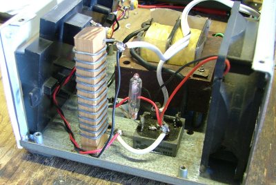

I have a 12v batter charger I put together many years ago from bits and pieces found in the junk box. Its been a good little light duty charger, but was lacking any form of battery monitoring, so I decided to give it an upgrade with a expanded scale volt meter and amp meter.
Its not pretty. The transformer and thermal cutout switch were saved from a dropped el-cheapo battery charger, the case is a old PC power supply with fan, and I added a bridge rectifier. Now I need to find a couple of meters.

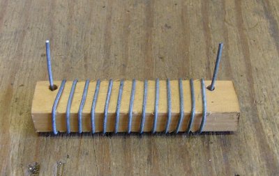

To measure the charging current I opted to use a simple shunt resistor. The charger was only good for 5 amps max, so I could use a home made shunt resistor made from some steel wire. The charger is fan cooled, so I didn't need to worry about heat generated by the shunt resistor. The circuit is fairly simple.
To make the shunt resistor, I used a 400mm long length of 1mm zinc coated steel wire. Steel wire is best, it has a higher resistance than copper, just what we need in a resistor.
Using croc clips, I connected the length of steel wire ( R1 ) in series with a dump load and a variable power supply. With VR1 set to to the middle of its range, I cranked up the power supply until I had 2 amps flowing. I then slid the croc clip down the wire until the meter was deflected by half. This gave me the length of wire for my shunt resistor. Trimpot VR1 can be used to make the final adjustment once the shunt resistor if made.
The steel wire was wound around a piece of timber. The timber length has a hole in its end for mounting upright.
Here's the shunt resistor fitted in place. The small glass tube to the right of the shunt resistor is the thermal cut out.
