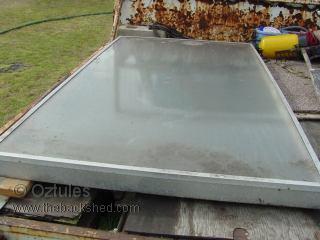

I pondered this for a while, and in the meantime, a plumber friend turned up with a few solar hot water panels..... also 25 or more years old..... they were stuffed..... but they did use tempered glass, and it was iron free glass.... and it was free glass ( this was the clincher).
So I sat and looked at a few 2 sq meter panels (1x2m).......... yep, had to have a go too.... but it cant be cut!

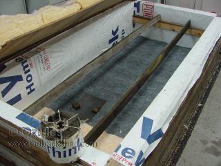

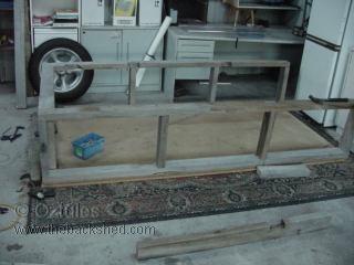

First step for me was a BIG oven.
An oven that would handle the 2 meter by one meter panes of glass that came from out of the solar water panels. (it turns out that for some quirk of history, there are plenty of these old solarhart type panels laying around over here).
We know that the temperatures involved are not terribly high in order to achieve the bonding and cross linking that is required to get the cells to be protected, and pressed against the glass without any bubbles..... so I started with a wooden construction..... yes for an oven.
I had recently pulled down a wool shed for a fellow, and I was given the wood.... lots of old 4x2 hardwood.... so this was to be the frame
It looks like this >>
I was also given some packing material in 8x4 foot sheets of low grade 3/4" pineboard.(someones kitchen apparently turned up in them). These would serve for the bottom and lid of the oven. For the sides I just used some of the old floor boards from the shearing stand.....

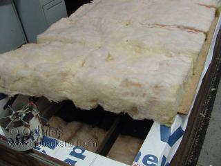

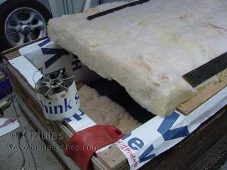

The whole thing is lined with ceiling roof bats insulation and then all held in the walls with a sheet of TYVEC building wrap material.... could be anything really.... even paper.

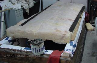

Ok, that gets us the oven walls and floor, and the lid was just a sheet of the 8x4 pineboard with insulation laying on the top.... Now we have an insulated container that will take our panel.
What this means to the 60watt panel builder.....is that even an insulated cardboard box will do for an oven (I used one with a fan heater blowing from in front for the initial trial, with blankets and dooners for the insulation...... perfectly good for a 60 watt panel)

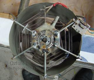

Next step is a heating element.
This was simply solved by destroying a fan heater/radiator. These things draw about 2000 watts and incorporate a fan and a nichrome heating coil. They spill out a fair stream of not too hot air, so are unlikely to melt our plastic bags (comes later) when we bring the oven up to temperature.

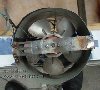

I built the heater body out of a "think safety" sign (ironic really), which housed the heating element at one end, and the fan motor at the other. The fan blades were plastic, and would melt in this environment (proximity to the glowing element), so I stole the aluminium blades from my big MIG welder, and put the plastic ones back in that.
This gives us a 2000w heater that blows warm air..... but not too hot,and will allow us to gently heat the oven up to about 100-120 degrees, without any cunning trickery required to temp control it. Because the oven is so well insulated...... we just keep adding watts from the heater until we get to where we want.
Finished it looks like this:
Perhaps finished was too strong a word to use...... but it does work.
