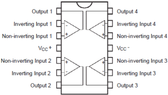

The circuit is based on the TL084 quad op amp. Other OpAmps could be used but this would mean a different veroboard layout and resistor values.

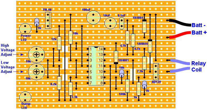

I designed the circuit with the help of CircuitMaker 2000, a circuit simulator. The veroboard was made with Paintshop Pro, and old favourite of mine.
Veroboard Layout.

Parts List
Semiconductors   Capacitors. ( Higher voltage can be substituted )
1 TL-084 Op Amp IC   1 100uf 35v electrolytic
1 78L08 voltage reg ( or a LM7808 will do )   1 10uf x 16v electrolytic
2 1N4004 diode   1 0.1 cap Green cap or similar
1 1N4001 diode ( or an extra IN4004 will do )
2 LED's colour of your choice   Resistors ( all 1/4 watt or higher )
1 BD139 transistor.   1 12k
      3 1k
Micalenous   2 10k
  Relay with contacts capable of switching your dump load current.   1 3.3k
  IC Socket, Terminal strip, Veroboard, Case, Etc   1 8.2k
      1 100k
      2 4.7k
      1 2.2k
      2 10k trimpots ( use multi-turn trimpots if you can )

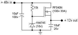

Adding a pre-regulator.
What about higher voltages, like 32 or 48 volts? The 7805 voltage regulator wont handle voltages much over 30 volts, so we need to add a pre-regulator if we want to use voltages over 30 volts on our controller. The circuit shown to the right will regulate higher voltages down to a voltage that's safe to feed into the charge controller. Any N channel power MOSFET will work, so long as its rated voltage is higher than the supply voltage. Choose a zener voltage between 16 and 28 volts, depending on your relays coil voltage, the MOSFET has a gate threshold voltage around 3 to 4 volts, so we subtract this from our zener voltage to get the output voltage. eg, a 16 volt zener will give us a 12v to 13v output, a 28 volt zener will give us about 24 volts. For R1 a 10k to 20k resistor should work, we want to pass a few milliamps throught the zener to keep it regulating. C1 and C2 are to filter the supply voltage and stop any unexepected oscillating on the output. 10uF should be enough.
An example of a 48v to 12v regulator.
The MOSFET will need a heatsink. The MOSFET in this example is dropping 36 volts. If we are passing 1 amp, then thats 36 watts ( volts x amps ) the MOSFET needs to dissipate. 36 watts is a lot of power for the small metal tab on the MOSFET to radiate, and without a heatsink attached it would burn out within a few seconds.
On the controller circuit, R1 will need to be connected to the input of this pre-regulator. Also R1 would need to be about 27k for 32 volts and 39k for 48 volts.
Note: I havn't tested these changes, some experimentation may be needed.
