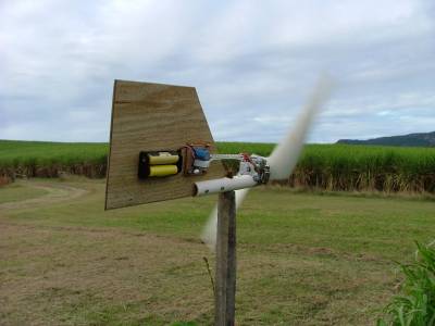

Building your own windmill requires no special abilities or equipment, all you need are some basic handyman skills, a few tools, and the time to assemble and experiment.
This little windmill is called the Mini-Mill, and uses parts from a junked printer or photocopier.
You can find the instructions for this popular project here.

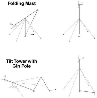

An effective windmill needs clean air, that is a breeze with no obstacles. Obstacles can include trees, buildings and even the contour of the land. As a rule, the higher the better, but be practical while a 20 meter mast would be ideal, you need to get the windmill up there, and may need to bring it down for maintenance. 5 meters above the nearest obstacle is a good start. Do not mount the windmill on the roof of your house! Windmills produce some vibration, and while this is almost inaudible, the vibration will travel down the mast and into the surrounding ground. If you were to mount it on a roof the vibration would be VERY audible.
Also consider safety. Things can go wrong, blades can come off, towers can fall down. So please be locate the windmill in a people free area.
My personal preference for tower design is a 7 meter tall folding tower made from 75mm od 6mm wall galvanized pipe. The tower is supported by eight 5mm stainless steel guy wires, each connected to a steel post embedded in a 700mm deep hole filled with concrete. You may need to talk to your local council before erecting a windmill tower, and they may require a structural engineers plans before proceeding. There is nothing more worrying that watching your windmill buck around in a violent storm, and nothing more rewarding than having it survive with no damage.
