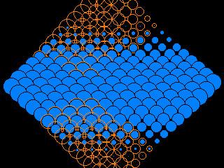

Bubbler
Type Bubble
 x As INTEGER
 y As INTEGER
 r As INTEGER
 c As INTEGER
 s As INTEGER
End Type
Dim b(30) As Bubble
Dim c(15)=(0,1,2,3,4,5,6,7,8,9,10,11,12,13,14,15)
Colour Map c(),c()
For i=1 To 30
 b(i).x=Int(Rnd*MM.HRES)
 b(i).y=MM.VRES+Int(Rnd*200)
 b(i).r=10+Int(Rnd*20)
 b(i).c=c(1+Int(Rnd*14))
 b(i).s=1+Int(Rnd*4)
Next
 For i=1 To 30
   Circle b(i).x, b(i).y, b(i).r,,,0,0
   b(i).y=b(i).y-b(i).s
   b(i).x=b(i).x+Int(Rnd*3)-1
   If b(i).y+b(i).r<0 Then
     b(i).y=MM.VRES+b(i).r
     b(i).s=1+Int(Rnd*4)
   EndIf
   Circle b(i).x, b(i).y, b(i).r,,,b(i).c
   Circle b(i).x-Int(b(i).r/3), b(i).y-Int(b(i).r/3), Int(b(i).r/5)
 Next
Loop While Inkey$=""

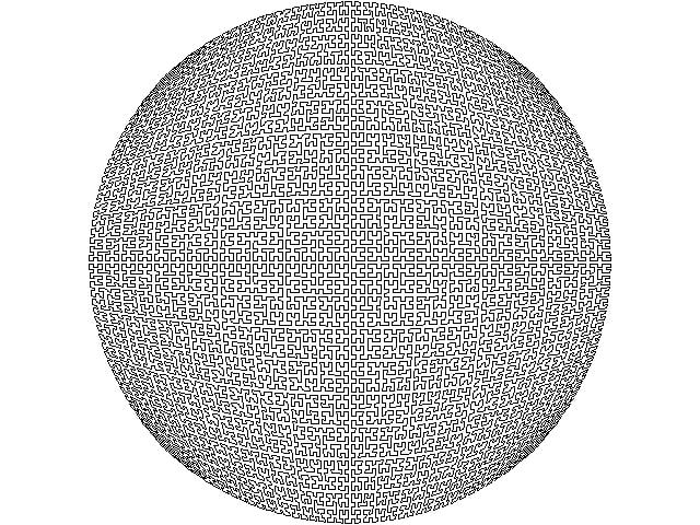

Sphere of Peano curves
PicoMite Turtle Graphics
MODE 1
CX=MM.HRES\2: CY=MM.VRES\2
Colour RGB(Yellow)
Turtle RESET
Turtle PEN UP
Turtle SET XY CX-CY*Sqr(1/2),CY-CY*Sqr(1/2)
Turtle PEN DOWN
PROCH -1,-1,2,0,0,2,7
Pause 5000
End
Sub PROCH(A,B,C,D,E,F,N)
 If N<=0 Then PROCL A+(C+D)/2,B+(E+F)/2: Exit Sub
 PROCH A,B,D/2,F/2,C/2,E/2,N-1
 PROCH A+C/2,B+E/2,C/2,E/2,D/2,F/2,N-1
 PROCH A+C/2+D/2,B+E/2+F/2,C/2,E/2,D/2,F/2,N-1
 PROCH A+C/2+D,B+E/2+F,-D/2,-F/2,-C/2,-E/2,N-1
End Sub
Sub PROCL(X,Y)
 Turtle SET XY CY*X*Sqr(1-Y*Y/2)+CX, CY*Y*Sqr(1-X*X/2)+CY
End Sub

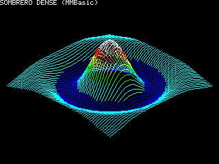

Sombrero
Sombrero coded with 'Lua'
MODE 2
' Offset and height constants
CX=MM.HRES\2
CY=MM.VRES\2
HEIGHT=60
A=MM.HRES/640
Print "SOMBRERO DENSE (MMBasic)"
N=0
' Basic loop on grid
For GX=-150 To  150 Step 5
HasPrev=0
For GY=-150 To 150 Step 5
 ' Calculating the radius
 R=Sqr(GX*GX+GY*GY)
 ' Calculating the Z height
 If R=0 Then Z=1.0 Else Z=Sin(R/20)/(R/20)
 ' Projection of 3D coordinates onto a 2D screen
 PX=Int((GX-GY)*A+CX)
 PY=Int((GX+GY)*(A/2)+CY-Z*HEIGHT)
 'Choose color based on Z height
 If Z<-0.1 Then
  COL=RGB(Blue)
 ElseIf Z<0.2 Then
  COL=RGB(Cyan)
 ElseIf Z<0.4 Then
  COL=RGB(Green)
 ElseIf Z<0.6 Then
  COL=RGB(Yellow)
 ElseIf Z<0.8 Then
  COL=RGB(Red)
 Else
  COL=RGB(White)
 EndIf
 ' Draw a line to the current point if there is a previous one
 If HasPrev=1 Then Line PrevPX,PrevPY,PX,PY,,COL
 ' Save current coordinates for the next step
 PrevPX=PX
 PrevPY=PY
 HasPrev=1
 Inc N
Next GY
Next GX

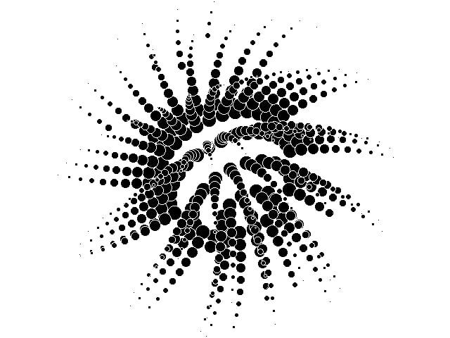

URCHIN
MODE 1
FRAMEBUFFER CREATE
FRAMEBUFFER WRITE F
CX=MM.HRES\2:CY=MM.VRES\2
Timer =0
t=Timer
CLS 1
For n=5 To 15
 r=n*16+16
 tr=t-n*50
 ra=tr/1234
 rb=tr/2345
 For a=0 To Pi Step .448785
   For b=0 To Pi*2 Step .8-.6*Sin(a)
     o=Sin(a)*Cos(b)
     k=Sin(a)*Sin(b)
     e=Cos(a)*Cos(ra)+k*Sin(ra)
     If Cos(a)*Sin(ra)-k*Cos(ra)<.05 Then
       x=(o*Cos(rb)+e*Sin(rb))*r+CX
       y=(e*Cos(rb)-o*Sin(rb))*r+CY
       rd=15-n
       Circle x,y,rd,,,,0
     EndIf
   Next b
 Next a
Next n
FRAMEBUFFER COPY F,N,B
Martin H.
Joined: 04/06/2022
Posts: 1485
Posted: 07:16pm 15 Jul 2026
  javavi said  URCHIN
Impressive, and with just a few minor tweaks it’ll run on MMB4W or CMM2 too.

MODE 2
FRAMEBUFFER CREATE
FRAMEBUFFER WRITE F
X0=MM.HRES\2
Y0=MM.VRES\2
CLS
t=Timer/64
S=Sin(t/79)
C=Cos(t/69)
z=Sin(t/99+1)*8+9
For V=-7 To 7
 For U=-7 To 7
  X=U*C-V*S
  Y=U*S+V*C
  sx=Sin(X/4+t/13)*8+4
  sy=Cos(Y/3+t/9)*8+4
  Circle X*z+X0,Y*z+Y0,sx,,,Map((t/16+z)Mod 16)
  Circle X*z+X0,Y*z+Y0,sy,,,0,Map(1+(t/16+z)Mod 15)
 Next
Next
