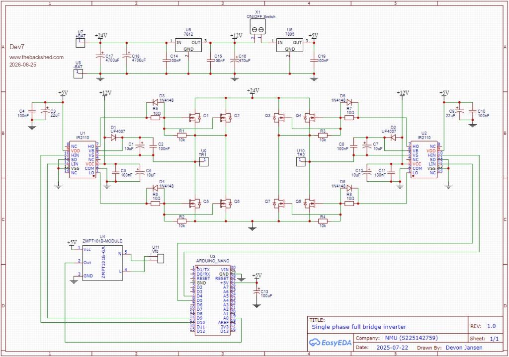

Hi all, I am in the process of building a 1kW 24V Inverter for learning purposes. The design is similar to the typical EGS002/EG8010 low frequency design. However, instead of using the EG8010 I have used an Arduino Nano. I did this because I wanted to be able to adjust aspects such as switching frequency and PID gains for learning purposes.
Does anybody have open source inverter code that attempts to replicate the EG8010? I have uploaded my current schematic and code. The main thing I am struggling with at the moment is voltage feedback/regulation using PID.

Dev there is a thread about doing what you seem to want to do, using Wiseguys boards and a nano'
have a look at this link
wiseguy inverter boards
good luck

Back to when member Poida started to post his code ideas on the Backshed: Experimental sinewave inverter designs
