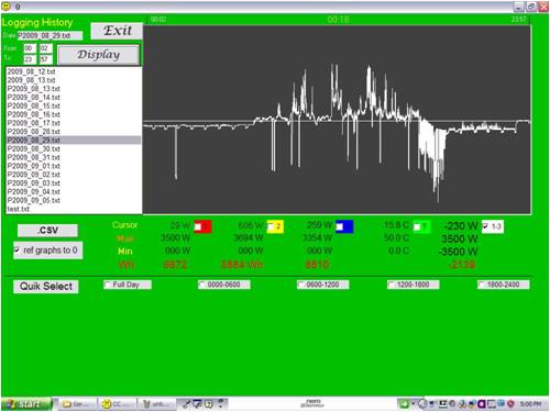

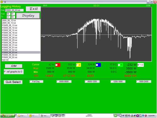

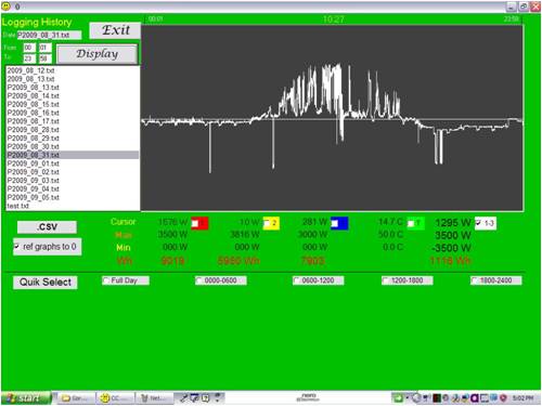

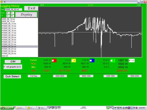

I have compiled a weeks logging of net energy use for an all electric home. This is warts and all data.
Above the horizontal line is NET Export, and below the line is NET Import. There are numbers in red that are the kWhr readings for the day.
First day is 29/08/09.
An interesting point is that on one day, the evening cooking session amounted to a maximum of 2.5kWhr. approx 50c.
on one day, the solar RE amounted to 14.9kWhr.
The effect of clouds on Solar RE harvest is quite clear as well.
The Base load of the house is approx 190W, and this is attributed to the 4 laptops that are logging data presently. In will be investigating an Intel Atom PC, for all logging soon. My intention is to allow real time viewing of all my data through the internet. Must talk to Gizmo!!
Most solar installs will be like this, with a fair proportion of Solar RE exported.
The hardware tools to get the data I presented are OFF the shelf, with my own modified software. These will work on any system up to 100A 240VAC, 3 sensors.
Gordon.
