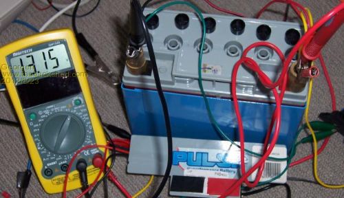

Georgen
Joined: 13/09/2011
Posts: 462
Posted: 12:58am 23 Aug 2012
This is exactly what I went through, with my 17Ah AGM
Started lifting up at the notch, cracked something and thought 'I think I broke it'
then I thought 'might as well keep lifting'
'Notch' Fragment taken from this picture:
George

Posted: 07:24pm 23 Aug 2012
  Georgen said   This is exactly what I went through, with my 17Ah AGM
Hi George
A couple of good pic's & it looks like you have a very good battery for the effort.
  Georgen said   then I thought 'might as well keep lifting'
And why not if in the end you are only going to take the battery to the scrap merchant you may as well have a look inside anyway to see how it ticks.
I shudder to think how many good batteries are thrown away simply because of this.
