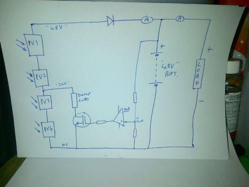

[Hi there! I once was told by a solar (PV) distributor that I could use a 24V charge controller on my 48V PV array by simply just by-passing two of the four PV modules.(Using a shunt regulator with a dump load).
Has anyone so far make use of this principle and with what results?

Why the heck would you waste potential power like that?
If you need 24v rewire the array to be 2 sets of 24v and put them in parallel.Edited by Privatteer 2013-06-03

Nope! I think I'll waste less power in the dump load due to the lower voltage handled by the dump load.
If you sense voltage at the battery and use this to control the dump load (across half the PV panels) the total charging voltage (++48V) will also drop.
My question is if anyone on this forum has used this method before and what results were obtained?
See the simplified illustration attached.
thanks

I have 4 x 310 W panels, Voc of each is 45.2V. They are connected 2 in parallel. Each is 8.5 Amp, therefore I am looking at 17A at (2 x 36.5V) = 73V loaded or 90.4V unloaded. (1.24Kwp). This is the reason I rather look at using a dump load controller to handle the power. MPPT at this power is quite expensive out here.

"They are connected 2 in parallel". Correction!:
I mean two in parallel connected in series with two more in parallel.

That is not what your schematic shows

Yip! "24V" panels. I shall get MPPT later, but for now I shall start with a home-made shunt regulator which in principle works as illustrated.
I have already used it on another series bank of 4 x 130Wp x 12V panels and it regulates perfectly. Only "problem" is the heat generated when batteries are full. (Not really a problem, because here, like in Oz, we now have winter, so dumping should be rare and can be put to other useful use!) Now I got 4 more (24V) panels of 310Wp each, but know that a lot more power might have to be "dumped" and therefore decided to only connect the dump load part of the regulator across half of the panels. The panels will be connected 2 x parallel then in series with the other two also in parallel.
Sorry for the confusion with my original schematic which shows 4 panels in series. This was just an example to show that by regulating part of the series bank, you actually regulate the whole bank.
I am just curious to know if anyone on this forum has tried this method before and what the results were.

What part of solar power dont people understand?
Solar is not required a dumpload like a windmill to control the power, you can simply disconnect solar from the system at will without the need to shunt the power to a dumpload, as one would with a windmill.
So why the need to disapate energy as heat just to control charging to a battery.
A MPPT takes the input voltage and converts it to amps at the selected output voltage.
But you can simply charge the battery till it reaches a upper limit and then switch off the solar input, it aint going to cause a solar panel runnaway like a windmill would.
Im just unsure what you intend to want to do.
Pete.

Thanks Pete,
Point taken. I shall then just use the controller(without the dump load) in series with my charging source ( the solar panels). I then only have to change the logic at the op-amp inputs too in order to turn the series transistor off, unlike turning it on in the shunt regulator when correct battery voltage is reached.

I have 4x220 watt series/parallel for 48v nom. My regulator just turns the solid state relay,(in line with the solar input), off, when the required battery voltage is reached, and on when the voltage drops a volt or so . Been doing this for a year ,no adverse effect has been noticed.
