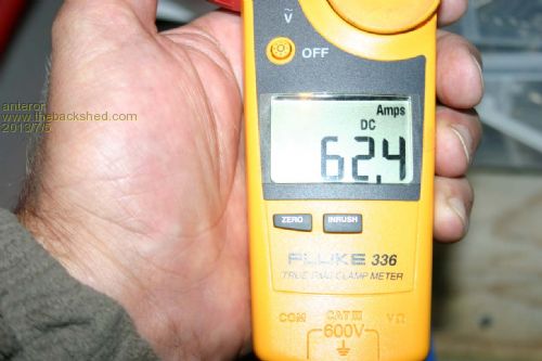

In Finland we do not have anykindof feed in tarif and we do not need any.
Here we need just warming and hot water(not cooling, as you know..)
So, we connect solar panels in series to get 200-600V.
You can connect power with this system to all existing systems,
water heaters, floor heating etc
With this relay, which is developed to solar power, you can
put so much power.. to control DC power, to any water heater to feed
floor heating etc
http://www.productselection.net/PDF/UK/rgc1d.pdf

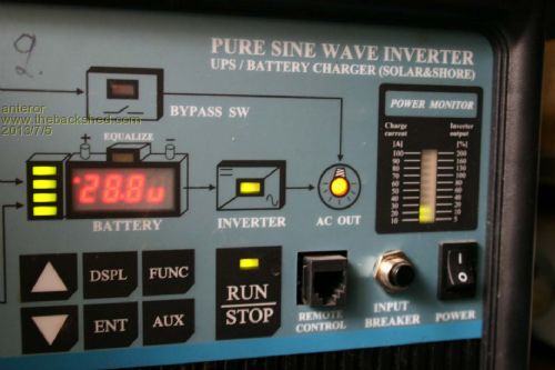

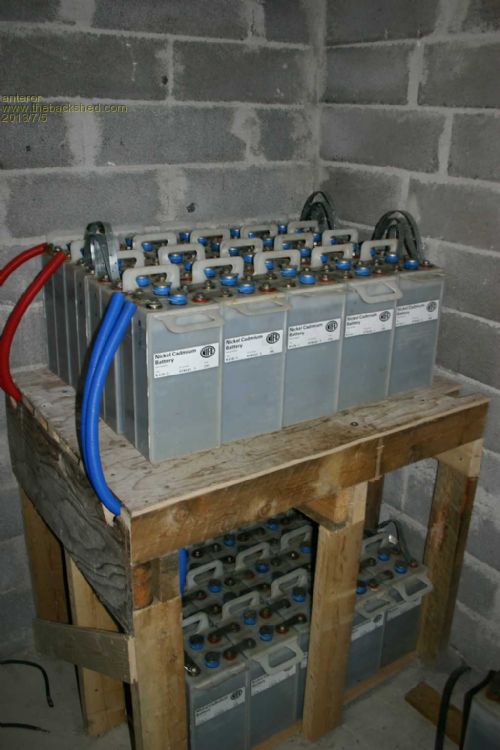

My systen with old ice braker NICAD batteries 2000Ah 24V;
My batteries, old ice braker ship batteries NICAD 2000Ah 24V.
My inverter, I have 2 of these Fraron 3kw and they have worked for
a long.. time for me !

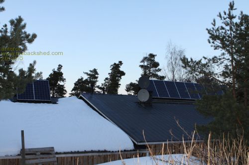

Antero,
Question on the first picture ... what is the right hand roof covered in? Or have you removed the snow from it? Or is there no insulation in it?
