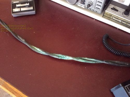

Posted: 10:34am 07 Oct 2014
I removed that suspect 16mm square cable from the duct --- Yep, Bob was correct,corrosion ...
Here's a pic ,will cut the sheathing to get a look at the copper corrosion.
Bruce

I sometimes see a corrosion problem with satellite cabling that you could probably relate to.
The cables are designed so that 18 volt DC can be injected into the outer braid to power the signal pickup (LNB). A parrot has a little nibble on the plastic sheath and the water is sucked in what seems like an impossibly tiny crack. Sometimes I have seen it fill the entire cable run with water and the DC power just eats everything away.
I am amazed at how far gone some of them are before the TV signal drops out and I get the emergency phone call.

The normal heating and cooling of the conductors in a humid environment causes the atmospheric moisture to condense and can be very corrosive when in a enclosed duct, I always found it better to lay cables above ground and exposed, as it ventilates and prevents the build up of the pure H2O in a confined space.
The only other way is to pressurize the conduit with an inert gas, not to easy in our applications.
