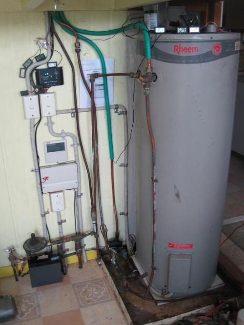

I relocated the little 30 litre unit into the repaired cupboard; wired the power to the “oven” circuit and we were back in water.
I sounded out any leads to old units stashed in back sheds and checked regularly at the scrappies, after some months I got a copper tank with coils in it.

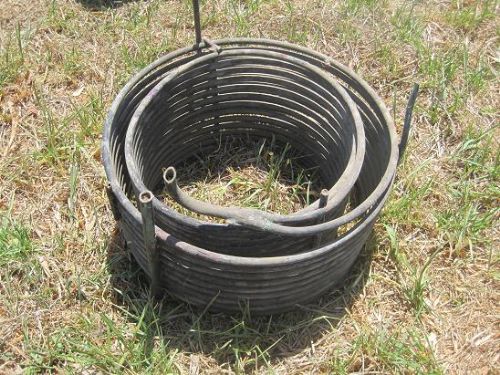

I t was heavy and rattled. I cut the top out and found 4 buckets of sediment which I had paid copper price for. I took the sediment back for a refund. Vacant looks and head shaking.
The copper tank leaked, the coils I put it away for later on.
9 months later led me to a back shed and a complete old REGAL type with the copper coils inside. FREE. I whipped that out of there so fast the dust and spiders were left behind.

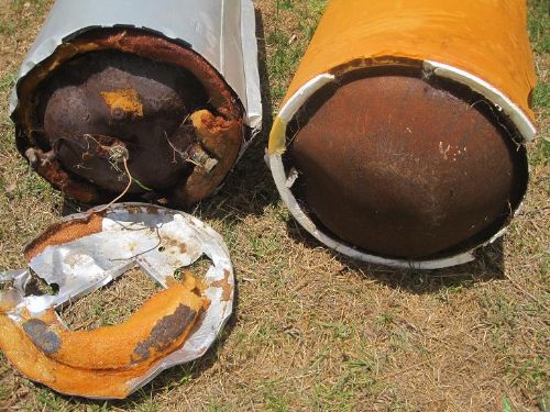

I dismantled the unit by cutting the rusted bottom out of the tin outer cover thus letting all the foam balls over the yard and removed the inner copper tank. Tested it for leaks.
I then unsoldered the ½ inch drain and replaced that with a 1 inch copper pipe. I silver soldered another 1 inch pipe on the other side about 2/3 of the way up, then soldered elbows to all the piping at the top going into the unit and fitted ½ inch copper piping down the side past the bottom, dismantled and silver soldered the 75 mm split in one solar panel tube.

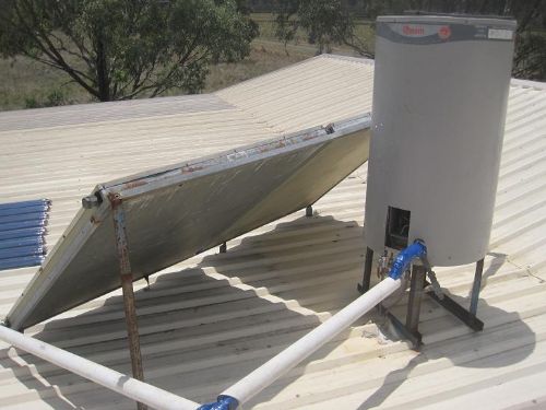

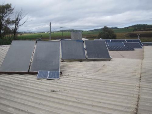

I made up a stand to suit the slope of the roof.
My wife and I skinned the electric hot water system that blew up.
I assembled the copper tank back into the outer cover, stuffing it with pink batts then fitted the skin from the old unit over the outside covering all the pipes, stuffing that with another layer of pink batts.
This makes a nice tidy looking unit up on the roof.

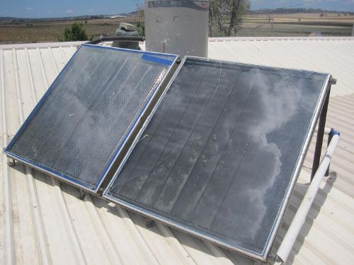

Connected up the panels, run it full of water, tightened a few drips and waited for the sun to do its thing.
The 1 inch circulation pipes are wrapped in layers of fibre glass matting, taped and covered with 2 inch pvc or poly pipe.
Looking Hot
A Rheem skin with a Regal tucked inside
WOW at 7pm a scalding shower and not a cent spent on electricity to heat the water.

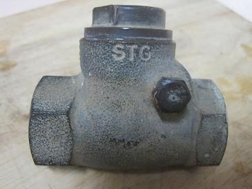

Next morning back to the roof, let the water go, I fitted a flappy one way valve in the bottom pipe by cutting a brass union in half, silver soldering each half to the cut pipe and screwed in the valve and waited.
1 pm and the water is boiling and crackling in the solar panels but the bottom pipe is cold.
My conclusion the circulation cannot open the non return valve. Let the water go again.
Pulling it to pieces I observed that the flap is attached by an offset type of hinge. I can hardly blow through it.
Experimenting with tilting it on an angle, I could get the flap weight neutralized.
I bent the pipes and refitted the valve.
Next day, Success, Scalding water by 3 pm and still quite hot at 10pm.

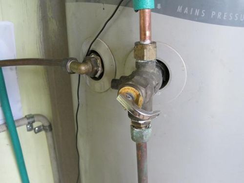

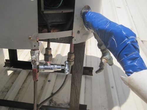

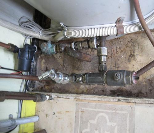

This the bottom end. The RED handle is the cold water inlet to the coil.
The chrome tap fills the tank. The ½ inch copper pipe union is the hot water delivery down to the house. The older brass tap is a drain, if I need it.
The over flow and vent are inside.
Inside the blue tape is the flappy one way valve tilted at an angle.
The band across the access cut out is the raised side of the old system top fitted as a collector tray to catch any leaks and run them off the roof over the back door (so I notice) and also stop any antifreeze ending up in my tanks. No precautions have been taken against a panel leak, however as there can never be any pressure in them I hope/pray I don’t get a leak.
I have left the electric element in to block the hole and maybe for a dump load.
I guessing the tank is about 100 liters capacity.

Up on the roof, finishing welding the mounts and adding extra screws to hold everything down.
I even put on the guy wires. Thanks Tinker

Picture description. From the Top.
Digital Temp readouts of the First system on the roof.
12 volt solar controller.
Left switch to frost heater in panels, Right switch to System Element (Night rate power)
Display
Hot water controller
Single switch for pressure pump under the house
Left Vertical tap is town water entry, then Pressure Regulator. Battery. Vertical tap is pressure pump entry. Next vertical tap is for when I get a high tank.
Down beside the system is the pump and valves.
The 120 liter hot water unit is fitted up in the cupboard where the big one was when it blew up.
I have a controller and the 15 watt recirculation pump with and old battery from my electric scooter and 2 by 20 watt solar panels.
When the hot water panels are 6 degrees hotter than the system the pump starts the circulation.
The pump runs for a while then shuts off again. This cycling continues on and off during the day until about 3 pm at this time of the year.
How it all comes together
The supply water now goes up to the first system and is pre heated then back down to the second system where it is heated some more.
Pre heated water enters via the chrome tap and into the system through a ½ inch pipe inside the ¾ inch tee, up into inside the tank 300 mm
The pump draws from the bottom of the system via the ¾ inch tee through a ball valve and a non return valve.
On right is the cold water inlet pressure safety valve ( The piece that was not there before – so no insurance)
The hot water from the panels returns to the system through this dual pressure/temperature safety valve.
The outlet (on left) connects the original house hot water plumbing.
I put this together in this complicated way instead of simple tees as I was concerned that if the pump was running and some one went for a shower, the cold water would be pumped through the panel faster than the draw off from the system resulting in “cold water”
In fact the controller would sense the cold water at the panel and shut the pump down.
I am hoping in winter the restrictions of the one way valve and the pump will prevent the cold water by passing the system. Time will tell.
I have recycled all old fittings I had on hand.
Summaries.
Over time I have learnt the best the first one can heat to is around 60C and about 30C on cloudy days with cold during rain.
I also believe it continues to thermosyphon late into the evening.
The hot water inlet from the solar panel is 1/3 of the way down the side of the re-circulation tank so even if the water above this point is quite hot the thermosyphon works below this and as the water in the lower part of the panel cools it pulls warm water out of the bottom of the tank which then warms up slightly, but enough to circulate and slowly cools the whole system until dark when the panel is all cold enough to stop.
If, I were to make another or had the inclination to alter this one I would –
Put the hot re-circulation inlet pipe close to the top,
Mount the whole tank so as the bottom is 300mm or more above the top of the panels.
The unit in the cupboard has gotten to 90 C and averages around 80 C
During some rain lately it was still in the 50s C
It has been altogether for a month.
How will it perform over winter?
The first unit has antifreeze in the tank and the second unit’s panels have a thermostat controlled 30watt 240volt element connected to the night rate, to stop them freezing.
I realized now the second units panels are made of steel not copper so I expect they will bust one day and I can do it all over again.
Costing;- around $350 in all.
My power bill has dropped the hot water night rate from around $200 to just 1 unit.
So I will cut it out in just TWO bills.

"I realized now the second units panels are made of steel not copper so I expect they will bust one day and I can do it all over again"
How I wish I had never said that.
I jinxed it!
One panel sprung a big leak over the weekend
So I am back to the Regal conversion I made until I get time to open up this panel for a looksee.
I suspect the plumbers damaged the internals when removing the panels as I had extreme difficulty undoing the cut off damaged pipes as I set it up.
As a point of interest the remaining water in the panels was crackling and blowing steam today.
I will drain them and cover them in the morning.

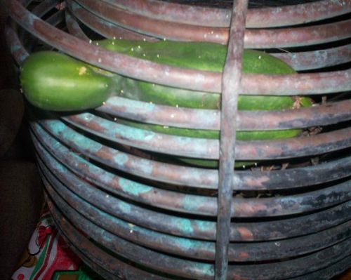

I simply had to put this photo up
Is this cucumber going to be in hot water or just a pickle?
