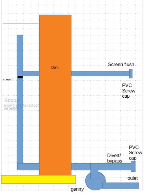

I set up several microhydro setups back when I was doing solar offgrid installs (the Rainbow Power ones, they were literally down the road from me back then) which were basically a modified car alternator (they made a pelton wheel drive for car alternators) that required very little head on a small stream- one I put in had a stream you could literally jump over, but it ran all year, a small dam about two foot high in a small gully was a piece of cake to build (we put in a fairly large pvc pipe that diverted the flow while we built the dam wall above it, it had a offset outlet that went to the pelton wheel, but flow to it and to let straight through was done simply by unscrewing the pvc 'cap' off
We made a neat 'self cleaning' screen to the pelton wheel with a pvc t piece that had a second pipe straight through the dam wall a bit higher than the outlet the screen was on the bottom of the tee that went to the wheel outlet- the advantage was that if your screen got blocked with leaves or whatever, by opening that top outlet, the water flowing through that pipe would 'suck' all the debris off the top of the screen and out through that pipe

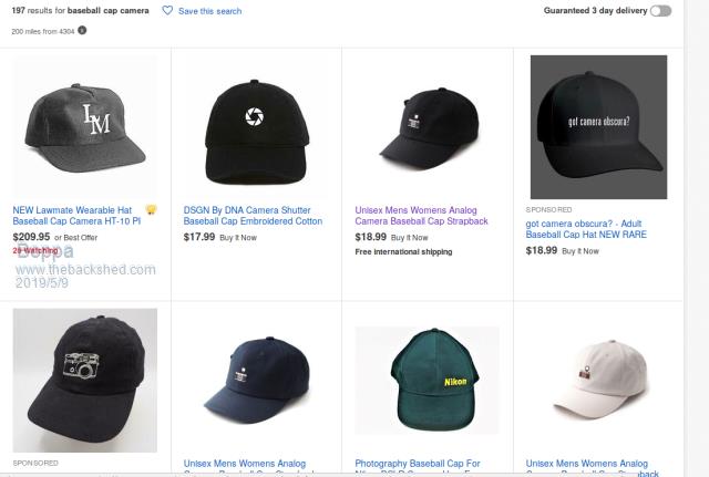

anyone know of a good head cam ? I wear glasses so can not really use the spy glasses unless I go contacts , and do not want to wear a helmet / bulky gopro .. just a small camera that can hook on head somehow or clips onto glass's

I bought one thats in a cap LOL (I used to wear it into work...isn't it grand having a boss who lies constantly...)
Same as these

ok new google baseball cap camera
thanks it will be a start at least been 20 yrs since I last wore one :P
