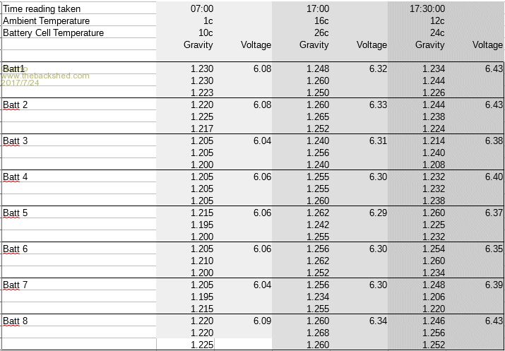

Posts: 5203
Posted: 09:58pm 23 Jul 2017
Nice find Yahoo, I looked everywhere for that data.
Figures today are sad. This is at the end of a sunny day, normal charging cycle.
There are 3 columns below, the first was taken at 7am a month ago. The 2nd was 5pm that afternoon. The 3rd was taken today. It appears they are getting worse.
Thoughts?
yahoo2
Joined: 05/04/2011
Posts: 1166
Posted: 05:18am 24 Jul 2017
in my opinion there is 14 cells that have acid concentrations that are 15% to 21% lower than where they should be. There is only five cells that are even close to reasonable specific gravity.
the h2so4 concentration should be close to 36.5% SG 1.2775
I can see a couple that are at 28%
I have never seen that much variation in new cells. They have either plated the sulphate out due to some sort of contamination or the cells were partially filled with acid and topped up with water.
I would not be persevering with them.

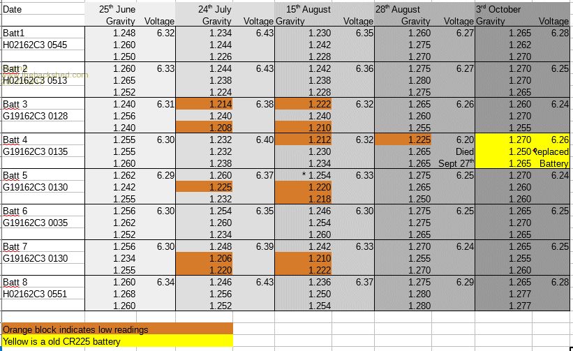

Posts: 5203
Posted: 01:03pm 17 Oct 2017
An update on the batteries.
I contacted the local supplier about my concerns, sent a copy of my logs, and was advised to "charge the batteries at 20 amps for 20 hours"!
Now I knew a constant 20 amps for 20 hours would effectively cook the battery bank and take years off its life, if not stuff them within days, so I didnt take the action and put the problem on hold for a few weeks, I had a business trip to Mackay I needed to prepare for and other more pressing problems.
On the morning I was to leave for the 11 hour drive to Mackay, I turned on the kettle, and the power tripped out. Walked down to the shed, and the inverter was beeping, and battery voltage was 44v, unloaded. No unusual load overnight, normal sunny day the day before. One battery was down to just under 4 volts, the others less than 6 volts. Seams like one cell died the day before and the rest of the bank didn't charge properly as a result.
I swapped the dead battery for a 6 year old spare, and waited around for an hour to make sure the bank was charging properly. I eventually left Toowoomba about 10:30am, got into Mackay about 9:30 that night.
Contacted the supplier, and was advised I still needed to do the 20 amps at 20 hours.
So I contacted the manufacturer, Crown, in the USA. I told them I was advised by the local supplier to charge at 20 amps for 20 hours, was this OK? They replied within a day, and the reply basically said 20 amps for 20 hours would be a bad idea, and then went into charging routines, etc, etc, it was very comprehensive. I replied to them with more of the bank history, serial numbers and my log files, below.
Crown got back to me and said they were going to replace the whole battery bank They even offered to deliver them, but I decided it would be better if I pick them up so I could test them before loading them into my car.
So hats off to Crown.
Now I have a quick question. The supplier has advised they have the new bank charged ( hopefully not at 20 amps for 20 hours ), and ready to be picked up. I wanted to check the voltages and gravity's before I load them into my car, its a 300km round trip and I dont want to get home and find one battery is way off spec. What would be a acceptable range of gravity's for a new bank of batteries?
