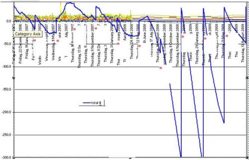

Hi Interested Forum Readers,
This is only related to S.Aust. Other states have yet to confirm a scheme.
I have posted a chart showing actual and predicted credits for a grid connected solar of now 2.4kW installed capacity. The data is from Nov 2006 until today and predicted to August 2009. The predicted is based on past monthly averages for the last couple of years.
The red asterix's indicate the quarterly billing time. The $ line is the result of the fixed qurterly fee plus an incremental daily credit/debit, that either deducts, or adds to this amount. We currently are in credit,[negative numbers], and this has been the last 2 year average. When the 44c/unit buyback comes into effect, the credit will increase significantly,[as indicated by the graph]. I have negotiated a payment to be made when the credit is above $100 in a billing period.
My household consumption consumes about 10% of my peak generating capacity. This will enable me to sell most of my power at the 44c/unit rate. The maximum benefit only occurs as I have reduced my total grid consumption. I was not prepared to sacrifice lifestyle though. Others may be able to achieve an even more favourable result with only a 1kW system. I have found that my windmill produces a more average, [over the whole day] output. This power is not really exported, but is consumed within my house by the base load. I am hoping that my second windmill will contribute more to the base load, so that nearly all of the solar can be exported.
The maximum benefit from the 44c/unit buyback rate will come from a system where the majority of power is exported compared to the base load of the house. There will of course be no 44c/unit benefit if the base load is the same as the max generated capacity. There is always a benefit overall by reducing demands on fossil fuel though.... Gordon.

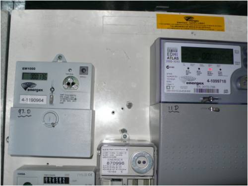

act anounced the other day they will go for 60c and thats great why dosen't qld follow their lead. fhill what does your meter looklike is it a digital one with lcd screen from my understanding they can be reprogramed to do whatever is needed. we only have ergon in north qld as others have not come this far north Mick.

They also replaced my main meter with a new flash digital one , it can be accessed by tele something , he was nearly going to install one as the solar metering as well at $500 a shot, as these meters can do both .. Anyway I hope a fair price and a fair way of metering is struck as soon as possible but for the elec authorities to have to go and retro fit a couple of thousand meters is big dollars , who is going to pay for that , not them !!!!

Fillm
Does the em1000 meter power in both directions or is one meter for imported power and one meter for exported power?
thanks
