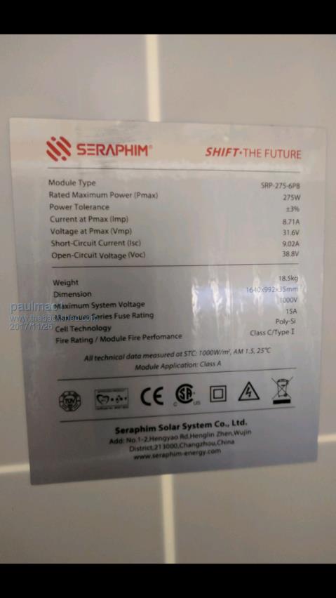

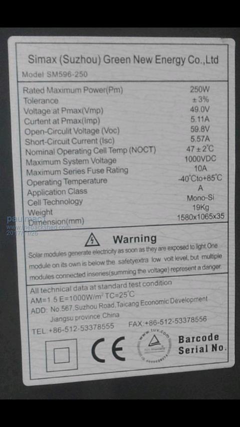

Hi all, I'm thinking of setting up a trial stand alone system for my shed.
Will these panels be to powerful for a 24v battery bank.

Unless you use an MPPT charge controller those panels won't give 250W as they will be limited to 5.57A which at 24V = 133W and at 28V = 156.

MPPT = Maximum Power Point Tracking which means it allows the voltage of the panels to rise to where the controller thinks it is receiving the most power. Then it steps that down to the battery voltage. Lots of info on the web about MPPT, be very careful if you are considering a cheap chinese one as many are fakes.
PWM controllers simply reduce current flow when needed to regulate the battery voltage.
Short circuit current is shown on the label as 5.75 amps and that is the most you will get whether it is 1 volt or 49 (@ 25 degrees panel temp). Multiply voltage by current and there is your watts.
If you connect those panels to 12 or 24 volt they will work but it will be a greatly reduced amount.

Those panels with maximum power at 31 volts are perfect to use with a PWM controller on a 24-volt system. On bulk charge, it will charge at 28V with a PWM controller so there is only a very small percentage difference to the theoretical maximum power.Edited by Madness 2017-11-27

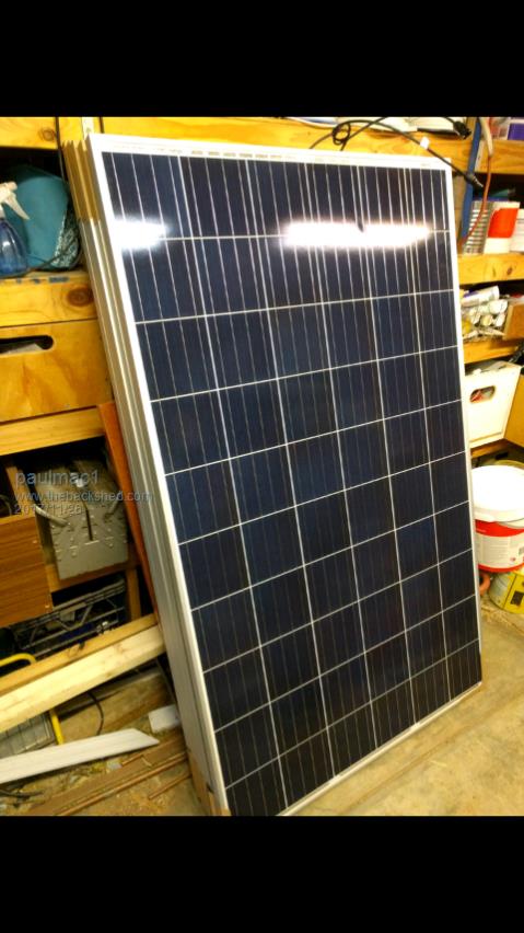

I'll be getting 5 of these panels, if they are still available when I get home (I work away) and 4x12v batteries, 100+ah. I know it won't eliminate my bill, but as more panels appear on the net forsale, i could expand the system.
They are poly panels tho, would I be better off buying dedicated 24v mono panels off fleabay? The seller wants $150 each, but will negotiate as a job lot.

Panels do sell for a lot less than that, $50 per panel is not unheard of. Nothing wrong with poly panels, I believe they are better in cloudy conditions anyway.
