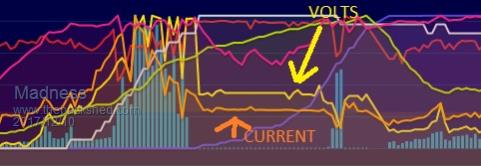

I have not seen a GTI that measures capacitance, the one I am using measure resistance to ground, if this is less than 1m ohm it will give a ground fault error. Adding capacitance take the panels from fixed current to near unlimited instantaneous current, best to not to this as having large amounts of energy available may overload the inverter. Every GTI I have seen has filtering on the input anyway. So far I have been running this for more than 6 months and have had no problems caused by the PWM, I have had the GTI fail due to a ground fault.
Here is what my battery current and voltage looks like with the regulated GTI operating. The graph is one complete day, the dips in volts and current are caused by clouds/heavy loads on the inverter. The light blue vertical bars are the power output of one of my Midnite charge controllers, it is not putting any power out when the battery is on float as the GTI is powering everything then.

What may not be obvious to most people, is that a sine wave inverter always draws a heavily pulsing current from its dc power source.
During the ac zero crossings, the inverter input power effectively falls to almost zero, and rises to a massive peak at each crest of each ac cycle.
If the power source is from a massive battery, that is not much of a problem.
But a solar panel is a VERY load sensitive current source.
As soon as you start drawing any significant current, the solar panel voltage falls away significantly.
There is absolutely no short term overload capacity from a bare solar panel.
All grid tie inverters will have large electrolytic capacitors fitted directly across the dc supply from the solar panels. Cost saving being what it is, these may be be made miserably small. There may be some worthwhile gains in adding extra capacitance externally between the solar panels and the grid tie inverter, although the point of diminishing returns applies.

The point is that there seems to be less than optimum capacitor size on the input and these already experience high ripple. I'd rater replace an external capacitor bank than tear a unit apart. You wouldn't put that little capacitance in a sine wave inverter you built. Higher efficiency might also be gained. The PWM input works because it takes advantage of the solar panels constant current nature, but it will add additional capacitor currents. If done from a stiff battery bank, these currents are much higher. It could be very easy to also blow the PWM FET in that case. In my situation all my arrays go into capacitor banks and devices feed off those. Besides an additional capacitor bank at the input here will be an additional diode and inductor forming a simple buck to reduce the surge current. Just a heads up for those with scopes to look at input ripple voltage. I'd be interested in what people see and if additional capacitance raised the power output.
Not everyone has great access to inductors and I've done some experimenting with UPS and microwave transformers used as inductors in a low frequency buck. Not great with a lot of iron core heating but workable with acceptable losses. The FREE part overrides those concerns. This approach would be preferable over straight PWM on an array buss that would feed some other devices by not dragging down the array voltage.
