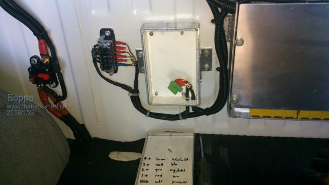

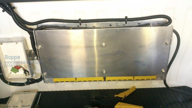

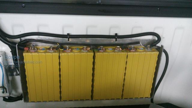

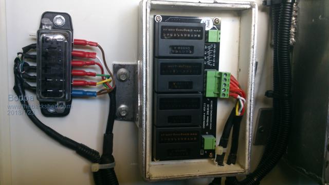

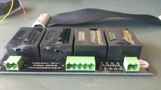

The Bms is a balancer- it simply keeps the cells equal in voltage eg say you have 3 cells @ 3.2v and the fourth is at 3.7, it will gradually balance them all out until they all end at say 3.4v- nice and equal- it isnt a charge controller and simply connects across each cell
The charge controller is separate and does a completely different job- both are required and do completely different jobs

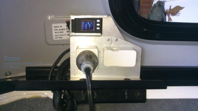

The 8 cell monitor is just that- a programmable (and very flash looking) voltage gauge- it requires a wire running back to each individual cell- note that those wires an individually deliver the full current from that cell!!!- I wired the utes ones up to a individual connection fuse box and fitted 300ma fuses and ran 5 core trailer wire to the monitor
fusebox and housing for balancer
batts and 5 core trailer cable to balancer and monitor
8 cell monitor and fridge outlet
Balancer and fusebox to monitor
Edited by Boppa 2018-01-25

I have the same 8 cell monitor and Balancer, what size wire did you run from the battery to the Fuse Box or was it the same 5 core trailer wire?
Is that a cartridge type fuse holder?
Do you have a heatsink attached to your battery balancer?

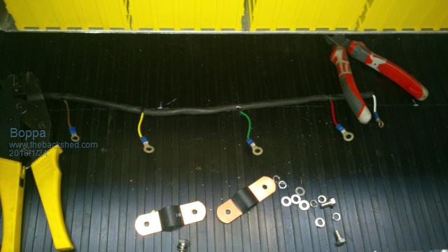

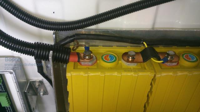

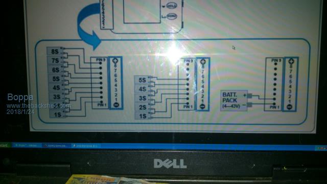

I started off using telephone cable (8 core) running from the monitor to the balancer with 5 core trailer from the balancer to the batteries but found the phone cable was too prone to fracture with vibration (this was multistrand, not solid- it tended to snap off at the crimps) so replaced the entire run with 5 core trailer wire- its double insulated and meant for car usage- and quite cheap per meter.
The fusebox was a 6 way independent fuse fusebox fitted with blade fuses- you need 5 fuses (one for each connection to a cell) I went for the lowest they had in stock at autobarn 500mA- One thing to watch out for is that some fuseboxes have all connections of one side joined together- ie positive would go here and individual circuits taken off each fuse on the other- this is NO GOOD!!!!- you need the one with individual connections on both sides- this is purely a safety thing as you have to run each cell connection from the battery box to the monitor and unless the monitor is in the battery box, it needs protection- as if any of these wires short out- they will deliver the full output of that cell to the short!!!
If you look at the pics- my 5 core goes batteries, to balancer (unfused- I am of 2 thoughts about whether it should be fused or not- I let the smaoke out of one due to incorrectly wiring it up-bat 1 is at the NEG end, unlike most truck multibats which normally start at the + end....- fuses probably would have saved it... but it also needs minimal voltage drop etc to work...) then to the fuse box, then to the monitor (which is mounted at the back of the ute body next to the fridge)
No heatsink is required for the balancer- it doesnt even get warm in operation, most of the time I doubt it is transferring current at all, its only there to equalise the battery voltages if they start getting out of wack
These arent charged by solar, but by the car alternator- I still set the monitor alarms to go off @ 3.7v per cell which is 14.8v- if it ever gets that high theres something wrong with the alternator! For solar most seem to be around 14.4 as their maximum point
I have the bottom end cutoff at 11.8v (2.95 per cell) thats above the minimum which is supposed to be 2.5 per cell (10v) but I dont feel that comfortable yet going that low, and I am still getting more actual run time at 11.8 on the 4x 60ahr cells than I was with 2x120ahr L/A batts- and they are a damn sight smaller and lighter!

making loom for balancer
5 core trailer cable to balancer/monitor
monitor wiring diagram (doesnt come with instructions and cd that came with it wouldnt read in my drive)
battery connections now marked so you dont do this....

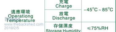

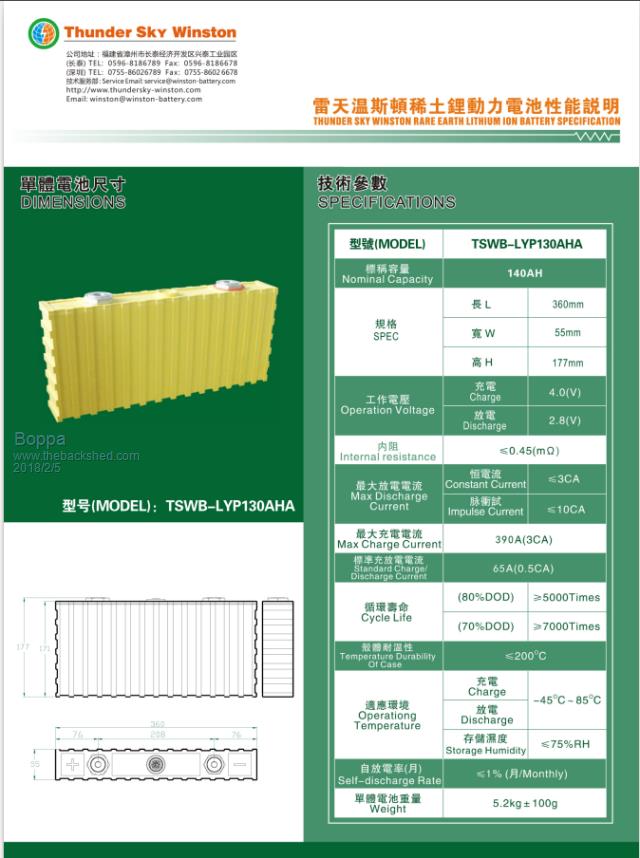

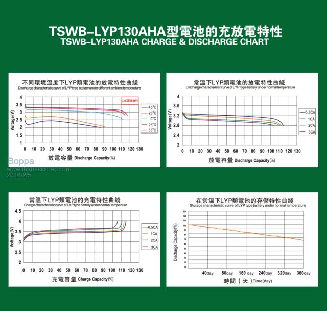

Yes, it is ... but it is just an ON/OFF controller designed to be used with 60 cell panels (24V) system. Or 12Volt systems (36 cells). His claim, which I believe to be correct, is that if the panel Vmp voltages are just above the battery voltage then MPPT is not going to be of much benefit.
HVD is set at 3.75V/cell and LVD 2.8V/cell (22.4V for 8 cells). Charging stops at 3.55V/cell. I have alarms that go off at 3.6V/cell and 3.12V/cell before HVD or LVD kick-in. If your charging does not terminate properly things could get out-of-hand quite quickly on a sunny day.
16V/4 cells is 4V. If you check the Winston data they do say 4V max, but looking at the graphs things are heading for destruction.
