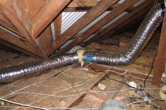

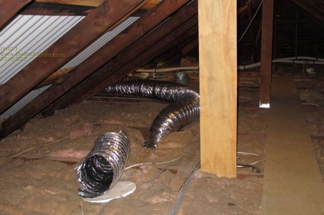

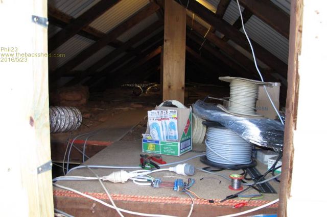

Say there's roughly 230m² of roof in plan view, the older original are is pitched at 35° over 4m wide rooms.
The newer additions are covered by a skillion roof, cavity tapering from about 900mm to basically rafter & batten height.
Pink bats circa 1996 in all areas.
There's a few more photos in this older post.
Few pics from that post....

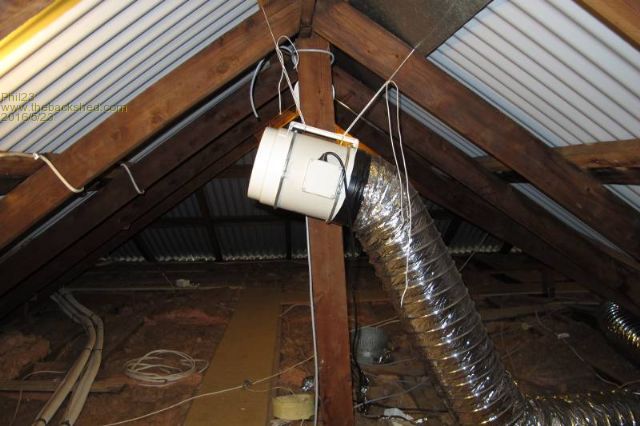

At the moment I just have the second duct fan sitting here on a platform, with 6m of 300mm ducting extending towards the front of the house.
The fan draws 105 Watts on high & displaces 840 cubic metres of air per hour.
The main living area, plus adjoining Office/Spare bedroom have a total volume for 215m³, so air turnover is about 4 times per hour.
Data is logged for all rooms, including a temp sensor that sits up near this fan.
With all that area & energy at 1000W/m², there's a huge heating source in comparison to the air flow I'm creating.

I like your anti vibration mounting of the fan Edited by Madness 2018-01-25
Phil23
Joined: 27/03/2016
Posts: 1667
Posted: 09:20pm 23 Jan 2018
  Madness said   I like your anti vibration mounting of the fan
Blind cord....
And fully adjustable for both height & angle,
just loosen the Reef knots....
(That's the Winter heating fan, obviously).

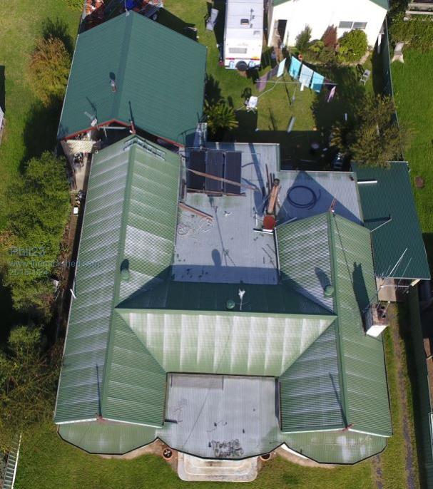

Might measure the actual wattage I'm using for extraction; it's all out of one point to a simple temp based controller; on above 22°C.
Found this Drone pic a friend took.
Interestingly it shows the shadowing I'll have getting into Winter.
Shot was taken at 1:45pm on May 10th.
Basically the house is facing NW, 323° bearing to be exact.
The 3 panels at the back are the water heating ones for the Spa that I've mentioned in other posts.
Agree with others about additional insulation under the iron. Was thinking foil backed blanket etc, but not sure about lifting the iron, be a mammoth task....
Don't you love how the ColorBond has weathered. Complete roof replaced in December 1996 after a hail storm. (Mostly Cricket Ball sized, but a few that were bigger).
Phil.

A really good way to determine shadows is with Google Sky maps on your phone. You can enter a date and time hold the phone up and see where the sun will at the time and date set. You also can play a day in fast forward and track the suns path across the sky.

Posted: 09:04am 24 Jan 2018
  Madness said   A really good way to determine shadows is with Google Sky maps on your phone. You can enter a date and time hold the phone up and see where the sun will at the time and date set. You also can play a day in fast forward and track the suns path across the sky.
Have to have a look.
I've always used Suncalc
either in my browser or with the app on my phone.
In the browser I can zoom on the satellite view & set a shadow height & watch it move about as I slide the time thingo.
