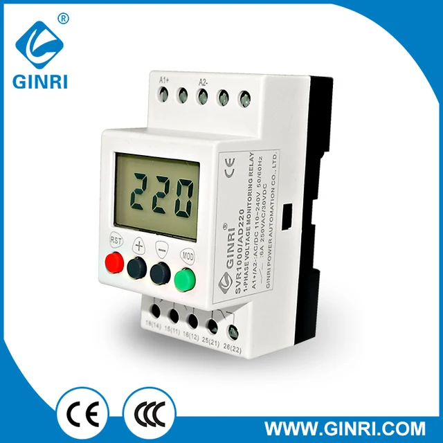

My idea is to use this increase in line voltage to signal there is solar generation and to use it to switch the HWS.
The component I plan to use is this:
A voltage monitoring Relay.
Once the solar starts backfeeding and increases the line voltage to the prescribed level ( yes, some tuning will be required) it switches in the HWS. The relays appear to have an on and off voltage hysterisis so the drop because of the load should be accountable for.
If a cloud comes over or output drops below threshold, the relay should kick out till the voltage comes back up again.
I plan to have the voltage monitor feeding a higher power relay which in turn will feed a PWM controller that goes to the heater element so I can control the amount of power I want to put in the heater.
As I will likley make up the control unit box with these components, breaker etc ( and anything else that may be suggested) I'm thinking of doing it as a plug in to an outlet near the heater. As my heater is 4.8Kw and the outlet isn't going to wear that ( nor will my solar generation input) I'll turn the PWM down to say 2000W.
On a cloudy day when there may be no solar generation to speak of and the cheapest power will be the .11C from the off peak, the heater won't get any boost through the day and will function as normal. When it's bright and sunny, the offpeak won't need to kick in or will just make up a bit for any shower taken in the evening.
No, it's not a perfect solution and I don't thank many are but it's cheap which means will pay for itself quickly, easy to just screw together for the electronically ignorant ( like me) and I think should work well for what it is.
This is a link to the voltage monitor I am planning to use: Voltage monitor

Can anyone see inherent problems with the Voltage monitoring relay?
Line voltage is pretty stable here in my observation and certainly doesn't climb to the level of when the inverters are back feeding.
As far as I can see, using the voltage rise to trigger a relay should satisfy pretty much all the parameters. Not looking to split the current between home and hot water, I can effectively do that with a PWM set to do 2KW or whatever. Just ordered a couple rated at 6KW so should do the job.
The solar miser is more than I want to pay just yet, unless till I try the cheaper option with the relays and see how that works and what features I may want and need in a more elaborate option.
The open energy monitor looks interesting and would certainly have a lot of learning value it it for me. Something I'll spend some time on and start getting my head around.
Unless anyone can point out some major flaws with the voltage monitor, I think I'll give it a go. Has to be a step up on a timer and seems the most simple, cheap and effective way of doing it I have seen so far.

Before committing to using the voltage switch which looks good for the price, i would do some simple tests. You may have already done so.
Rig up a simple switch to turn on the hw and watch the voltage changes with a meter as other loads or sun variations occur.
The device you have found has adjustable levels, hysteresis and time delay which is pretty impressive for the price so I would think you should be able to make it work.

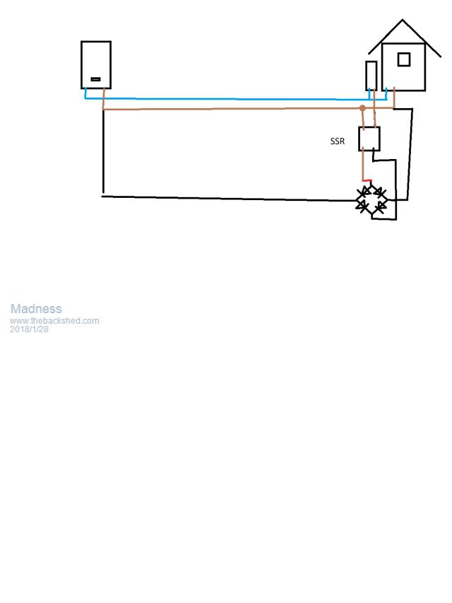

How about just having a rectifier connected to both ends of the AC active cable from the inverter that is further away from the house wiring. This will rectify the difference if it is more than 3V it will turn on the SSR.
oztules
Joined: 26/07/2007
Posts: 1686
Posted: 01:06am 28 Jan 2018
Very simple and elegant, but will not take advantage of generation below 3v ( as an example).
Also not sure how the SSR copes with the iffy part of the led almost getting going. My experience is that they are not too good with controlling power linearly, but respond well to pwm.

Oz, I would be interested in seeing a layout showing components and a sketch of what you propose. Arduino was the first way I thought about this but couldn't find info I could follow. I have got plenty of controllers, regular and Nano ( was just having a play with them yesterday) and I have got a few of those 30A voltage/ current monitors.
I am an arduino dilettante but can follow layouts showing components and connections.
I particularly like the proportional control element of your idea. Another thing I REALLY want to figure out is a SIMPLE way to feed power from a a GTI to one leg of My AC but not supply more than the AC is using on that leg or it will try to back feed my electronic meter.
A proportional control could be adapted to both applications which would be perfect.
Again, would have to have the layouts and sketch an electronic idiot could follow.

Because in the hot water system, we had a good voltage drop to work with, which made direction very simple... even though we didn't need to know after looking at it, we were really interested in voltage drop
In the three phase leg problem, we have a very different circumstance where the system probably has a 100 amp service behind it.. so a resistive drop is out of the question.
Now we have to measure the phase of the voltage and compare them..
I think we XOR them.. ie when we have two zero's or ones, we get zero out, and when we have zero and one or one and zero we get one out.
We can square the sine wave samples up with a comparator set for zero crossing for both the current and voltage... and then XOR them.
If they are in phase we get zero, if out of phase we get one... so logic high or low.... unless we have a power factor involved, then we must intergrate it, and yet another comparator set such that we get a high or low signal from this according to the amplitude, and that comparator will have the reference set to half the logic state voltage.
Thats how I remember seeing it before, and if memory serves me correctly I have Warpspeed to thank for that, as he fully understands this , and I'm..... flaky on it.
Long and short is yes it is certainly possible to do all you want, but will require some work from you to construct the circuit boards.... which I suspect to be simple really.
Warpspeed is really the man for the phase circuit.
Mad has the boards running already for proportional GTI operation, as do I, but mine are at present only for galvanically isolated GTI's, Mads do both types. You will have the non isolated types there I suspect.
On the arduino side of it ... well there are many folks here much better than me ( see my GTI control so see how adumbrate I am on that.). I make things work, but the coding is generally not pretty.
I will try to scribble out a readable pic of the how to cobble it together soon.
.........oztules
