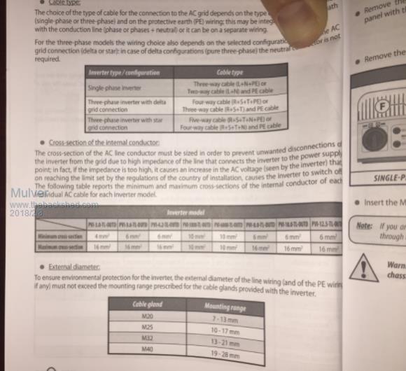

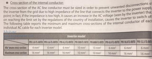

I think your cables are too small.
In one of my inverter manuals it states minimum cable cross sections. This is to avoid disconnections caused by high impedance etc etc.
3kw. 4mm2 cable
3,6 to 4.2kw. 6mm2 cable.
5 to 6kw 10mm2 cable.
I've taken a photo I'll load it up tomorrow.

Mulver
Joined: 27/02/2017
Posts: 160
Posted: 11:06pm 07 Feb 2018
Sorry its a bit blurry!
Regardless you cant punch 5kw up a 2.5mm2 cable.
I suggest a nice big fat cable from your switch board to maybe an inverter sub board in your shed.
The most id sneek on a 2.5mm2 supply 25m away would be a 1.5kw inverter.
For example I have a 2.5mm2 supplying my rain water tank pump 20 m away and id like to sneek a few pannels on top of the big tank.
