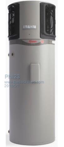

I've got 2 Rheem's here; both recovered as scrap.
What I've done is recovered the Heat pump unit off the top & converted it to a Spa water heater.
There's quite a few points of failure.
The Tank Temp sensor, is a strip PCB with resistors & thermistors, that green flexible ribbon type, runs the full height of the tank from top to bottom & measures temp at about 6 locations.
It get moisture in it & fails. It's actually got 2 separate circuits; as in a spare, but on the one I stripped out, bonded under the expanded foam, the spare side was almost as corroded as the one is service.
Their circulation pump is prone to clogging up & failing, causing the compressor to draw maximum current & eventually blow the Mosfet's on the control board.
Basically, the only good part is the compressor/heat exchanger unit. It's quite good.
Replace all their control electronics with my home grown stuff & it's an efficient Spa heater in conjunction with the solar water panels.
What I'm wondering about doing with the spare water tank though is to put it outside near the inverter cabinet & use excess solar during the day to heat it's 320l of water, then plumb that to the main off peak HWS.
In theory it might mean the HWS is fed something warmer than 24°C water in Summer, and better than the usual 10°-12°C it has to heat up in winter.
Ideally, it's element could be "Dimmed", to the point where the solar output is kept near it's maximum capacity.
Phil.
