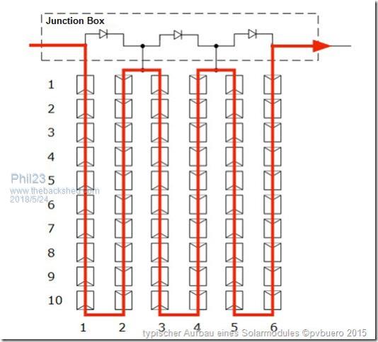

  George65 said
Wouldn't the Diodes in the panels stop any back feeding as it were or are you trying to take the load off them?[/quote]
No, they are across the strings in the panels,
if you put say 50V across this panel, it couldn't flow thru the diodes as they would be reverse biased, so it would flow back thru the cell & generate heat.
A single diode at the end of the string will block it though.
Just needs the appropriate voltage & current rating.

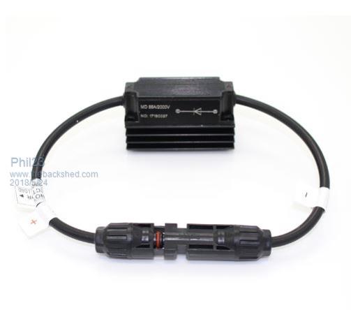

  George65 said  I Bought a bunch of 600V/ 10A diodes a while back. Would be interesting to splice them in and see if and what difference they made.
Which ones?
I've got these...
Might be a bit of an overkill, but better than under rated.
Phil.
