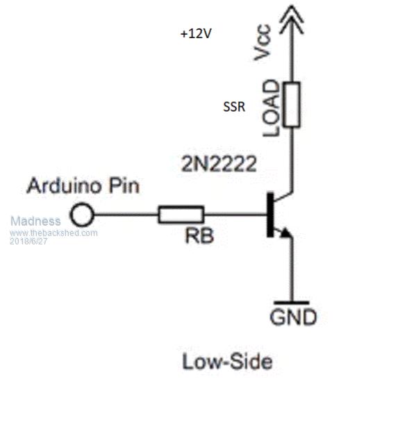

Phil you can drop back the power consumed by the 3.6KW element by putting a motor run capacitor in series with the AC L connection. You will have to play around with values.
The following Arduino code works well with my regulator to divert excess power across to the HWS. The resulting PWM output needs to be stepped up to 12V which can easily be done with a 2n2222 transistor on the low side to drive a 25A AC SSR.
if (vin > (Setpoint - 0.2))
hwval = (hwval + 4);
if (vin < (Setpoint - 0.4))
hwval = (hwval - 14);
hwval = constrain(hwval, 0, 255);
analogWrite (PWMHW, hwval);

George are you trying to get a 0 export by diverting all the power to the HWS from your GTI?

Line voltage will vary from all sorts of things within your property and outside.
How much power you want to feed to your HWS is far to vague to write code for with what you have written here.
"Today for instance is cloudy and there will be little output but yesterday I could have probably fed 2.5 KW to the heater instead of 1.5. other days may only allow 500W. As well as the water heater, in winter it would be great to have something I could also use to divert varying power to something like a simple bar heater in the house. With such a devise I could use the excess power I have and if I put on the Jug I'd not be drawing from the grid because the devise would sense the lower line voltage and throttle the heater back or shut it off. "
What can be done and is available off the shelf is devices that detect when you are exporting power and divert it to your hot water system and aim for 0 export. If you are making more power than the HWS can take either by too much power or the thermostat has turned off it will still export.
It would not be difficult to make a device to do this too a set a limit and would all be based on current. It could be setup to try to export 0 or limit to a value. The closest I can think to what you have asked for is to have knob on it that you can set the export limit as you desire.
If the other project you are talking about is the one where you want to turn on GTI to meet the power demand of your air compressor or whatever it was I can't help with that.
