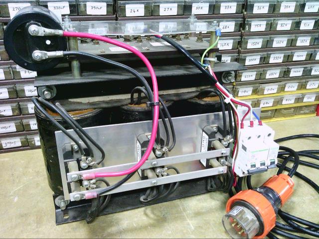

LadyN
Joined: 26/01/2019
Posts: 408
Posted: 04:13am 06 Mar 2019
The picture looks beautiful!
1. What are those 3 things into which the windings feed into?
2. What the rating of the cap at top left and what does it do?
3. What's on top of the board and why do they connect to what looks like breakers?
Posted: 05:43am 06 Mar 2019
1/ One hundred amp bridge rectifiers, mounted on an aluminium plate heat sink.
2/ Not really necessary, as the ripple out of a three phase rectifier is only about 2% without any extra filtering. Its there only as an "add on" to reduce any noise when run at very low load current.
3/ On top of the transformer are some connections to allow for different mains input voltages. In this case tappings are for 225v, 240v, and 255v.
Yes there is a 10 amp three phase circuit breaker which is mainly to provide an on/off switch.
The reason is more for safety, in fact it is a statutory requirement to have an on/off switch within three feet of "the equipment" but its also just common sense.
Its much more convenient, rather than having to keep walking over to the remote power outlet to switch the thing on and off.
