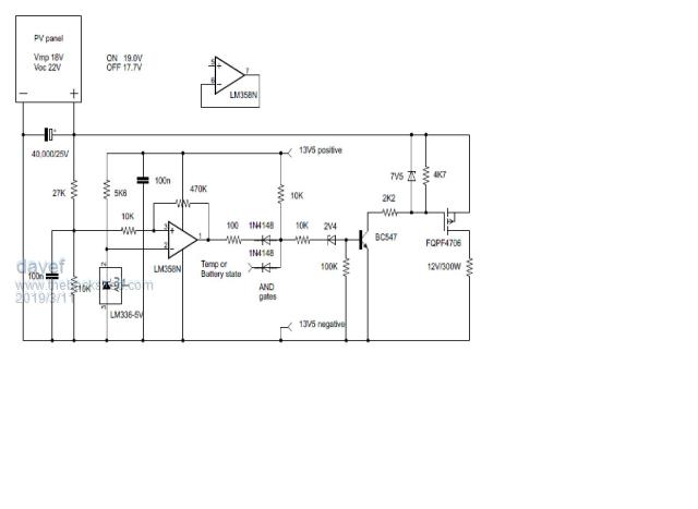

While trying to get a SMPS boost unit to feed power into a 230V hot water tank element I had a play with a 12V 300 Watt DC rated element and this simple analogue diversion unit.
The idea was proposed by SolarMike, that of using a capacitor to transfer energy from the panel while keeping the panel near its Vmp.
I tried to supply the LM358 directly from the PV input but couldn't get it to fire up cleanly so went to a constant 13V5 supply.
The discrete AND gate is so that other inputs can control the Hi-side PFET, ie temperature, the state of the main 13V5 battery, etc.
Haven't optimised the switching points.

Sounds simple enough, but you can get into real trouble since the frequency is not fixed. It can quickly turn into a high frequency linear oscillator and overheat the FET due to inadequate drive. P-FET should be avoided due to cost and poorer performance. 7.5V is not a lot of drive to get full saturation.Edited by hotwater 2019-03-13

As this PFET has a +/-20V V(BR)GSS the zener is probably redundant. Point taken about drive I will investigate further.
I was reading through this which suggested the P-FETs were better, but I think better as in easier to implement not best from a rDS point of view!
  Quote   It can quickly turn into a high frequency linear oscillator and overheat the FET due to inadequate drive.
I don't understand the statement. The repetition frequency changes with the amount of PV power with the ON-time being fixed.

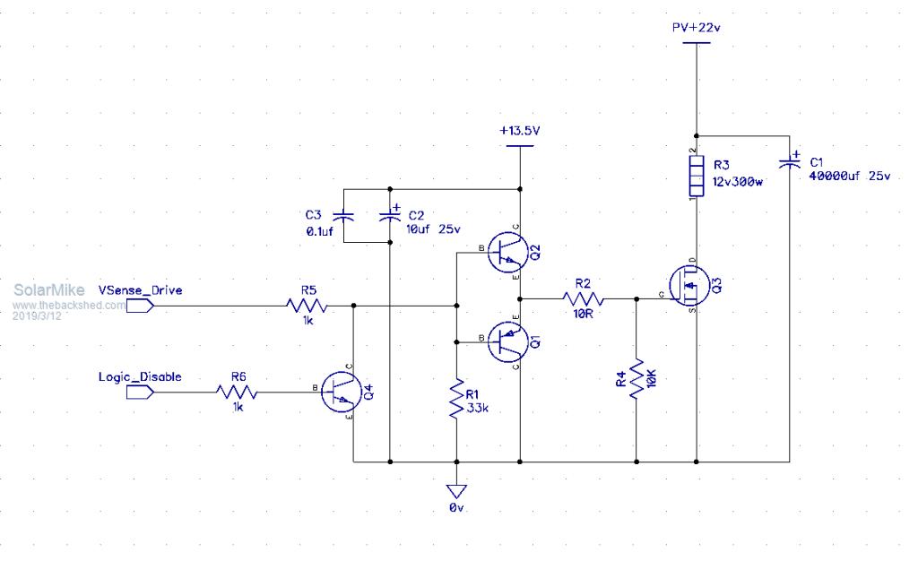

Solar Mike
Joined: 08/02/2015
Posts: 1255
Posted: 09:05am 12 Mar 2019
Dave, the cct could be modified to use a N channel with low side switching and have better drive for faster on off times. The emitter followers can be small signal transistors.
Your voltage sensing switch circuit will act as a low frequency oscillator when the sense voltage drops below the panels set mppt reference value and at low light levels will switch on and off at a variable frequency determined by the sensing hysteresis. If you use a mosfet with 5-10mR on resistance then very little power will be wasted.
Unless there is a good reason to use a high side switch of course...
Mike

Posted: 06:40pm 12 Mar 2019
Hi Mike,
Thanks for the circuit. In the document I linked they discussed the boot-strapping approach for N-FETs. I will try modifying it to use a N-FET.

It may not seem obvious. For a self powered unit, the most dangerous time is when the array is producing less than 10W. You wouldn't think you could destroy a FET with that. Having under voltage lock out is a must.

  Quote  I tried to supply the LM358 directly from the PV input but couldn't get it to fire up cleanly so went to a constant 13V5 supply.
The under-voltage lock out is part of the design, ie the LM358 comparator.
I have some STM STP80N70F4 with about 8mOhm RDS(on) which is about 1/2 of the FQPF47P06.

  hotwater said   It may not seem obvious. For a self powered unit, the most dangerous time is when the array is producing less than 10W. You wouldn't think you could destroy a FET with that. Having under voltage lock out is a must.
I would like to understand this further.
I understand that at 10W point, the Vgs is nearing Vth and hence in the linear region where Rds is pretty high.
HOWEVER, how much is Ids in this situation, because (Ids ** 2) * Rds is the power dissipation and at that high Rds, I do expect Ids to be pretty low when sourced from a 10W source?
It's obvious to me I'm missing something but I would like to know what
hotwater
Joined: 29/08/2017
Posts: 120
Posted: 05:47pm 05 Jun 2019
Chances are for a self powered unit it will go into oscillation driving the FET in a linear region. This is the reason a true functioning low voltage drop out is needed. The TL494 does have a low voltage drop out, but it was designed almost half a century ago when there were just transistors. I do all my testing at early dawn. That is where all the design problems show up. Full sun is a piece of cake.
LadyN
Joined: 26/01/2019
Posts: 408
Posted: 05:54pm 05 Jun 2019
  hotwater said   Chances are for a self powered unit it will go into oscillation driving the FET in a linear region. This is the reason a true functioning low voltage drop out is needed
Ah, I see where the disparity is - you're talking about a self powered unit while Dave is powering the opamp externally from a stable regulator PSU.
Besides using gate drivers with built in LVO, I believe a LVO can be designed using two TL431s to provide some hysterisis?
Still, my question above stand:
how much is Ids in this situation, because (Ids ** 2) * Rds is the power dissipation - which is I assume, what kills the FET and at that high Rds, I do expect Ids to be pretty low when sourced from a 10W source?
