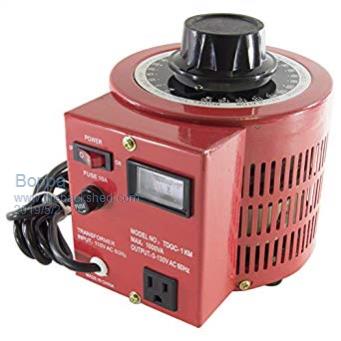

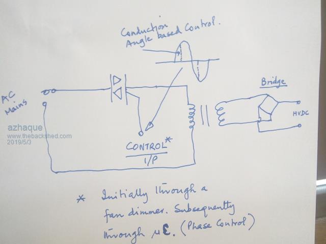

Probably the easiest way to get around several of your issues (dc on the lines, voltage matching needed, might be to invest in a variac for the AC line- if you get an isolated model, it would decouple the dc from the grid supply and give you the ability to vary the mains voltage to the diodes- giving you more precise matching if needed...
They are available in a variety of rating, from 100w up to thousands of watts...

Using a variac to provide isolation is a brilliant idea, thank you.

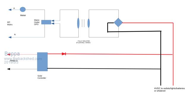

Using a fully isolated variac would again stop any feedback- although I can't see any way you would get 'more neutral current' anyway if my understanding of what you are doing is correct...
Even if you didn't use the variac (I would just to a: keep the power company happy and b: prevent any electrolysis issues from the DC with N/ grounding etc)- if I understand your circuit- it will neither backfeed the meter, nor send more current down the neutral than is being drawn from the active..
Adding a genpack is as easy as putting another bridge rectifier (the diamond on the grid feed circuit- AC top and bottom, + right red,- left black like on the grid feed- no need for the variac on this one though, as you don't care about DC on the supply, unlike the power company) and connecting it to the 'DC bus' lines
(btw the drawing above is ignoring all the finer details like circuit breakers etc)
If you aren't using a solar controller, then just the blocking diode is required...
Adding more panel banks is as easy as copying the entire 'panel branch' from panels th HVDC bus on the right as many times as you wish
One advantage of the gpo/outlet use with the variac is that it literally 'plug and play' on the grid side if you wish
(sorry about the crudity of the drawing, I'm on my laptop and only have a basic drawing package on it)Edited by Boppa 2019-05-04

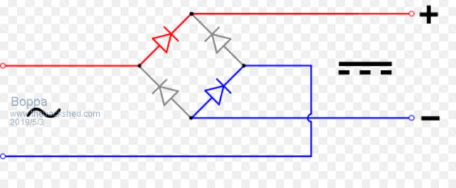

That is the EXACT schematic (minus the transformer ofcourse)!
So that I can loadshare with the grid, my PV GND and Grid neutral are electrically connected.
The Grid is connected via a full bridge rectifier.
I am hoping the diodes prevent backfeed into the grid.
Now, what I don't understand is how the current sources from PV would flow when no current is being drawn from the rectified grid.
My understanding is that current always follows the path of least resistance and PV is a higher impedance than the grid.

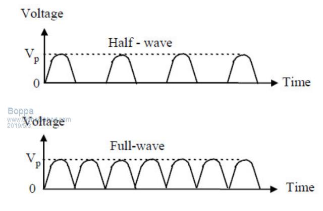

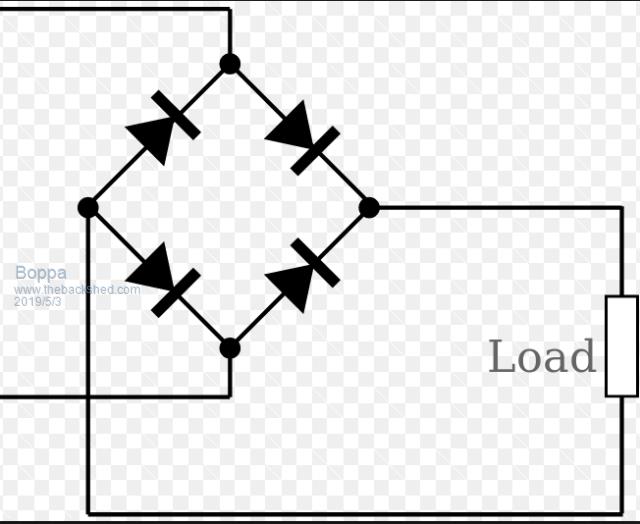

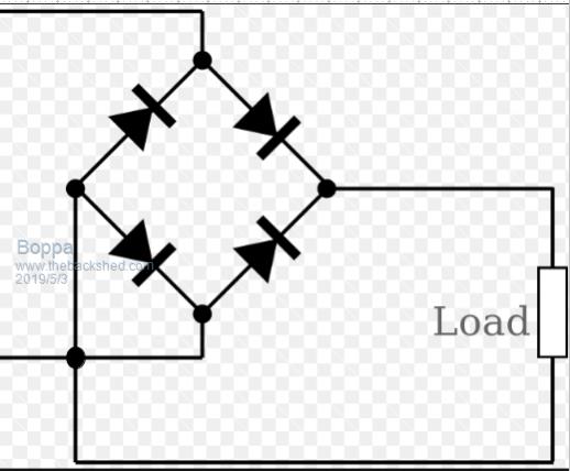

You shouldn't even need that PV (-) to grid N link (I assume that's what you meant by PV gnd??), if you are using a bridge rectifier on the grid supply, that's effectively cutting some of the diodes out of circuit...
What you would be doing is joining the 'hump' instead of the wires passing but not joining- that effectively cuts that bottom 'blue' diode out of the circuit entirely.... (that blue (-) wire should be black, not blue)
(I'm trying to imagine the waveform you would be getting both on the AC side and the DC side- my brain hurtz now...)
OK figured it- you have effectively turned it into half wave rectifcation
So you would be getting the top waveform, when you should be getting the bottom one (and effectively disconnected 3 of the 4 diodes in the bridge...Edited by Boppa 2019-05-04

Ah, so when using half wave configuration, there is a chance of current generated by the PV array flowing into the Grid N, but when using a full wave configuration, the biasing of the diodes localize and isolate the PV array currents within the PV array?
LadyN
Joined: 26/01/2019
Posts: 408
Posted: 07:05pm 02 May 2019
The blue path still shows a way to Grid N from the PV array I think

I don't want to be a damper on you or insult you in any way, but really- you should understand these things BEFORE playing with HVDC
It is VERY intolerant of making mistakes...
These levels of current and voltage could easily kill, or start a fire...
That said, each of the voltage sources is its own independent circuit, if the PV is supplying all the voltage (and current) then the AC grid connect is effectively open circuited by its diodes- the panels (+) comes out the panel, through the 'bus' on the right of my drawing, through the loads and back to the panel (-)... the grid system there is completely non existent as far as the flow of electricity is concerned...
Same when it's night, panels are now 0volts, no current flowing, all power passes from the bridge rectifier, through the bus, through the load and back to the bridge rectifier -, now the panels 'aren't there'
IF you have load sharing happening then it gets interesting...
If you panel voltages are higher than the grid rectifier output voltage, then the panels will produce up to their 100% rating depending on the load- if its only say 10W, the the panels, being the higher voltage will do all the work, all current comes from and goes to the panels- nothing- zero comes or goes to the grid wiring
Lets bump the loads up, switch a few more lights on or whatever, we have hit the panels full output and gone sailing right past it...
Lets go to double the panels output...
Now this will drag the panels voltage down as they try to output more power than they are capable- this keeps dropping as the loads increase until we get to the stage that the panels voltage is equal to the grids rectifiers output voltage... half the power is coming from the panels, half from the grid rectifier...
Even now- there is no excess current in the grid (-), or indeed the Neutral compared to the Active- the bridge rectifier is happily acting as a normal load to the grid, no nasties, no unbalanced currents anywhere- it's outputting it's current (say 5a) to the + bus- out to the loads, and back in the - bus, where exactly that same current will flow back into the - side of the grid rectifier
Over at the panels, the same thing is happening, another 5A is coming out the +, joins in the + bus to give us our 10A required by the loads at this level, through the loads, back out the - bus and back to the panels... again the current in will be exactly the same as the current out on the solar leg...
You will never get a situation where there is more current coming back in one side than went out the other... simply doesn't happen
The circuit as I drew, which is 'almost' the same apart from that nasty neutral/negative link (get rid of it- not needed and could cause all sorts of noisy transients on your DC supply) will never backfeed the grid, affect the meter in any way apart from it registering the power used by you, wont make it read your solar generation and add to your bill

THANK YOU!
I did not feel insulted with your response.
I highly value you highlighting mi mistakes as that's the only way I learn.
Thanks to each of you, I NOW know more than I did a month ago: I AM FAR from being competent but guided practise will get me there.
THE ONLY way I can see progressing is share my thoughts here and being told where I am wrong, so I REALLY appreciate the insights you have shared because I don't know what I don't know.

  LadyN said   The blue path still shows a way to Grid N from the PV array I think
The blue shows the returning current- and HAS to be the same as the current that went out- thats just the way electricity works...
Where the little 'hump' is where the two blues cross each other, that means they AREN'T joined, just 'jumping' over each other... (a joint is a solid dot when shown on a circuit diagram)
What you have done atm is joined them- bad, gives a rapidly pulsing 'kinda' DC from the grid rectifier- you DON'T want this, you want a nice smooth dc supply, same as the panels (that's that nasty jumping up every now and then waveform I posted before- you don't want it, and that's what your current wiring setup is doing)
Boppa
Joined: 08/11/2016
Posts: 816
Posted: 07:38pm 02 May 2019
This is the guts of the bridge rectifier- basically 4 diodes in a box...
note that where the wires join, there is a solid dot (where each diode joins a wire or example), where they cross WITHOUT joining it will be that little 'hump' over the wire or just crossing with NO dot... compare to the blue wire diagram above and you will see that 'hump' where this one has no hump at that point, just crossing unconnected wires)
Note that this one is turned 90 degrees to the right compared to the one above as well, sorry about that
the 'red' is coming out the right and the 'blue' is on the left, top and bottom are the AC inputs
What you have wired is this (see the extra connection???)
