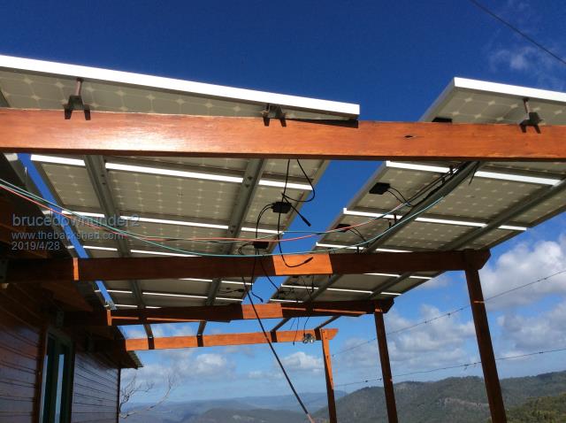

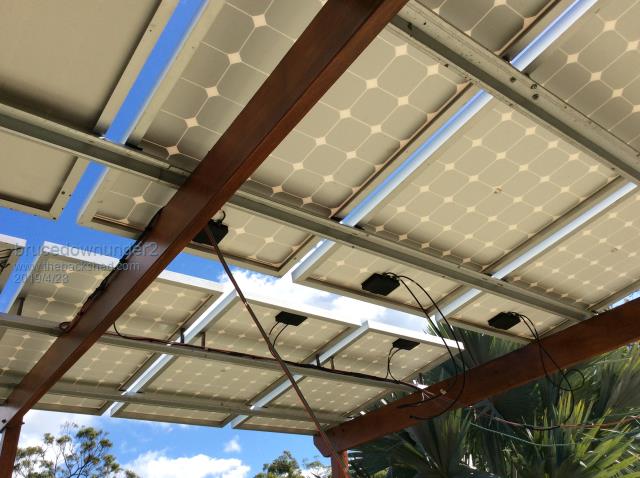

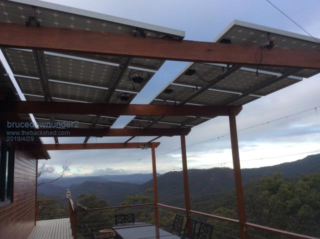

I won these 14 panels second hand in good condition .
6 @ 170 watt. And 8 @ 190 watt.
They get the sun from around 6am in summer til. Around 6pm in summer . Winter ,take a couple Hrs. off
Those hours. We are Gold Coast hinterland ,so sun up is first light ,sort of thing.
I installed gal steel extrusion called “top Hat” type channels . I cut 3 inch long copper water pipe for elevation stand off,s. Stainless steel washers and insertion rubber washers between dissimilar metal surfaces will prevent corrosion.
Have had 110 Kmph storm winds since they were fitted and they seem to be rock stedy.
Am using 4 and 6 mm. Sq . Tinned wiring . Series each pair for 48 volt nom. And running 5 strings back to a connect,disconnect box on the house wall , before the main supply to my regulator under the house in my workshop.

Looks almost as good as that beaut view.
Ever considered overlapping of sorts to keep the rain out as an impromptu roof?

About the gap between the panels or "overlapping " as Ralph asked.
We used to have grapevine growing where the panels are now . Only trouble with that was the possums at night and then the python snakes used to make a home in the vines waiting for a meal !!.
Apart from the droppings mess from the multitude of different bird life ,it's a good area to have a lunch time BBQ with friends.
So, no overlapping ,another reason was the afternoon sun ,being in a low angle ,I had to raise the upside panel to prevent shading =still get a 50 mm or so shading very late in the afternoons I guess that doesn't matter.
the 100mm copper water tube used as a riser prevents the accumulation of water plus the shadow sort of goes under ,not over the adjacent panel.

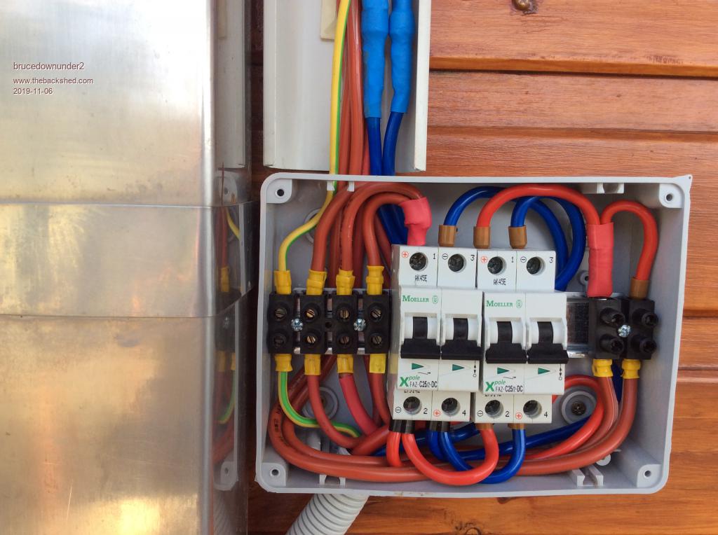

Yes, finally got to finish off the install work and cabling.
Installed 6mm tinned single runs from the panels to the junction/disconnect weatherproof box at chest height on the outside wall.  Breakers are 25Amp DC polarised (be careful with "in/out" positive and negative).
Earthing will be "stand-alone" connected with special anodise displacement washers onto the Al frames. copper earth stake into earth below the deck.
10mm double insulated feed from disconnect box to breaker on regulator panel.
Two strings will be combined at the disconnect box to feed the 2.5Kw x48v nom. down to the regulator. Either string can be isolated individually for maintenance, leaving one string "on-line'.
