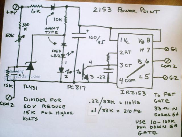

The biggest thing I think you would have to overcome is trying to figure out if the DC voltage will hurt the points in the thermostat and the safety cut out
I know I read somewhere a while back where you can use a regular off-the-shelf AC hot water heater element with DC it is a certain element I think they so you would have to research it
They may already make something like this for DC not sure you'd have to do a Google searchEdited by BenandAmber 2019-05-11
hotwater
Joined: 29/08/2017
Posts: 120
Posted: 06:21pm 10 May 2019
Under 30V DC is always safe, tungsten a little higher. There are ways to reduce the voltage differential for the time it takes to open. Thought you were using pulsed DC. The smaller black box just above the thermostat is the thermal overload safety switch. It mechanically opens and has to be manually reset. It should always be directly in series with the element. This is generally only included in the upper thermostat, but can be added to a lower thermostat.
