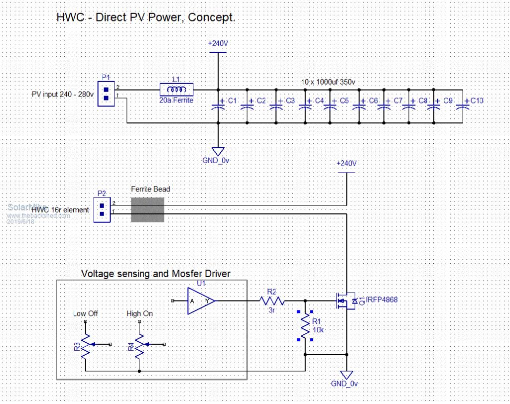

Yes it can be done, but a lot depends on exactly what you want it to do.
If all you want is use solar panels for heating water and keep the panels operating around the most efficient power generating voltage, then that is not too difficult.
Many people want to divert excess power into heating water, but only after the main function of recharging a battery has been achieved. That requires a much more complicated control strategy.
Anyhow, the basic idea is to maintain the solar panel voltage within a fairly limited operating range, where they are operating close to their efficiency peak.
The heating element is of course a fixed load, which will be far too much load for solar to drive, except under the most ideal conditions.
The way to do this is to connect the solar panels to a large energy storage capacitor bank, preferably at a high dc voltage. The amount of energy stored in a capacitor is proportional to the voltage squared, so a higher voltage will require fewer and smaller capacitors and be more efficient.
What we then do is connect our heating load to the capacitor bank through a mosfet switch so that the load can be switched on and off electronically.
We have a voltage sensing circuit that switches the load in and out at two very distinct voltage levels of the capacitor bank.
The capacitor storage bank charges up either very slowly under poor solar conditions, or much faster in more optimum solar conditions. But when the voltage reaches some set maximum, the heating load is switched in.
The voltage on the capacitor bank will quickly fall, and when it reaches a set minimum, the mosfet switches off.
So the voltage on the capacitor bank rises and falls between two fixed voltages, and those are set to coincide with the most efficient solar panel operating voltage range.
The discharge time will be pretty much fixed by the stored energy and the resistance if the heating element.
But the charging up time will be highly variable depending on how much solar current is available. It could be several milliamps to several amps. So the frequency at which the system cycles on and off will be highly variable from minutes to several or many tens of Hz.
One problem to be aware of is that the thermostatic switch in the hot water storage tank, and the mandatory manually reset over temperature cutout, will arc heavily and quickly burn out if an attempt is made to supply straight dc to to the heating element.
That problem can be overcome by using four mosfets in a bridge configuration instead of just one mosfet to switch power between the capacitor bank and the heating element. That will disrupt any arc that forms, similar to what happens with the ac mains supply.
Its all fairly straightforward, and suitable voltage operating points and capacitor bank sizing can be worked out theoretically, or found experimentally.

I have never built one of these myself, but we can look at the whole problem from the theoretical aspect. I have a spare 24v panel here, and a means to test it, so tomorrow I will make some measurements of what sort of voltages we might expect at peak power and at what voltage the power falls away by either side of that peak.
We are close to mid winter down here, so I need a reasonably cloudless sky to do this test which may be rather difficult.
And yes, the larger the capacitor value the slower it will cycle.
But there is another problem.
We can only discharge some small proportion of the total stored energy. The voltage can only be allowed to fall so far to remain in the high efficiency area of the solar panels. So we cannot recover all of the stored energy, but only a small fraction.
That means the total stored energy is going to be enormous to be able to transfer power at the kilowatt level. It may be impractically large (cost) but we shall see.
The trick will be to find out what might be some suitable threshold voltages to keep the panels working efficiently, and how much capacitance might be required. I have no feel for this, so some practical testing will be required on which to base some assumptions.

Suppose for example, (I really do not yet know) we can only discharge our capacitor by 10% of the total stored energy, until the voltage falls to the low voltage limit, and we have to recommence the next charging cycle.
If we need to transfer 2Kw, then the capacitor bank may need 20Kw of accumulated charge to do that. And because it pulses, the peak energy transferred will need to be a lot higher than the average.
If for example it charges up to 20Kw of stored energy, and then discharges down to 18Kw of stored energy each cycle.
There is no problem with doing that technically, except the capacitor bank may need to be much larger and more expensive than we expect.
I have no idea at this stage, which is why I need to take some measurements and work out some requirements and crunch some numbers.
It will certainly work, but it may be a whole lot larger and more expensive to build than we anticipate. Or it may all turn out to be dead easy, I really do not know.

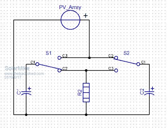

Another way of perhaps better utilizing the capacitor is have two, whilst one is being charged from the PV array, the other is discharged across the HWC element. When the cap voltage falls say 10v below the rated element voltage then the other one discharges... dia here shows concept, replace the switches with mosfets and have your arduino etc monitor the voltage on both cap's, switching the mosfets at the rate necessary to recharge them.

Mike, to the ignorant your idea sounds good. How would one switch such a circuit and with what components?

Dual capacitors definitely worth some serious consideration Mike.

Here are my own observations:
1. over a large insolation range, the voltage stays the same but the current scales linearly
2. given similar insolation, lower the ambient temperature, higher (~10%) the voltage (similar current) = more power
3. load HAS to be matched to the panel, otherwise, the load will draw the panel down to a suboptimal power
The last one needs a lot of thinking and is not trivial to deal with.
It WILL mean the difference between gallons of water that is barely warm vs. hot enough for a few showers given the SAME amount of panels.
DIRECT hookup of heating elements to PV Array will just not work unless you throw enough panels (= money at it).
A more efficient solution will figure out a way to match the PV Array to load.
My intuition is more can be done with less - for example, a suitably sized capacitor bank with a setpoint relay could pull it off.
If that intuition's true:
1. What's a suitably sized capacitor bank?
2. What's a suitable setpoint?
I expect to model this better to understand this but dont have time yet.
Posted: 02:44am 18 Jun 2019
The voltage stays almost the same, such that we can use two set points to charge and discharge our capacitor over a very wide insolation range, and lose very little in the way of recoverable energy.
Within reason, the capacitor bank size may not be that critical. It just has to cycle much faster with a smaller capacitor.
How big a jug do you need to fill a bath ?

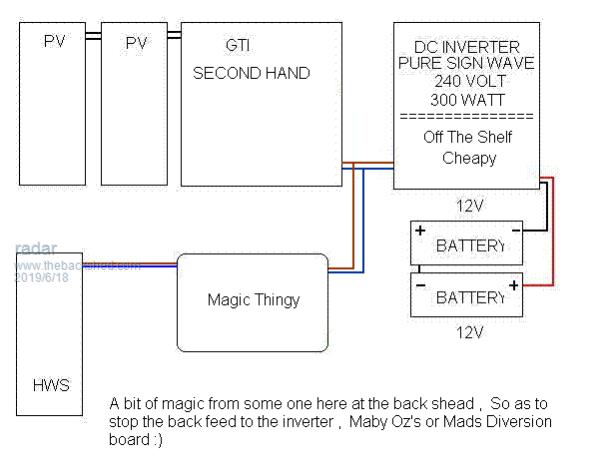

Joined: 09/06/2019
Posts: 16
Posted: 10:14am 18 Jun 2019
I am new here at the shed , I dont know if the picture ill upload
would be relevant to this thread .
But using some cheap/second hand parts might produce an answer that
could be leggo'ed together with little pcb skills needed .
That is if the ( Magic Thingy ) in the photo already exist's .

As a thought experiment whilst Warp is waiting for some winter sun to do a practical test... looked at the basic theory and calculations required to estimate initial parameters.
For a rough theory calculation using Davo99 data:
8 x 250w 30vmp 8.3a panels in series = 240v at 8.3 amps current.
Use a good large 10,000uf 350v low esr capacitor.
HWC element = 16r
A mosfet will turn on, discharging the charged capacitor across the HWC element when its voltage reaches 240v and turn off when the cap voltage drops by approx 10%; whereon the panels charge it back to 240, if in full sun then at 8.3 amps, if less sun then will take longer.
When a capacitor is discharged across a resistor (element) the rate of voltage drop is exponential, so its voltage drops very quickly and determind by the formula Vcap = Vsource x e^-t/RC, if we pick a 10% voltage drop for discharge trip point (turn off), plugging in the values, a 0.1RC time constant will drop the initial cap voltage from 240 to 216 in 16mSec
So for approx 16ms the element is subjected to the full 15 amps from the discharging cap + the 8.3 amps from the panels, power is transferred to the element.
Once the mosfet is turned off by some sort of voltage switch at 216 volts then the cap is charged up again at a linear constant rate 8.3a or whatever the panels can output at the time.
Basic formula for constant current charging V=Q/C where Q=It, so V = It/C or t = VC/I, plugging in values t = 24 X 10,000/1000000/8.3 = 29mSec, so best case 29 ms to re-charge ready for the next discharge cycle.
This 29ms recharge delay means if the thermostat opens at some point, the off period means any arc formed on opening will extinguish, hopefully...
There will be losses doing this switching, looked at specs of a suitable mosfet IRFP4868, 70a, 300v, 32 mR, every discharge cycle of 15+8.3a at 16/29 duty cycle it will dissapate approx 10 watts worse case. However efficiency will be high.
Capacitors have an esr, a good one (costs $$) will be approc 10mR, it will loose power on discharge 15a and recharge 8.3a, so its losses amount to 1.6 watts each cycle, rather than pay $70 for a good cap use 10 x 1000uf ones to get their combined esr down and surface area up, may be more cost effective.
There is a certain amount of flexibility here in that the PVmp voltage can be somewhat higher than the element to cater for different panel voltages.
On paper it looks promising, see what Warp comes up with.
Concept circuit:
Radar, thanks for the input, not everyone will have a battery system for this, efficiency is lost with all those inverters...
