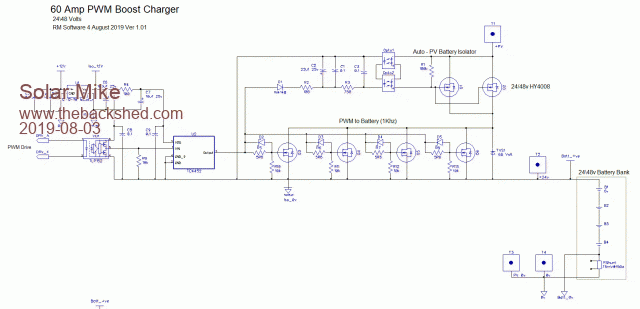

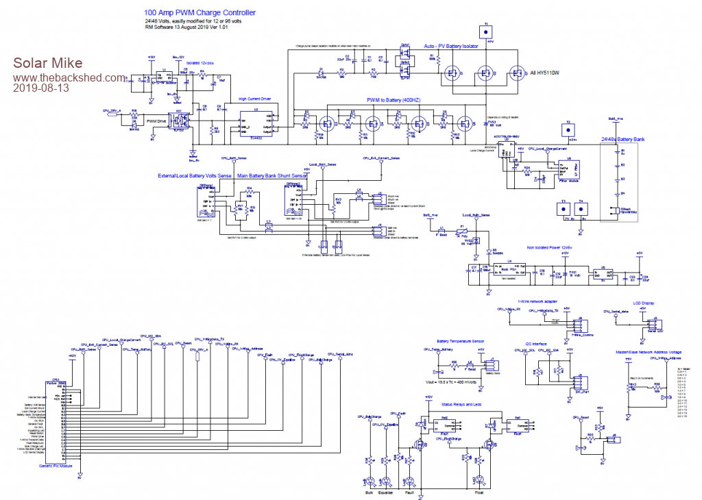

Our temporary 24v off grid installation is not getting enough PV input during the winter, so have decided to throw up another KW of panels to cut down usage of the generator.
Trouble is the small 24v lead carbon battery bank can only accept 60 amps continuous charge, when the sun is shining we already get the 60 amps, so any extra PV has to be managed to limit the total charge current. 80% of the time the existing array wont supply this amount unless its very sunny, so the extra panels should make up the balance limited to a 60 amp total input from both arrays.
So I need an additional charge controller that can sense the battery charge current using the existing 75mv @150A current shunt that is already in circuit for existing metering. A PWM controller seems the easiest solution, using a Picaxe or similar as the cpu, it wont have any displays other than a charge, fault Leds.
Have opted for a high side mosfet arrangement, with an auto PV isolation switch that isolates the PV from the battery when there is no PWM input. Have just thrown this circuit together, will pickup any errors when designing the PCB.
Circuit.pdf
Preview doesnt show files, hopefully they will display ok, pot luck...

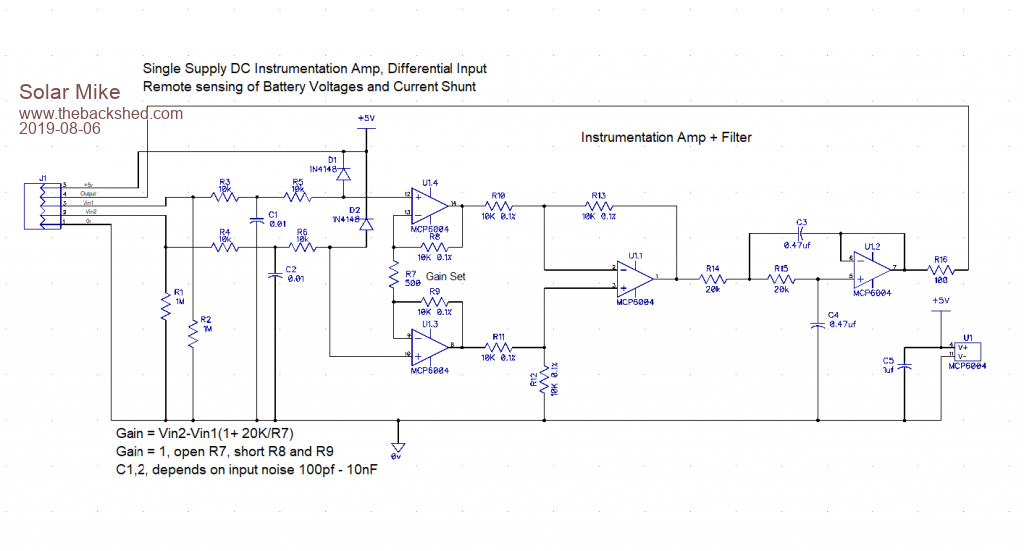

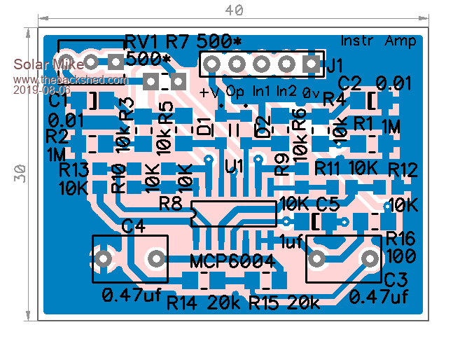

With many of my projects there is potentially lots of duplicated similar circuitry, items like Low Pass noise filters I now use a small plug in pcb module; similarly the above PWM charge controller requires a remote sense direct to the battery terminals and the remote current shunt. Most of the other controllers like the 3Kw MPPT also require remote sensing, passing high currents through even 50mm^2 charger cables cause incorrect voltage readings at the charger end.
Generally one connects remote sensing by a twisted pair (perhaps Shielded) cable, if the sense circuitry is a true high impedance differential amplifier (Instrumentation Amp) then a lot of the common mode noise can be greatly reduced and voltage drops caused by cables and various inline fusesreakers eliminated.
Here is the circuit for an instrumentation DC amp, runs off 5v, currently set for a gain of 41. This fits on to a 40x30mm pcb with a 5 pin rt angle pin connector.
Note untested design.
I will use two of these modules in the PWM controller, if the remote sense has a voltage on it then the controller will take that as preference over the normal input.

Nice looking circuit there Mike.
I recently breadboarded an MCP6004 op amp for amplifying voltage from some CT's yet when I made it with vero board, it all went pear shaped, that project has been on the backburner for a while now.
I'll keep an eye out for when/if you have some of these op amp boards made.
(If you're confident of the design I'd pay for a few blank pcbs ).

That circuit will only work for DC voltages greater than 0v, you cannot use it for AC inputs that go below 0v potential, to do so would require modification to add a 2.5v reference voltage to the input, making the 0v point = 2.5v; this would then allow the output to swing +- about the 2.5v reference.
For my CT current measurement, I was using a precision true rectifier using a couple of op amps feeding a low pass filter so only DC remained.
Mike

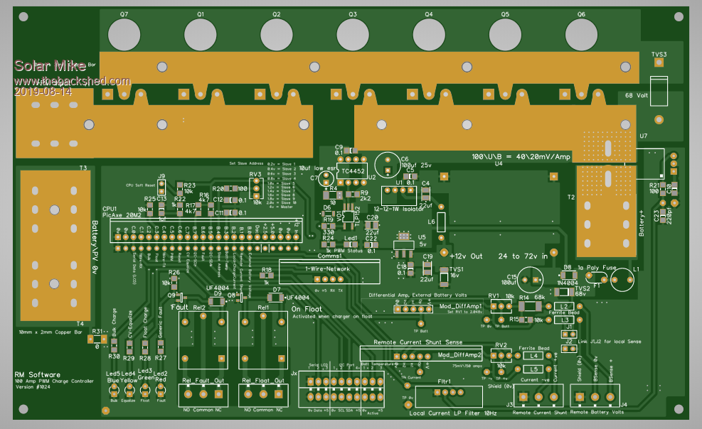

Now that I have started laying out the PCB, things get changed a bit; am using 10x2mm copper strips on the main conductor tracks to increase current capability, available really cheap on AliExpress. This gives a conservative track rating of 80 amps + the copper on the pcb, say 100 amps limit.
Mosfets are cheap, so the design will be changed to allow 100 amps continuous charging; during bulk charge the mosfets are on continuously, thus no switching losses, its only during the constant voltage phase with a tapering charge current that they are pulse width modulated with an ever decreasing duty cycle; then when switched to float the occasional pulse determined by battery bank loading.
To keep total mosfet losses to 20 watts, will need 3 mosfets for the isolator and 3 for the PWM switch, using the 100 volt HY5110W mosfets with 2.5mR on resistance; US$1-20 @.

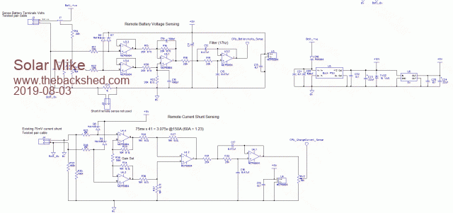

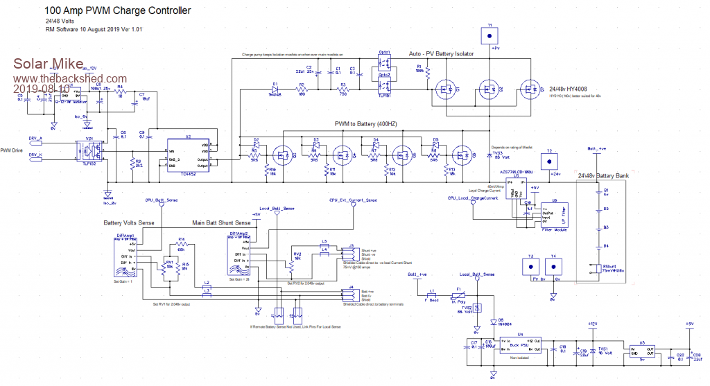

Have been updating the schematic along with the pcb design:
External battery terminal volts and common current shunt are measured with differential amp modules, I will use these modules in all "Charger" type designs from now on as it makes life easier.
Have added a local charging current sense also, so the CPU can measure input power and allow limiting of average charge current. Yet to add battery Temperature sense for accurate voltage setting.
Along with the other Mppt board design, will add a 1-Wire buss comms module, so in multiple charger solutions, one device can assume the role of "Master" and tell the others when to switch to float etc. Also this allows the site management system to get data from the chargers via the buss.
For anyone wanting to build this, a lot of this stuff can be left off, so allowing a basic system.
More to follow...
Mike

Right, pcb 99% done, circuit has a few alterations: Using modular plugin pcb's for things that get repeated a lot in these "Solar & Inverter" type projects, eg filters, differential inputs, network interface and the cpu module. If anyone wants to use a different CPU, shouldn't be too difficult as the pcb pins all well labeled.
Circuit.pdf
PCB next post.
Mike

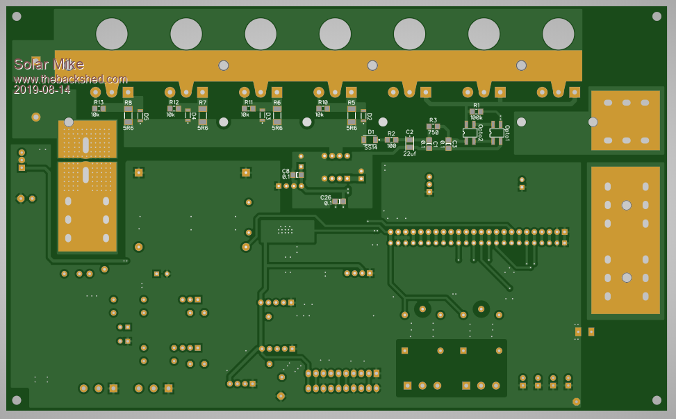

Posted: 12:03pm 14 Aug 2019

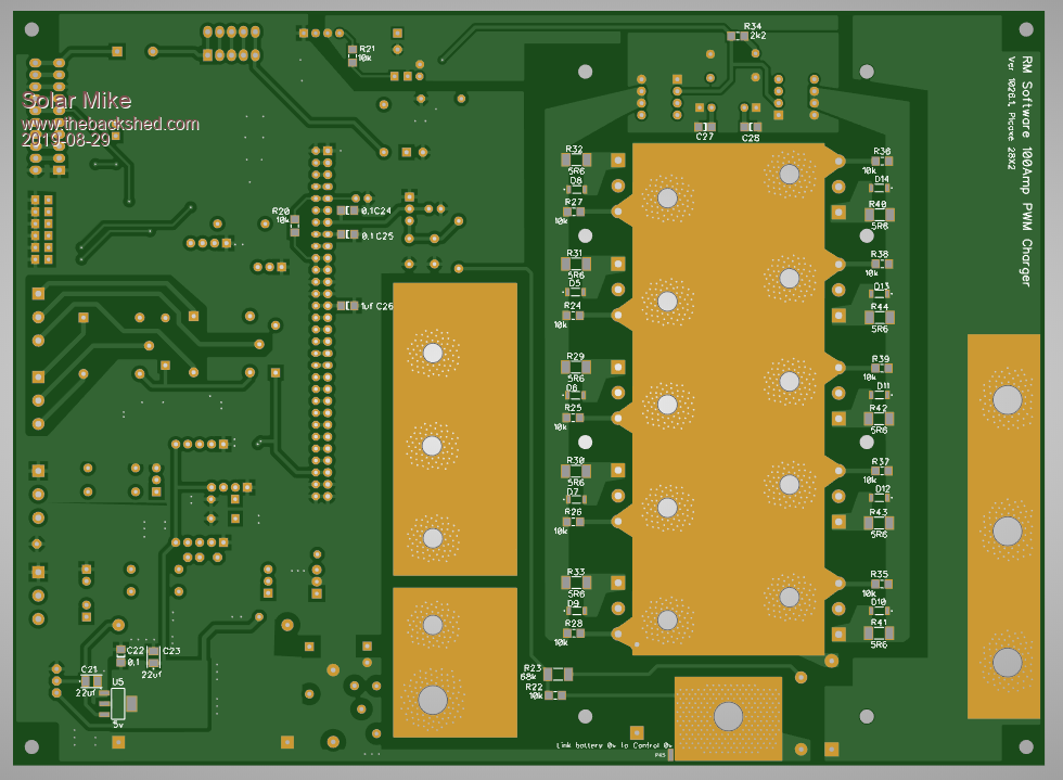

Final board size 222mm x 136mm, Mosfets bolt to alloy plate bottom panel, under the pcb. 10 x 2mm copper bars clamped and soldered to tinned areas.
Not all the mosfets will be possibly mounted, depending on type of device used.
Mike

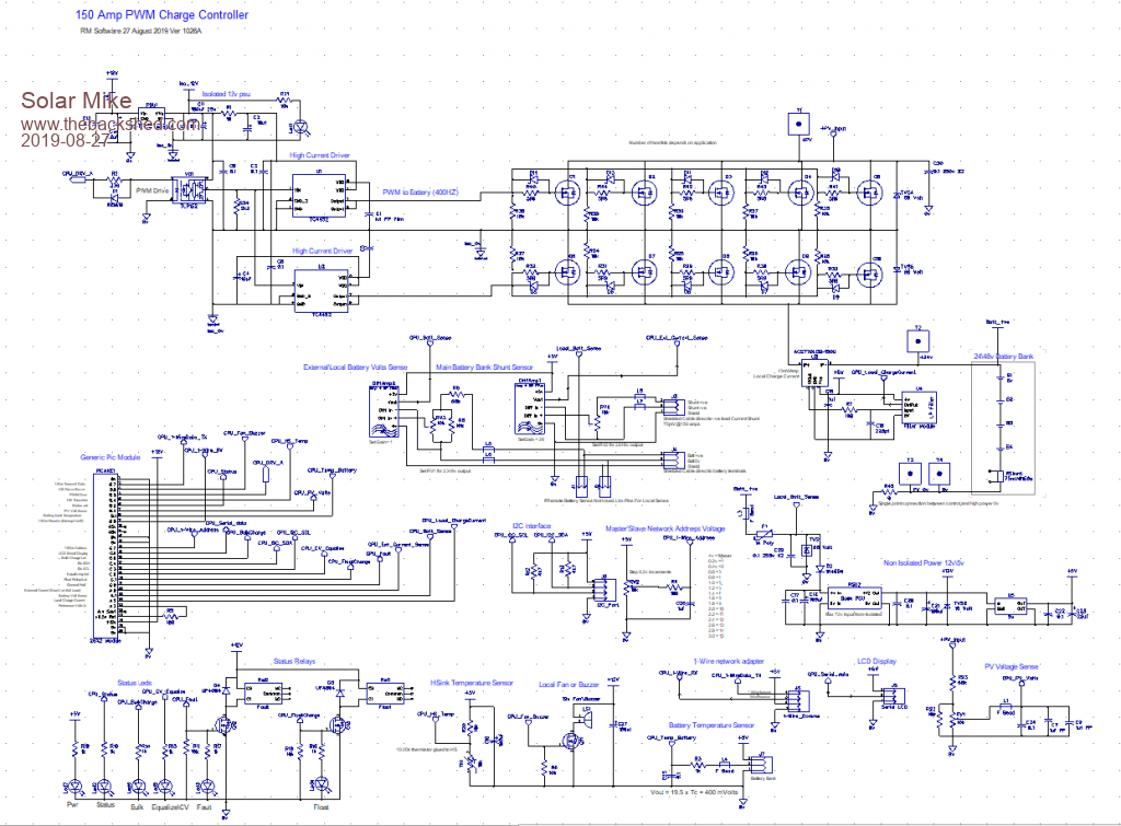

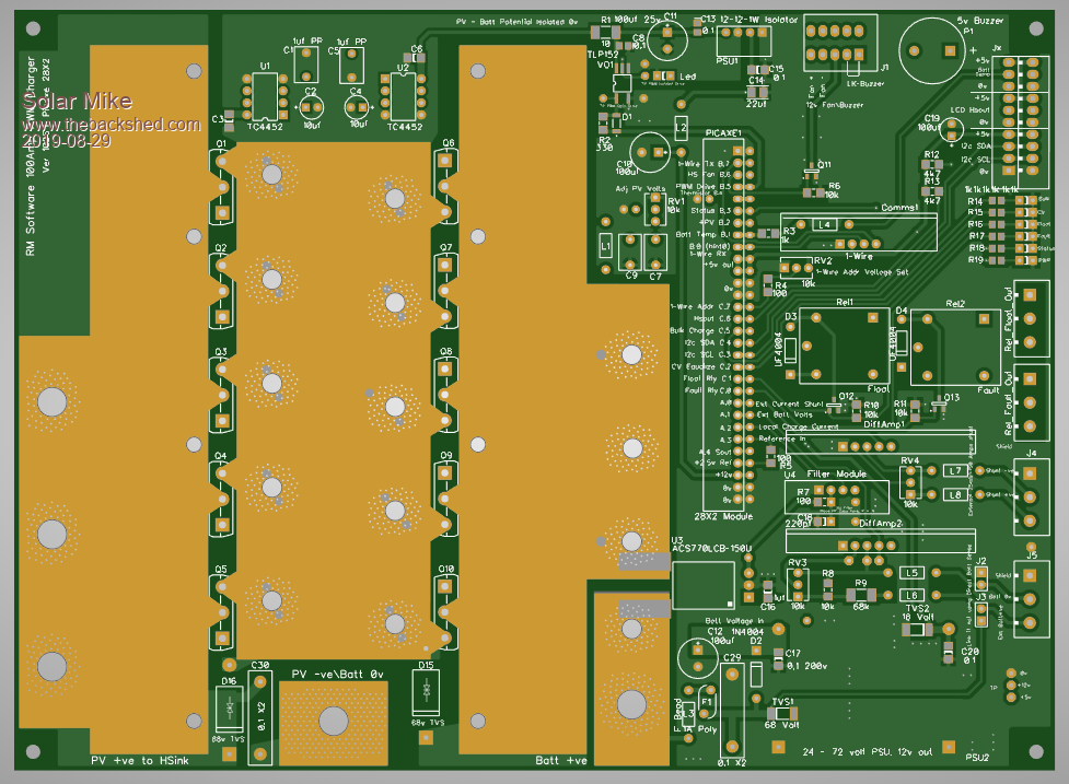

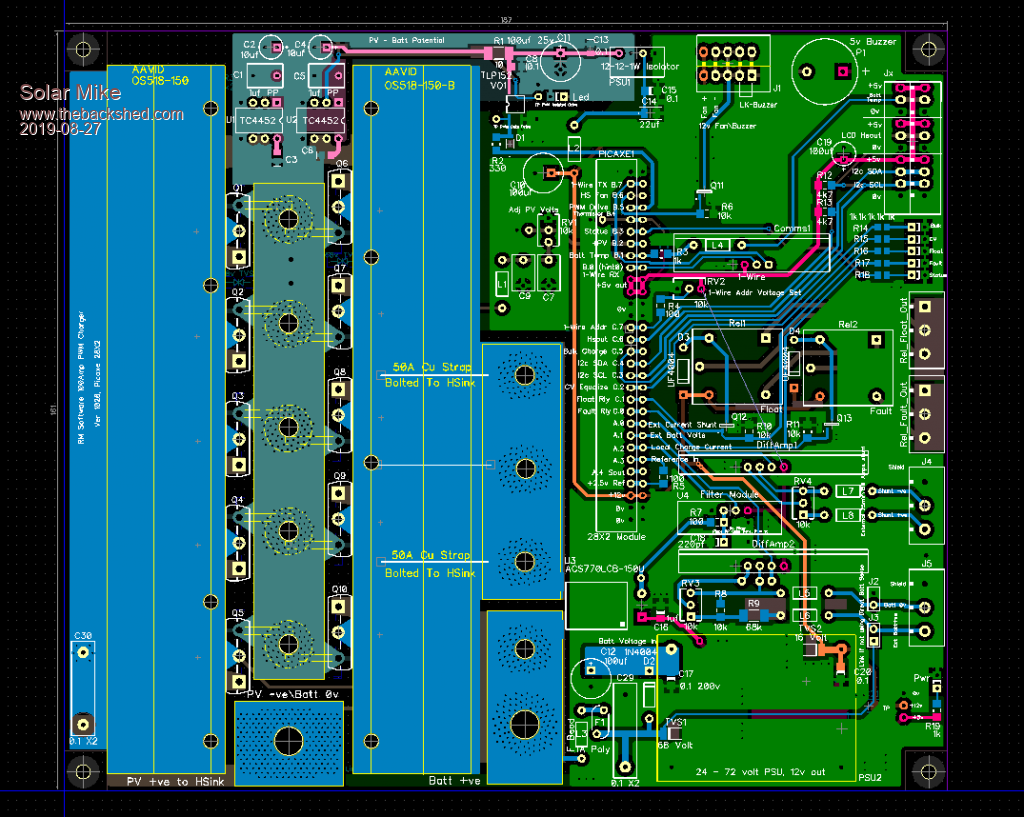

I have decided the above pcb has too many soldered connections for reliability at high currents, the smaller 10 x 2mm copper bars take a huge amount of heat to get the solder to flow and causes delamination of the copper foil.
So have re-engineered it to use heavier 15 x 3mm bars and clamped or bolted connections, as a consequence these bars can carry higher currents, so 150 amps or more should be easily achievable.
I wanted to use part of this circuit in a future intelligent high current solid state switch, so have re-designed the PWM Mosfet section in a different configuration for that; now I can cut and paste the pcb to the new switch design at a later stage.
Have allowed more mosfets for higher currents if required, my current application only needs 2 x 3, leaving the other components off. The two heat sinks are used as current carrying bus bars with the mosfets bolted (no insulators), just have to sand the black anodizing off one surface first.
Only the mosfets gates require soldering, the common source connections are clamped to the copper bar between copper washers (4mm bolts), heat dissipation is very low thus the small 1.71K thermal heat sinks  required.
Unfortunately have had to use a bigger cpu, so the pixaxe 28X2 used in a plug in card.
PWM_1026A_Circuit.pdf
Just about to send the gerbers away...
Mike

Last check, printed layout on paper and checked positioning and size of components, forgot the heat sinks have a top set of fins pointing in towards the center common source copper bar, its not possible to screw up the mosfet bolts, bugger....
Made the pcb a bit longer to allow thick fingers access to the bolts, probably dont need the common source copper bars now, due to the much bigger copper area.
Schematic unchanged, gerbers now away for production.

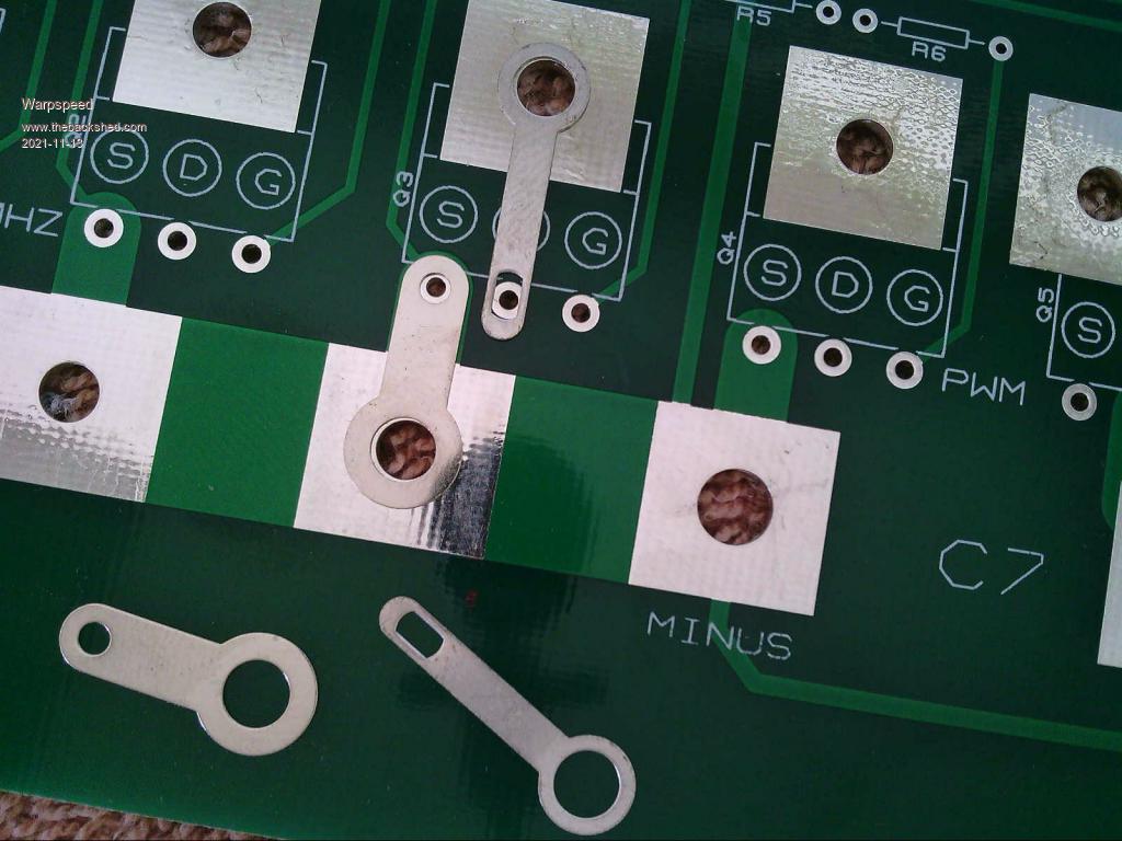

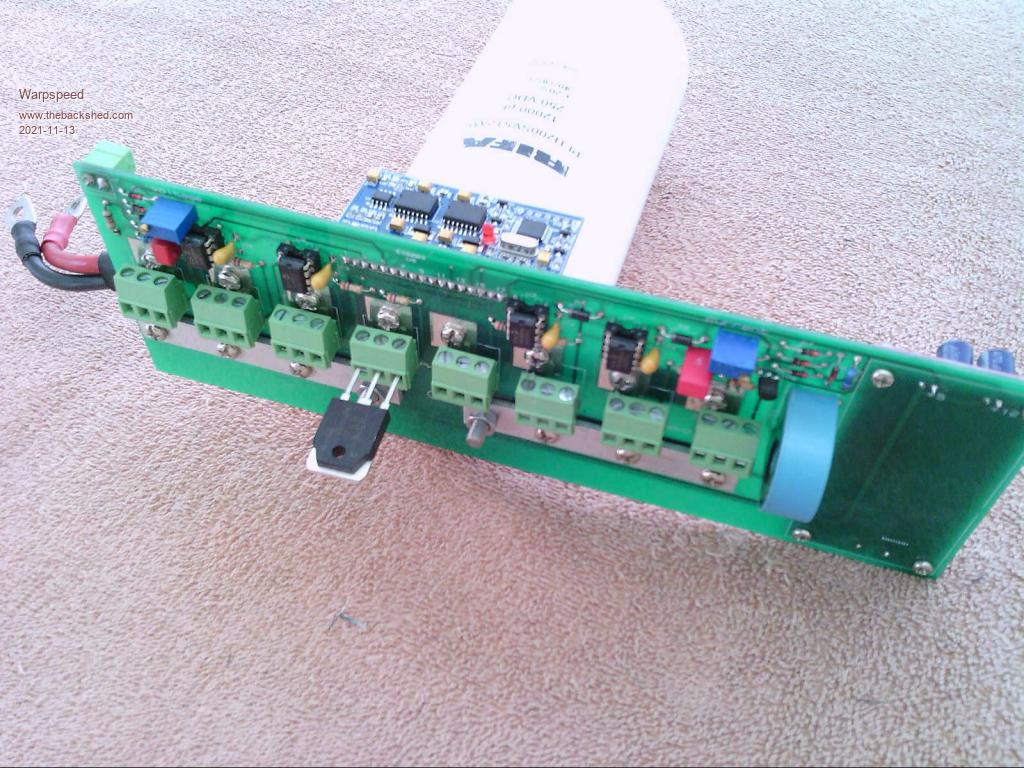

Posted: 09:06pm 12 Nov 2021

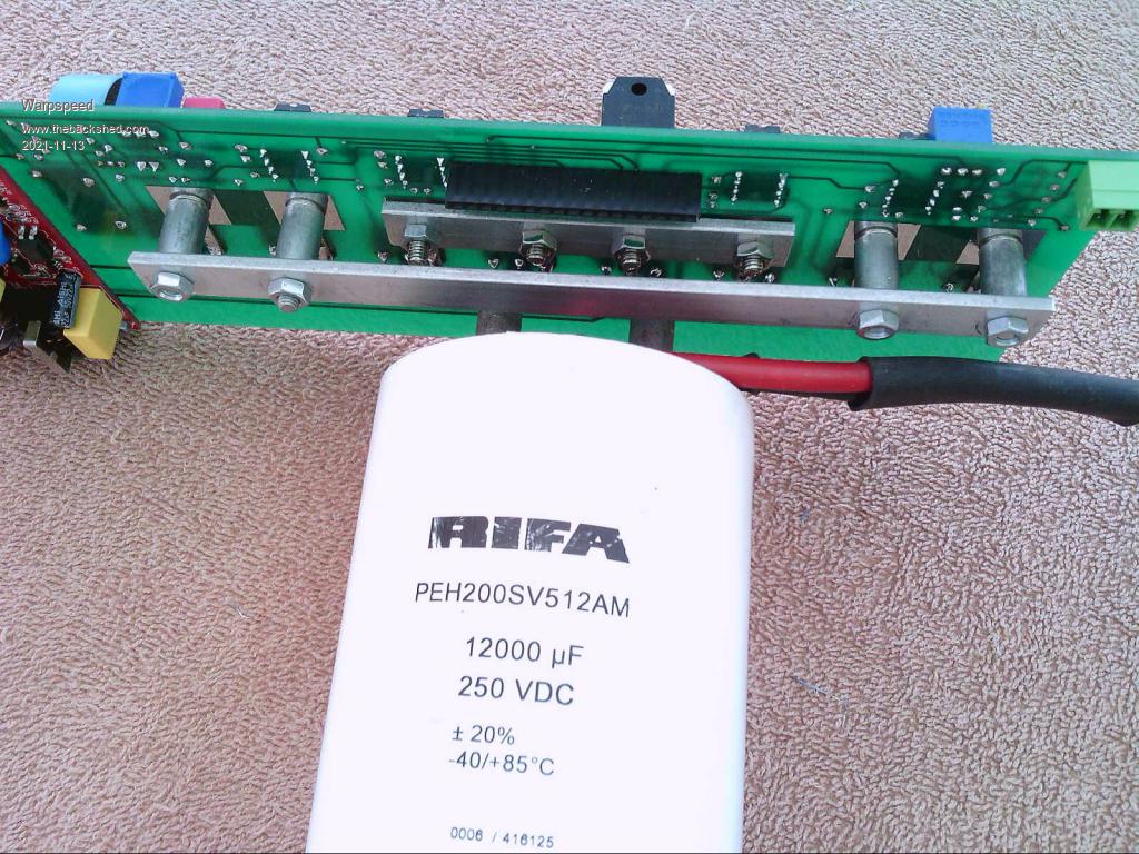

One simple way to really beef up PCB tracks to withstand a very high fault current is to use solder lugs to bolt to a copper or aluminium busbar.
Its also possible to stack two lugs for even higher current.
While a track may carry the design current easily enough, if something does go bang, a momentary fault current multiples higher can curl up your tracks in an instant.
Its possible to put together a mechanical board layout that can survive any number of really serious blow ups (and repairs) with zero damage to the board.
This is the ac bus side of a high voltage PWM bridge inverter.
And this is the dc bus side.
A really big amp solar controller would require a much simpler layout.

Great piece of design there Warp, clean and elegant layout.
Unfortunately will not pursuing this design any further; decided high current PWM is not the best for batteries and creates a lot of RF hash and noise. MPPT buck topology is better in all respects where high power is required; output current is much easier controlled and voltage ripple minimal.
That said I have a small PWM 20-30 amp max controller using the PI PICO CPU module for low power situations and will be releasing the design soon, followed by a 3 Phase mppt design again using the PICO making use of its high speed PIO to generate the 3 phases running at 100 Khz with 2048 bit pwm resolution.
Mike
Posted: 02:19am 13 Nov 2021
Anyhow Mike, I thought this might give others here some ideas for laying out a survivable and easily repairable high current PCB design.

Posted: 02:34am 13 Nov 2021
Certainly the Alloy bars can carry huge amounts of current compared to the PCB tracks and are very cost effective and easier to purchase compared to copper bars; how does it go on using them over time, as the surface oxidation that forms is an insulator.
Guess if the bars are polished up and a thin film of jointing compound used prior to clamping up, then all air is excluded and oxidation under the joint doesn't occur.
I have seen alloy bars used in switchboards, but they were all nickel plated.
