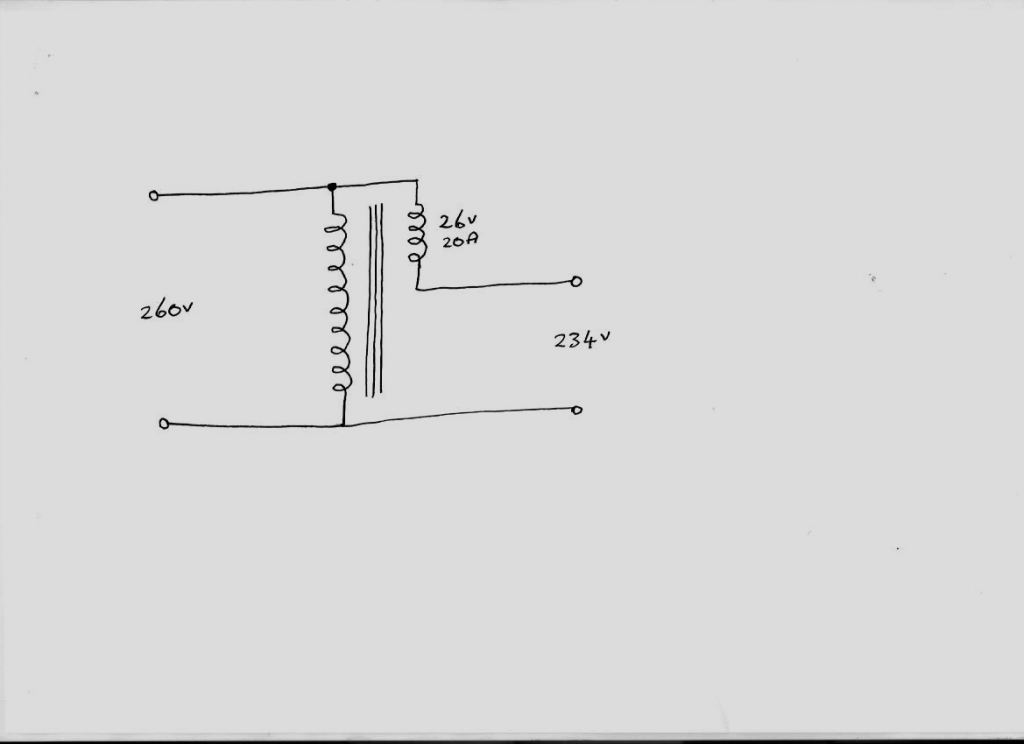

Mark's question raises an interesting possibility.
It should be possible to fit a transformer to the incoming grid supply to lower the voltage. If this is done with a "buck" transformer, a small transformer can transmit a much higher power level.
For instance, a 500Va transformer would drop the voltage by ten percent while transmitting 5Kw.

Tony You have lost me with what I can see is the simplest Circuit Imaginable.
I'm clearly missing something here.
Would this setup have a transformer on the AC and the DC side from the panels?

Posted: 01:22am 07 Aug 2019
O/k Dave.
Suppose your mains voltage is 262 volts, and you want to drop that down to say 250v.
You find a transformer that has a 12v secondary winding on it.
You then connect the high current secondary in SERIES with one side of the incoming 262v on the primary.
Depending which way around the secondary is connected, that 12v is either going to add to the 262v or subtract from the 262v.
Now the really nice thing about this, is that if the secondary is rated to carry 10 amps, you can draw ten amps from the whole thing.
So in this example if the transformer had a 12v 10 amp secondary, it will convert 262 volts to 250 volts at up to the full ten amps.
If you have a few big trannies with output voltages between about 12v and 24v, give it a try
Posted: 01:26am 07 Aug 2019
Connect this between your grid tie inverter and where it plugs into the mains.
The grid tie inverter will always see a voltage less than is on the mains, regardless of which way power is flowing.
Davo99
Joined: 03/06/2019
Posts: 1586
Posted: 11:53am 07 Aug 2019
Geez this makes me feel dumb.
Let me see if I have got it right in my head....
One side of AC goes to a secondary ( low) side. Other low side goes to the inverter.
Other AC side goes straight to inverter with the AC side of the transformer tapped in.
Is that correct? Your diagram doesn't have the dot / circle on the straight through AC side but I assume that's what you meant as it couldn't be unconnected?

Posted: 09:13pm 07 Aug 2019
A bit of experimentation with a multimeter should tell you which way around the secondary needs to be connected.
It probably does not need to drop the voltage by much, 12v or 15v might be enough.

  Quote  I believe the max rating for 2.5mm is 28 amps or 6.4Kw. At that rate the voltage drop will be about one volt per metre of cable length, and that can quickly add up.
I thought about 5 KW was the limit for 2.5 But there are a heap of ways of calculating it. It's my limit put it that way.
Voltage rise can add up too and that is why the inverters trip. They can only push so much before the voltage gets too high and they cut out. The voltage is highest at the inverter rather than with load it's farther from the consumption point.
My 3.6 and 4 Kw inverters are less than 10M from the board so again the voltage rise would take them out well before any overload of the wiring they are on seeing neither are capable of more than about 2/3 that rating.
Anyway, I'll have at least 4mm cable run to them in a few weeks so won't have to worry. I'll try for 6 MM to the shed but depends what I can get in the conduit.
In reality I don't think I'm going to gain much if anything with heavier cable. I don't think it's cable size that's the problem now, it's the voltage that's high here even at 3am.
