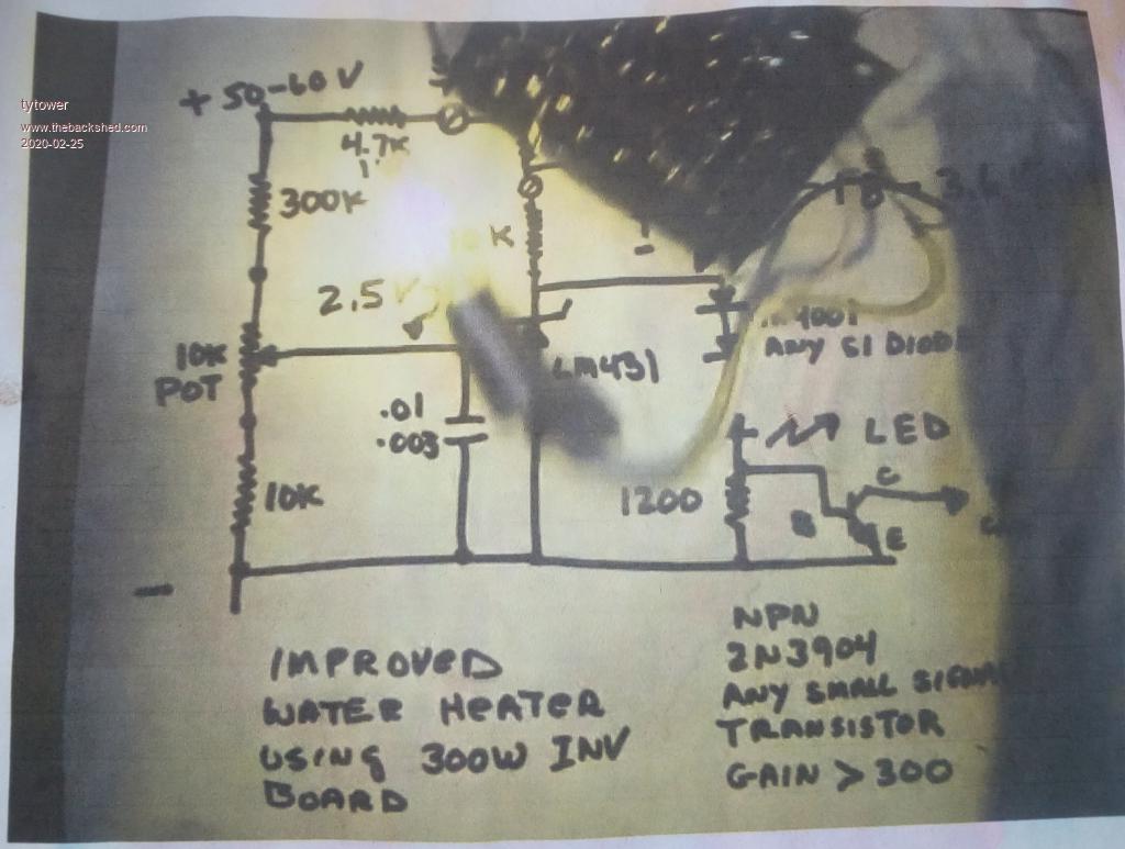

Have seen the Youtube videos of a guy called "Opera"?
He's heating hot water direct from solar panels he claims but I have tried following what he's doing and he has made it very confusing. Changing inverter boards and supercaps etc.His pictures are poorly lighted casting shadows that look like wires and his circuits are incomplete . Theres no big overview to start you in the right direction just a lot of isolated detail.
Ive got one going to the point of getting a voltage out of the board but its damn hard to work out where to connect the ins and outs .
The idea is he's using an "Inverter " board you buy on ebay or Ali  for about $3 . He makes modifications to that board to produce a PWM output . Then supposedly connected to a bank of supercaps he drives a 110V heater element direct.
The circuit uses a TL431 adjustable zener to set a point at which the unit turns on supply to the heater . Then when your batteries get close to full it turns the power to the hot water heater ON until the battery voltage drops again and it switches OFF and resumes charging the batteries .
I know this is the ideal system people have been chasing to absorb the wasted power after the battery is charged. I have been watching all his videos and still cant decide if hes pulling our legs or if this should actually work.
I'll put a video link here to his system that I built to try this out . Following closely I find my input is 68 Volts from 2 of 250 watt panels and the output which is supposed to be PWM is only 12 Volts configured the way he describes.I've adjusted the TL431 to suit my input voltage.The LED turns on and off and a 12V bulb lights up correctly.
These inverter boards are supposed to be run through a 12/240V transformer I think so I'm not understanding his claims to be driving a 110 v light. Its only got 12V coming out. I'm working on this so I'll update as I achieve anything .Perhaps I can learn from your comments too.
Video on device I have built

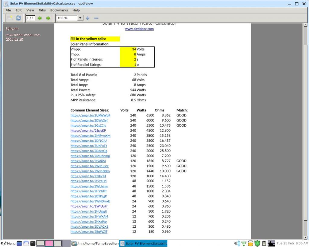

  Gizmo said  I did see a youtube video recently of this guy heating water with solar panels, but he used a 48v element. The 48v heater elements for hot water systems are cheap, like less than $100 for a 1500 watt element, eg https://ringhotwater.com.au/product/48v-1500w-hot-water-element/
All you need are a few 24v solar panels, 3 would be a minimum, and a high current relay, switched from the hot water system thermostat. Its all low voltage, so its easy to install, cheap, and safe. The panels could pump out over 36 volts, so a 48v element is more reliable than a 24v element, it will never burn out.
The problem with these elements as various Youtube videos display is that the resistance of the element seems to stay the same effectively despite the voltage but the current stays the same too. Ohm's law aside I am trying to understand this too and one guy DavidPoz has put together an excel spreadsheet of suitable elements for the system you have .

The resistance is obviously going to change with element temperature, and that depends on the type of element construction and thermal coupling into the water, and how much power you feed into it.
Only way to know for sure is to do some actual real world testing with whatever elements you have.
Trying to efficiently match the highly variable output of solar panels to any heating element directly, is not going to be possible.
You are going to need some kind of variable duty cycle controller.

Nah. -Follow the links for an understanding of whats involved. First get the element most probably suited to your MPPT voltage point . Then set up the PWM board to put out at your set MPPT point or in effect when the incoming voltage rises past that point because the battery is full. Thats where I am now but my post is looking for someone who might understand the controller I am building a little better than me. Thanks

Hey tytower, its difficult to comment on what you are building without a circuit dia, your video has it covered up.
There have been numerous discussions in the past here about heating HWC element from PV panels and a number of members here myself included have built or played with the idea including postings of full schematics, circuit boards etc.
I'm aware of the "Opera House" design but have never seen a complete schematic, so cannot really comment on its effectiveness, perhaps you can contact him via his channel.

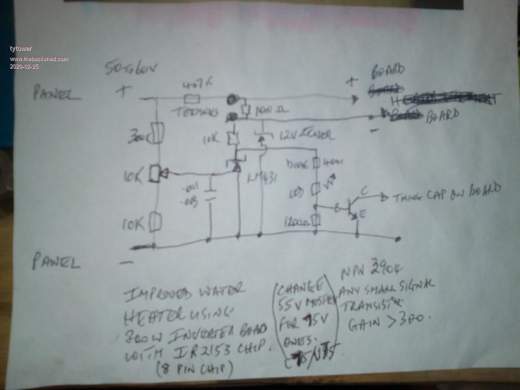

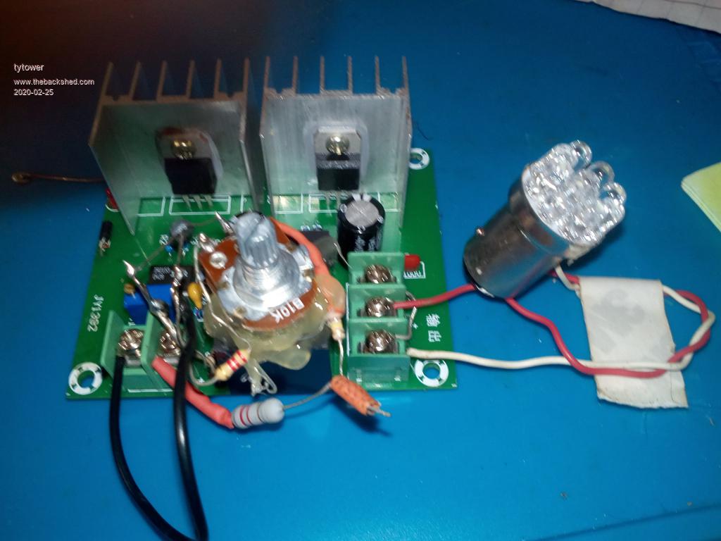

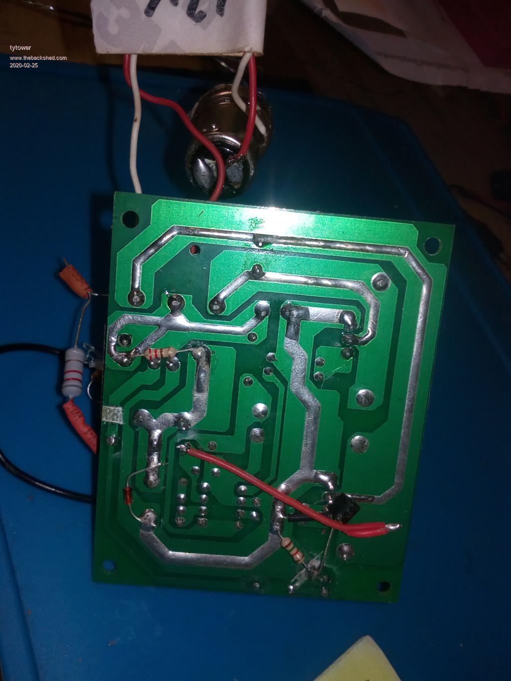

I have the controller based on his Chinese inverter board built and turning the LED on and off and with it the timing capacitor giving a voltage out . He claims to be getting 4 amps out and also another 4 amps from the supercaps . If so 8 amps at 48 Volt or so will do the job admirably.
I have a 48 volt water heater element and I've got 22 unused panels sitting aside the shed waiting for a use . I have another 12 panels feeding the grid and two more running a 100Ah 48 volt Lithium LiFePo4 alloy prismatic bank driving a 2000 watt inverter . (All panels 34Volts and 250 watts so 8 amps available with two in series.)
My batteries are full in a couple of hours each day so I'm looking at putting that excess capacity to work. That's what I was hoping to do here but as you say it seems designed to be confusing because each word he utters is carefully correct but blowed if you can read the circuit diagrams or his pics of the wiring . Here's my circuit I have built .
The LM431 device is easy enough to work out and that is just setting a point at which the timing capacitor on the board will be disengaged. That's his set point . When the battery bank goes below that point the inverter board shuts down and panel voltage goes to the solar controller to feed the batteries.From there though I'm stumped atm .
Where do the supercaps attach . I have the panel attachment points sorted. The caps probably just go across the joined up output but with a 12 Volt zener in there I am only gonna get 12 Volts out I think and that won't run the 48 Volt element. I need 60 to 70 volts coming out.
Anyway let me get the circuit and pics up here and maybe you can comment . I appreciate the effort you have put in to that answer.

8 amps at 48V is less than 400W.  How much water you want to heat? It might warm a regular 250L Tank a few degrees but that's about it. To heat 250L of water from 20oC to 60oC in 6 hours you are going to need 2.5Kw input.
Lets say you don't have a cold tank and start at 50oC, that's going to give you a heating power requirement of about a Kw.
As I said, 400W is basicaly useless. I doubt that would even make up the difference between your winter and summer water mains temp difference.

  Quote   That's what I was hoping to do here but as you say it seems designed to be confusing because each word he utters is carefully correct but blowed if you can read the circuit diagrams or his pics of the wiring .
As I said, I believe what he really wants is people asking for his help so he can be passive aggressive and belligerent and make out he is superior.
That is about the limit of my pathetic knowledge on this. I used some snippets of what he is doing and found my own way because that was easier than trying to understand WTF he was doing and describing.
Yeh realise this . It will run in a system that pumps water through a half inch black plastic coil on the roof . The power is for the element but also for the small circulation pump.The other consideration is that putting a transformer on the inverter board output as its meant to be used with pulses out either side of a center tapped transformer would produce 240 Volts and I'm toying with the idea of trying that on a 240 v heater element simply to reduce losses through doing the same via my battery bank and inverter set up . Not much cost to get a transformer for 400Watts.?

I wondered what you were referring to ,my circuit or another?
  Quote  Unfortunately, I think you have already pissed off the people here that could help you with your previous arrogant replies on the design you are working on.
Yes maybe, but I wasn't getting anywhere until you came in . Incredibly frustrating when you seek answers from smart people and get ramblings from others . No matter how you express yourself someone is always going to dislike it . I have learned to just tell them to piss off and usually their contribution is worthless anyway. Its always pleasantly surprising when someone who actually knows what they are talking about replies.If you think I am arrogant why? Because I tell them to piss off ? Is that arrogance? I think not. The internet is plagued with them ,they age,stop doing things themselves,sit in a chair  and start telling others what to do . Not discussing stuff but telling them what to do . It is a way of communicating for them even though they are sedentiary. Just a waste of talent really . If the admin said "look just confine your posts to something that contributes to the thread , that could all change .
That is about the limit of my pathetic knowledge on this. I used some snippets of what he is doing and found my own way because that was easier than trying to understand WTF he was doing and describing. You are belittling yourself and it does not suit you.nor does it fit with what you post.You are trying t help ...I think.So what parts of his production are you using ?
