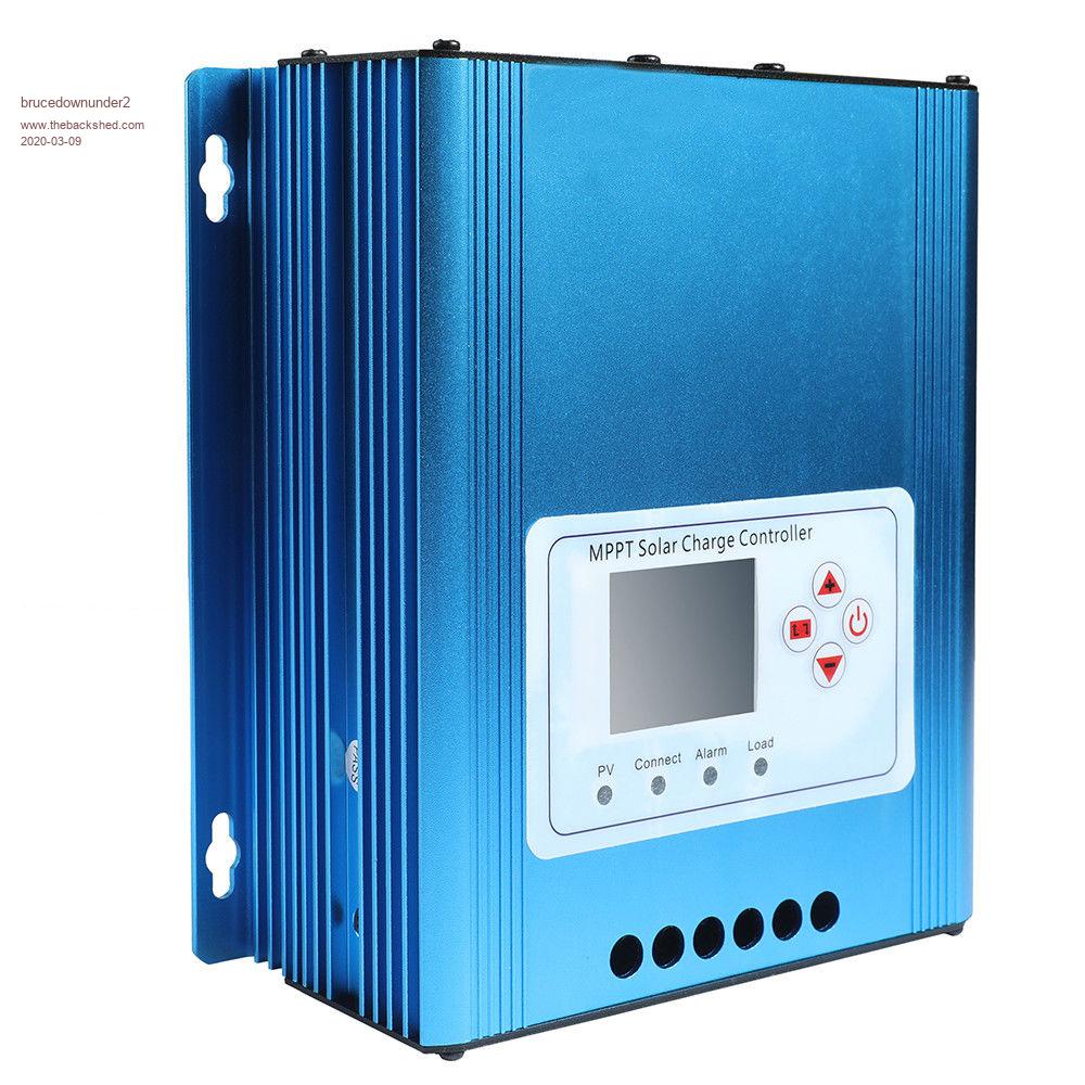

I've narrowed my choice of solar controller down to two.
They are the lower budget cost ones on the market-around $200 . most of the more expensive ones are upwards of $250.  My reason ,apart from my Scottish background,lol, . I am playing around with this as a hobby and my power savings are not very important.  I have the type of solar panels (second hand, almost free) but they are 50 volts open circuit and because I have a 48 volt battery bank ,then these panels each pair will be in series, So that adds to approx 90-100 volts open circuit . Only the MPPT 48 volt controllers I've seen will handle this(correct me if I'm wrong).
So, has anybody out there got these controllers in use and what do you think of them?.
Blue box type controller on e-bay
Red and black box type controller on e-bay
Sorry for the pics, I cannot attach them for the life of me, so I've described them on e-bay (solar controllers 48 volt MPPT) if you are kind enough to bother looking at them for me, sorry.

I'm curious what people have to say about this. I was thinking about getting a 60A makeskyblue controller.

Posted: 02:07am 09 Mar 2020
This is the "Blue" one .

Ok, Thought it best to add a little bit here.
My old MPPT Charge controller (3 of them) is a  PCM60X getting too expensive now.
Now I have been looking at these 2 Charge controllers with interest.
The Blue one as above,Blue one
CPE series controller. not sue if a Wifi dongle is available for it.
Seems to be strong looking unit.
And the red one
eSmart3 series is third generation of eSmart mppt controller,
Reading about the red MPPT CC it has a few things I was interested in, mostly the ability to setup customised battery setting's (all MPPT's should have this) it was not available when I wanted it years ago.
And they  the ability to connect to a computer via a Cable RS485, usb and Wifi dongle, SOLD SEPARATELY, unfortunately........would have been nice to have that in the box.
What is this RS485 anyway? Cable and protocol?
My old PCM60X has RS232.
Now has anyone had any experience with the blue one or the red one? I believe its called esmart.
They are both very similar units.
My apologies if I'v Stuffed something up, just difficult comparing these.
Gee that address was long.
Cheers Aaron

RS485 is similar in function to RS232, but it has networking functions included so you can connect multiple units on a single bus cable.

I'm in the same boat, looking at a 48v MPPT to replace my home made solar controller. The MPPT's are so cheap now.
I was looking at this one Link , same price range. I did read a review where it caught on fire.
I think these cheap MPPT's are probably well designed, but not so well assembled, so it would pay to pull it apart, go over any potential dry joints, check the heat sinks are tight, and look for anything else suspect.

  Gizmo said  I'm in the same boat, looking at a 48v MPPT to replace my home made solar controller. The MPPT's are so cheap now.
I had one of those, it lasted two days, even Warpspeed couldn't fix it. The terminals are bloody tiny as well, you're right though, production is hit and miss.

I had a generation 2 version of the esmart on a 12 volt Lifepo4 setup, it was frustratingly hopeless in that its mppt PV algorithm would sometimes track down to the battery voltage value when sun went behind a cloud, and it would bloody well stay there all day outputting bugger all current even if the sun came out full for the remainder of the day. The only way to fix was turn it off and on again, Threw it in the bin, it was rubbish. Perhaps they have figured out how to write better software now in ver 3!!.
Can only say good things about the PCM60X, have three and performed faultlessly for 3 years, wouldn't like to fix it though, that's why I'm designing my own.
Mike
Edited 2020-04-10 07:18 by Solar Mike
Posted: 09:38pm 09 Apr 2020
I bought a 100v 30 amp Make Sky Blue controller as a backup to my own controller after seeing Marks dead unit.
Mark was dead unlucky, his crapped out after only two days. There is a very small transformer and a switching power supply that generates multiple isolated dc supply voltages. One of the 12v supplies that supplies isolated gate drive power had failed.
The transformer was dipped in transformer varnish and baked into a solid lump. Impossible to dismantle or repair its so tiny. So the whole thing was unrepairable.
That transformer and the microcontroller are the only two very special parts that cannot be obtained or replaced with a substitute part.  Just about anything else could be repaired somehow, unless the whole thing turns into a total charred mess.
Anyhow, I bought one and it works fine, and is still working very well. The whole thing is built inside a very light gauge aluminum box, and even at low power the internal cooling fan was always going full blast. That is its only real limitation, at full grunt its going to get really hot and probably fail fairly soon because there is nowhere for the heat to go.
So what I did was bolt the whole aluminium box onto a massive "Inspire" heatsink and hang it on the wall. The heatsink sucks the heat right out and now the fan never comes on, and it runs cool to the touch even when running flat out.
After a bit of help in the heatsink department, these work very well, and I would certainly buy another if I ever get around to installing more panels..
