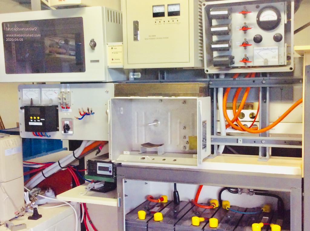

Years ago I dismantled an INSPIRE inverter to rewind the Toridial transformer .
The case is now going to be home to my latest project,a back shed home built inverter.
Aaron ,our mate from this forum ,is the brains ,I,m the metal basher,come roustabout.
The case is solid,stainless and lovely finish. So ,I,m working on positioning a fan hole and a couple other stagetic positions for input,output cables.
The cover ,I might put on hinges, and fix a couple of meters ,switches,breakers, etc.

With those cases, they are a bugger to cut fan holes on, jigsaw blades get destroyed pretty quick and it takes forever.
The easiest way I found was to cut a stop sign shape (octagon) with a fine disc on a angle grinder, just make it a tad smaller than the fan.

Back to the cutting holes,, I agree with you ,that stainless really blunts the old hole saws ,and they are not cheap.
I thought of cutting three ,say, 30mm holes within a circle ,but leave ,say, a 5mm between them for a bit of strength .
Cover them with expanded Al mesh and bolt the fan unit under that.
I'd put a temp and rpm adjuster on the front cover to set it at the best temp and rpm. for noise,Etc.

Plasma Cutters are great for doing hard metals like stainless and thick metals tool. Cut a bit of 3/4" steel with it the other day. Wouldn't say it went through it like Butter as it's only a little cutter and I couldn't couldn't turn it up too high with out popping a breaker ( Can when it's sunny because I have a solar inverter on the same circuit nearby0 But it's certainly easier than using a grinder.
I have cut Aluminium, copper and ally with it too.
Even if you just rough the holes and finish them with a drill bit in the press it makes things much quicker and easier.

When you cut stainless go very lightly at first so it warms up then big pressure and no lubricant. That cools it.
