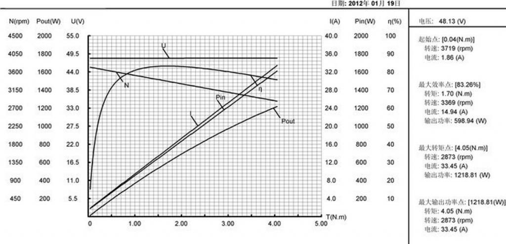

Fathers neighbor has his offgrid solar power system up and running finally.
He is Back feeding a power circuit and was excited as all get out when I showed him yesterday if he put the fuses back in the whole house would power up. He was wiring the house internally with flat cable over the door arches and along the Skirting boards ( Face palm!!)
He has no generator however and I was wondering how one of these 48 V DC motors would go if engine Driven?
Has anyone used one as a small Battery charging Genny and if so,how much Power would one expect from one in this sort of Config?
I see they are available in 1000W and 1600w.  Would they do 50% output as a generator or more and would they run enough voltage for battery charging with out going too far over speed?

O/k thanks for that, a Google search turned up some numbers:
https://www.motiondynamics.com.au/unite-my1020-1000w-3000-rpm-48v-dc-motor.html
On the extreme right column there are some figures for speed versus load at 48.13 volts.
No load (at 48.13v) 3,719 rpm at 1.86 amps which would be friction and windage losses.
Absolutely flat out, 2,873 rpm at 33.45 amps.
1,218 watts out, watts in (33.45 amps x 48.13 volts) equals 1,610 watt.
Drop in rpm under full load (3,719rpm minus 2,873rpm0 equals 846rpm.
Internal power dissipation (1,610 watts minus 1,218watts) equals 392 watts.
That is rather a lot for something that physical size.
Now if run as a generator, with no load on the output, it would need to turn at 3,719 rpm  to generate 48.13 volts, the same as when run as a motor.
At full load it would need to be turned 846rpm faster to maintain the same 48.13 volts.
So full power rpm (3,719rpm plus 846rpm) equals 4,565 rpm.
The big problem though, is power loss and 392 watts of internal heat generation. You could not run full sustained power for any length of time on a bike, it would kill the battery.
On the other hand, when used as a generator, continuous operation at some(?) useful power level would be expected, and that would depend on safe temperature rise.
It does not appear to have a fan or fins or any real method of effective air cooling, so I would expect it to overheat very quickly when used as a continuously running generator, and I suspect its life might be quite short in that application, even if run at very diminished power.
My gut feeling tells me this is going to be a bit of a disappointment as a generator, it would certainly produce the power, but only for a very brief bursts, before it quickly overheated and eventually dies.

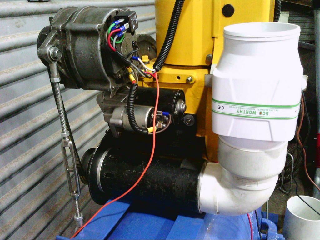

A lot of these light duty motors are not rated for continuous flat out use. Things like treadmill motors and bicycle motors can work well, but not for hours on end at full rated power.
Now a dc motor can be run as a generator at a reduced voltage and speed, which may be more realistic for a reliable generator anyway.
For instance, a 180 volt treadmill motor might say 4,200 rpm on the rating plate.
If run at 48 volts that would be 48/180 x 4,200 = 1,120 rpm It would probably make a rather nice 48v dc charger if run up to about roughly 1,500 rpm under load, which is a very practical speed.
The serious overheating problem still exists, but if external forced air cooling is used with something huge like a bilge blower, continuous full rated current, or even a tad more might be possible.
I am running a single treadmill motor at about 3,000 rpm and getting 1Kw (100v & 10 amps) cooled with a 12v bilge blower.
As my battery is only 50Ah anyway, that is heaps on a cloudy day. No need to fully charge the battery, just enough to stop it from reaching minimum voltage is all you really need. Let the sun do the hard work.
Always possible to couple up more than one treadmill generator to the same engine and use a single bilge blower feeding through some 100mm plastic pipe....
