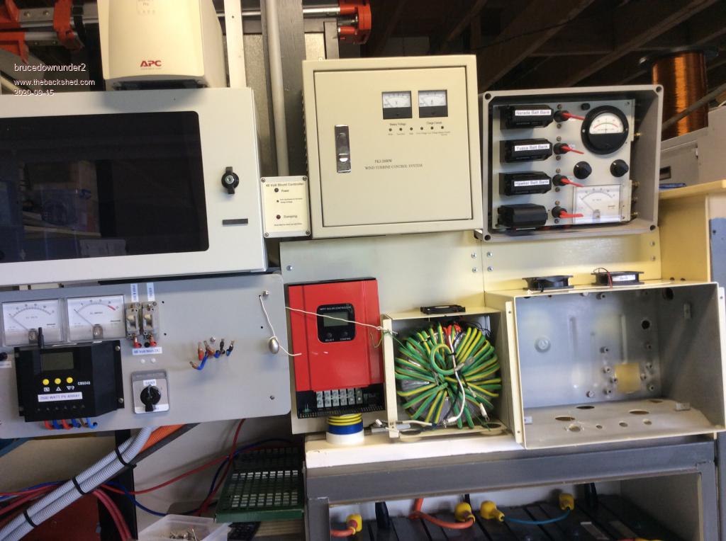

I've always wanted to minimise the number of cables running around a enclosure ,so.
Heres the question-   Three different controllers, two are the same make and model, one is  my latest  MPPT .
Can I common the positive output from the "load ports". from these two common controllers .( all my negative cables are commoned onto a brass bar.) (saves cables and space).
or will the two common positive 's interfere with each controller and let the magic smoke out ????.   ( or can I insert a blocking Diode in both positive lines ??? )
Is there a good link I can access to obtain controller working information   -I've read a lot , but not yet satisfied.

  brucedownunder2 said
Can I common the positive output from the "load ports". from these two common controllers .( all my negative cables are commoned onto a brass bar.) (saves cables and space).... Bruce
By "Load Ports" do you mean +ve battery connection outputs or the controlled load switch output some controllers have; that gets turned off on low battery volts.
If its the main battery output connection, I would always run a separate CCB and cable connection from each controller back to the battery terminal. This prevents cable voltage drops affecting the other controller voltage sensing.
If the controlled "Load" connection, then I wouldn't combine them directly, if you want to use the load disconnection facility then take that output to a relay and series up the contacts with others, so any one could disable the output.

 I'm attaching a photo of what I'm trying to describe.
 I've two of those black coloured controllers fitted , both 48 volts/ 60 amps .
Just trying to electrically match them ,so either will be able to supply a light load from existing panels., - without interferring with each other.
The red unit is MPPT and will be for a seperate solar array.
The battery bank will be for primary supply -thats another story.
Bruce
