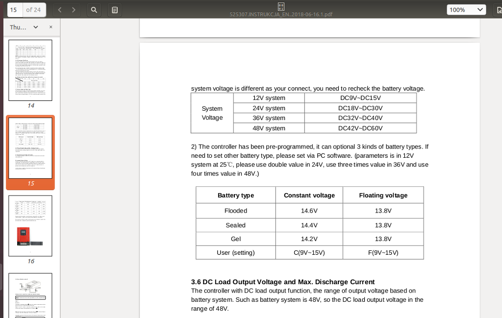

I think it is an eSmart3 MPPT 60a.
And this might be the Manual for it.
Looks like https didn't work.
I will read the manual, see whats not.

It could be on the constant voltage stage  CV. 14.6 X 4 is 58.4v
You could try "user setting" and set it to what you want.
Take a photo of it working, perhaps we can see what is happening.

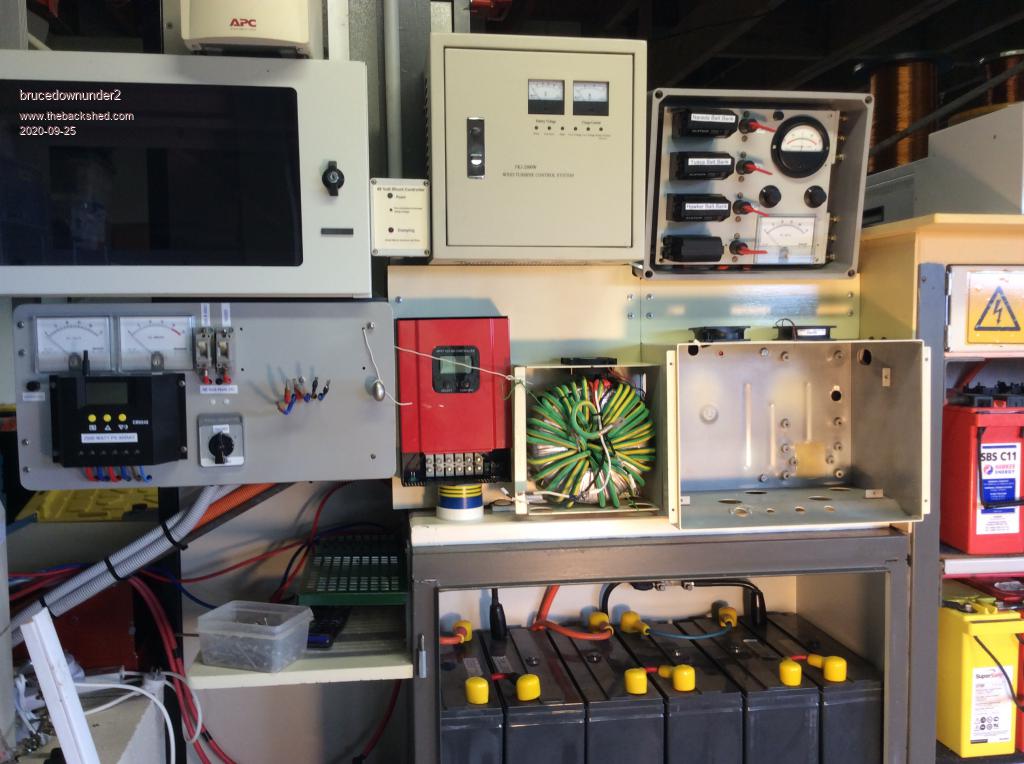

This is a pic of the red/black MPPT controller .  Aaron has suggested that a previous owner may have had it set for a higher voltage (his type of batteries) . -but I'm sort of thinking I've bought someone else's problem ??.
I'm waiting for full sun and I will try to re-configure the menu for my lower voltage batteries. I'v read the instructions ,but @ 76 I'm not smart in that dept. anymore.lol.
don't get old.
another point, does anybody know of a tech or company near Gold Coast ,or anywhere if I get desperate that can repair or suggest a fix...

Ok then,
If the voltage in and out is the same, and the controller Doesn't indicate any charging, it seems like its just going strait through.
So perhaps a shorted fet, or not switching and not doing its MPPT thing.
Gizmo posted this link http://skagmo.com/page.php?p=documents%2F04_esmart3_review earlier and there is a schematic as well.

There is good news, .   I spent many nights thinking what the hell could be upsetting this controller.
So, I came into the workshop and pulled Everything connected to it off..
BINGO,   An hour later, it,s working !!!!
What did I do ,differently, smart arse me thought I could cut the bulk of cables leading from the components to the individual destinations ,,,,,,and take ALL the negative conductors to a buss bar ,then only one Neg conductor into the back of the enclosure..
Of course, I forgot that this does not apply to components that require their own individual connections..
Thank you, and I,m sorry to have put you through something that was my mistake.
