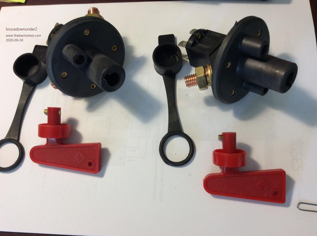

I made up a panel with cartridge type 120v fuses plus those el,Cheapo battery switches from e-bay ..
Never had a problem ,though someone on this forum had welded contacts with his.
I make sure the load is low at the time of switching or pull the fuse.
This is the back ,the cable is divided because its 50mm and those entry holes are for 20mm or so .
Oh, forgot --- those connections on the back of the switches are contacts for a relay or other external device that could be activated when switching the red key.on or off.
