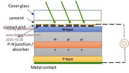

noneyabussiness
Joined: 31/07/2017
Posts: 527
Posted: 10:03pm 25 Oct 2020
Mine is zero, tested it early on in system as i was " told " the same thing ....
As the panels are silicone junctions just like a diode, current will generally only flow in one direction, less " leakage " again like any diode. Obviously the voltage tolerance is much lower than a standard silicone diode ,where i personally believe this " rule " came from, people putting too much voltage on smaller panels and they overcoming the voltage ceiling and " backfeeding". Of course there are exceptions and differences.
Attached is a pic of the makeup of a modern solar cell.
I have been wrong before, however from practical experience it doesn't matter. If you want to prove it to yourself,  a 12v battery (or any battery with sufficient voltage) a multimeter on current setting and some wire, in the shade of course.
I think it works !!
mab1
Joined: 10/02/2015
Posts: 290
Posted: 06:35pm 26 Oct 2020
interesting that yours is zero - I was a bit surprised that mine's so high TBH - it is possible that the damp has gotten into one of the junctions as i live in a very wet climate - i'll check that out.
Silicone cells always were basically a diode of course, but I assumed the advice of a need for a diode came from the early days on solar when panels did have significant internal leakage - which is partly why those old panels were poor performers - particularly in low light as the output was generated-current minus leakage-current. One of the main improvements in modern cells is a reduction in internal leakage which means they keep generating at voltage down to low light levels.
Whatever the reason, the simple way to check is to connect the panels to the battery it's going to be charging anyway, and when it's dark, open the circuit (at a fuse/ circuit breaker if you don't have a diode like me) and put an ammeter across the break: if the current's negligible, no worries; if it's significant, get yourself a diode.
