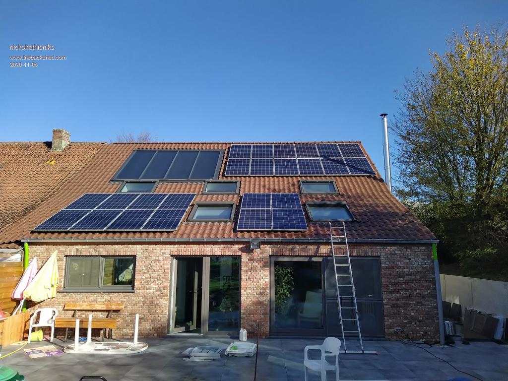

A practical example today @ 11.30:
Pump is running at 5l/min, and in/out is 30/40°C. That's about 3.4kW output.
Outside it is 9°C, clearsky, sun is far from 100% on the panels, you can see at the shading.
A solar panel 280W on the same angle without shading is giving 31V 5A01 --> 155W, 8 panels on the same area would bring me about 1240W.
So you see, the thermal panels are a lot more efficiënt in clear sky, the actual usefull thermal area is 11.1m˛ (Tisun Fi3/4), roof area is 3.01*4.01m.
Offtopic, the group of 4 panels I did yesterday, it took me more than a day to get those installed... Ones my aluminium bars were mounted, I discovered I had 40mm brackets instead of 35mm... So I had to adjust (file,saw,grinding...) them, it took me more than 2h for just that....
Installing solar panels on a roof like ours is a real pain...
I will try to make a new measurement in a few hours.
I think this is a relevant point.
PV is a LOT easier to install than water heating panels.
Muc easier to run a wire than run Plumbing.  Sure it's a one off but there is also the aesthetic factor as well.
I put another 2.5 Kw of Panels on my fathers Shed roof today in about 90 min. Yeah, it's flat tin so pretty easy like that but all I had to do up top was lay the panels. run the cable and push it through the roof overlap.
This was adding on to an existing inverter but even putting on another one would not have taken an hour.  30 Min most likely and it can all be hidden. Doubling existing Panels would require much more time and expense.
Not disputing direct water can be more efficient but just saying there can be more to it. Given the better eating ability of direct at least for low heat applications, seems pool heating is ideal.
