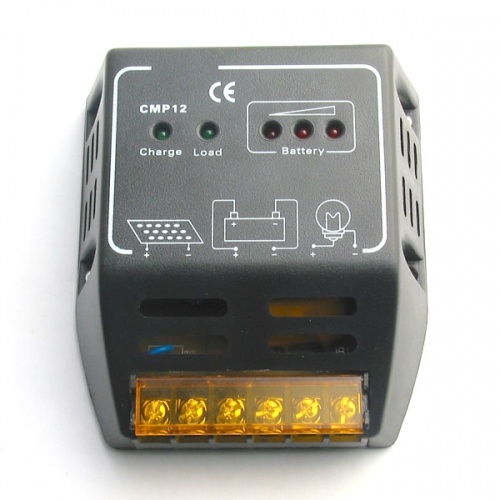

Posted: 04:33am 01 Nov 2008
hi there,
i am having a problem with my connections and i'm not sure what it is. i am sure that someone out there might help.
well to start with i will describe the situation.
as mentioned before i have connected my three solar panels in parallel and connected it to my charge controller.
then i connected two small batteries of 12v 3amps in parallel and connect it to the charge controller. the batteries are new and are fully charged.
electrical wires (possitive and negative)were connected to the load of the charge controller. this wire is more than 15 meters long and it goes downstair where it is connected to my 300 watts 12v power inverter.
here is the problem - when i connect a table lamp of 15 watts to the power inverter, the latter does not light up. infact it keep on flashing. the DC volt coming in is now 13.85v.
i am doing something wrong and i dont know what it is.
just to tell that in the past, i have used one of the two 12v battery to light the AC lamps through the inverter and it worked just fine that is without going through the charge controller.
i have purchase two more solar panels (10w12v) but have not received it yet. will connect them to my existing panels later on.
please advise.
many thanks
asvin.b
AMUN-RA
Joined: 10/03/2007
Posts: 144
Posted: 08:27am 01 Nov 2008
For 12 v shorten the wire run or double the wire then get rid of the inverter and buy some 12v led from ebay
for your needs the inverter is a loss you can't afford
and dont need. with your small batteries and panels leds are the way to go cheap to buy and run and last a long time, hope this helps Mick.

Posted: 07:34am 16 Nov 2008
hi,
i just want to update you guys on m progress. The problem i mentioned earlier, well i manage to solve it and now it is working just fine. the only problem is where to use this power!!!
anyway, my problem was that the wire connecting the solar panels to the charge controller and battery was short since these connections were made near the solar panels (on the roof).
from the charge controller to the inverter there was around 15 meters (inside the house). it was way too long and for some reasons, the DV current was not constance and that why when it was connected to the power inverter and to a lamp (AC), it flicked and beeped.
therefore, i changed the position of the charge controller and batteries. i have moved them inside in my house with my power inverter and bingo, it work. th solar panels are connected by the 15 meters wires to the charge controller, batteries and charge inverter. i am using it to power a 15 watts lamp in my TV room. i guess i can use it to power a few more applicants.
