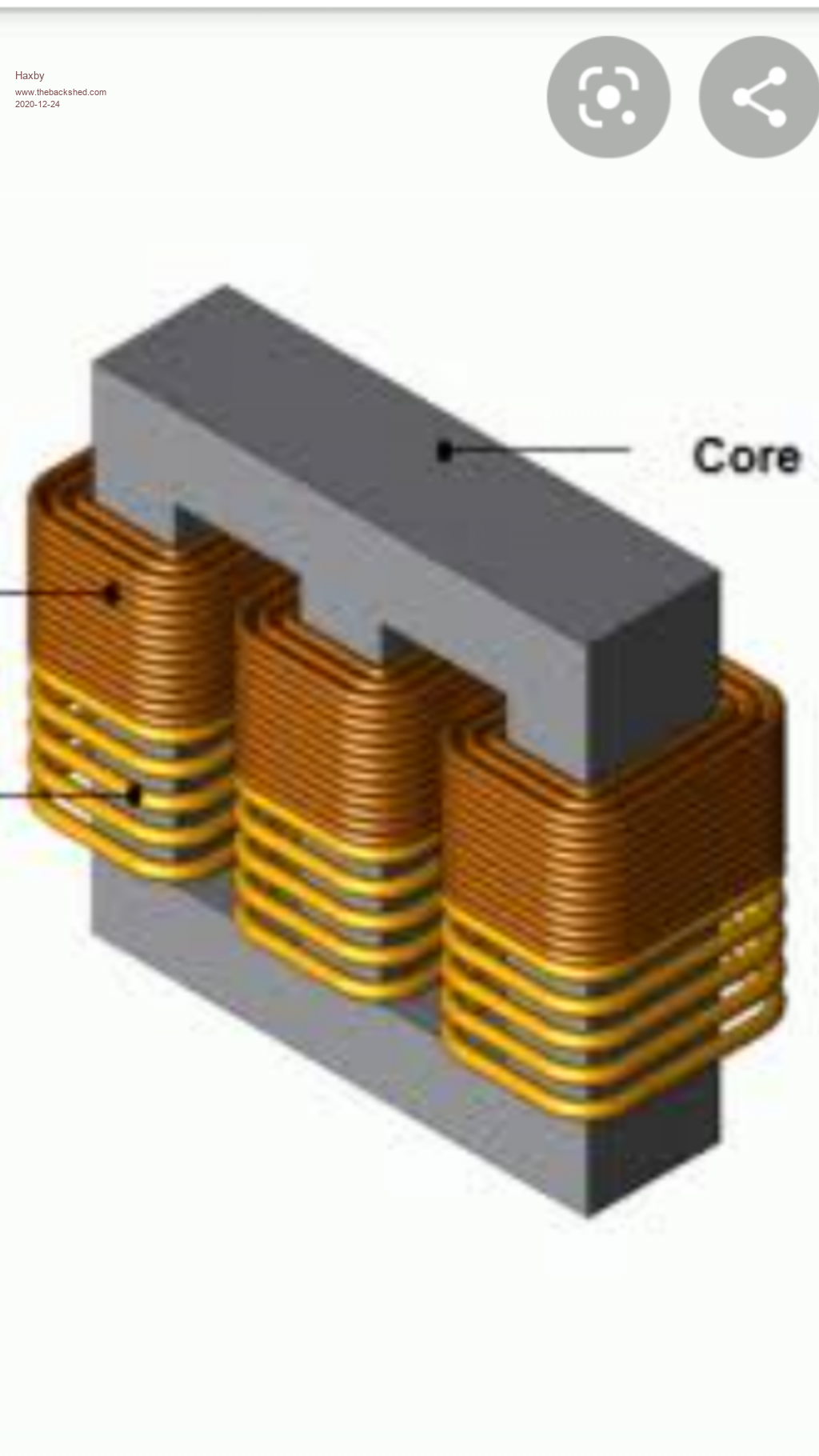

Warpspeed: not to hijack the thread, but since 3 phase transformers are being discussed...... I've often wondered why 3 phase transformers are magnetically coupled between phases. Is it just to conserve core material and aid in manufacture?
I mean, you could have 3 separate transformers doing the same thing right?
Why doesn't the magnetic field of one energised phase induce a current in the other 2 phases? I would have thought that would be a big problem. Obviously it isn't in practice, so I must be missing something.
Posted: 11:42pm 23 Dec 2020
you are quite right.
Three separate transformers would require a lot more core material, more cost and greater bulk.
All three phases have the primaries driven, so the flux finds its own way around the core.
